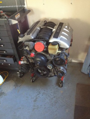

WarlordZ Posted January 28, 2014 Author Share Posted January 28, 2014 It has 100k. But I'm not worried about the miles because I'm going to have a few LS engines on standby. I'm not going to bail. This thing will be done if it's the last thing I do. Quote Link to comment Share on other sites More sharing options...

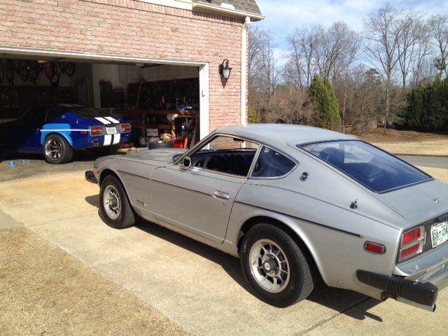

WarlordZ Posted January 28, 2014 Author Share Posted January 28, 2014 Here she is sitting on that sweet engine cradle that RebekahsZ loaned to me. Quote Link to comment Share on other sites More sharing options...

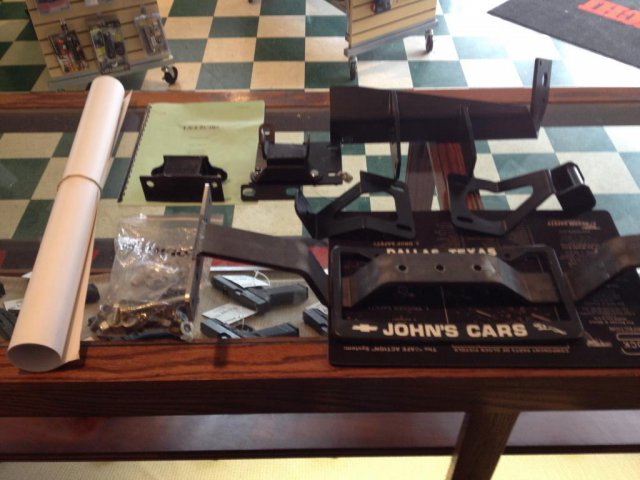

WarlordZ Posted January 28, 2014 Author Share Posted January 28, 2014 I sent the money order last Wednesday and this showed up today. It's coming together. Baby steps. Quote Link to comment Share on other sites More sharing options...

Phantom Posted January 28, 2014 Share Posted January 28, 2014 I sent the money order last Wednesday and this showed up today. It's coming together. Baby steps. Looking at the photo those are some unusual engine mount parts in the background. Quote Link to comment Share on other sites More sharing options...

WarlordZ Posted January 28, 2014 Author Share Posted January 28, 2014 Looking at the photo those are some unusual engine mount parts in the background. Yeah those Glock engine mounts are pretty rare. Quote Link to comment Share on other sites More sharing options...
