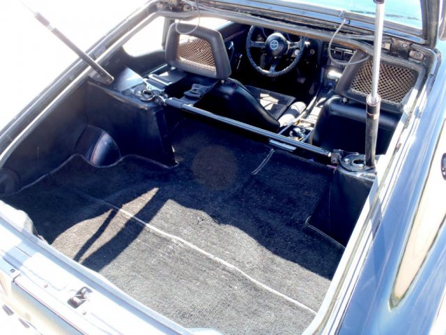

Not to much going on with the Z this week , but I have got some work done on my rear strut bar and am very happy with it so far. All that is left to do is get it all painted up and then put the rest of my car back together.  I also have been doing work on spindle pin replacements via the 5/8 bolt route and I finished that up this week too.
0.900" cold roll steel bar
Getting the 5/8 hole dead center
post-19246-0-96246100-1395436962_thumb.jpg came out good
post-19246-0-34005900-1395436961_thumb.jpg 3/8 rod end with weld bung
post-19246-0-48532200-1395436997_thumb.jpg  fits in the hole good
post-19246-0-38373100-1395437002_thumb.jpg  test fit in Z
post-19246-0-97705100-1395437070_thumb.jpg more test bung welded in place
post-19246-0-16105500-1395437073_thumb.jpg  bung welded in place
post-19246-0-92385800-1395437074_thumb.jpg plates welded
post-19246-0-43706100-1395437076_thumb.jpgbar almost done

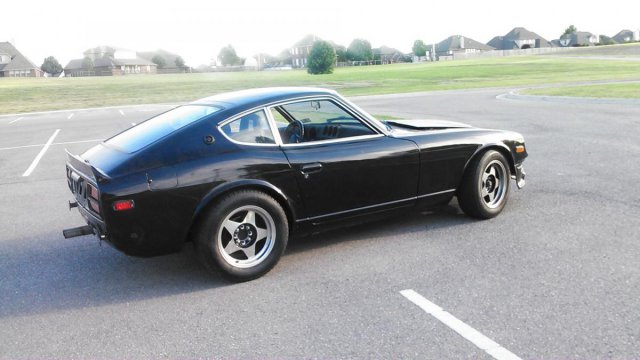

Well I half to say all the hard work and hours of prep and paint and putting on and taking back off and head aches and frustration were all worth it ever single second. There is no felling like climbing in you Z after 10 months down and driving it. now I just need to get the timing set right (( found my distributor was lose and after hard acceleration would did and not want to restart )) and she is good for a bit of summer fun. And I love the way it sits not low but not to low. Also did some work on my radiator over flow set up did not like the way it was run and my cheap over flow can needed some modding so it would not hold pressure and vacuum and cause my lower radiator hose to collapse. I missed this car!
post-19246-0-64523600-1399994694_thumb.jpgpost-19246-0-06483800-1399994696_thumb.jpgpost-19246-0-21284700-1399994701_thumb.jpgpost-19246-0-46085000-1399994702_thumb.jpgpost-19246-0-36405300-1399994704_thumb.jpgpost-19246-0-22045600-1399994706_thumb.jpgpost-19246-0-18606000-1399994708_thumb.jpg

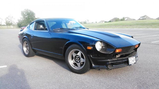

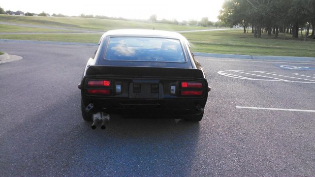

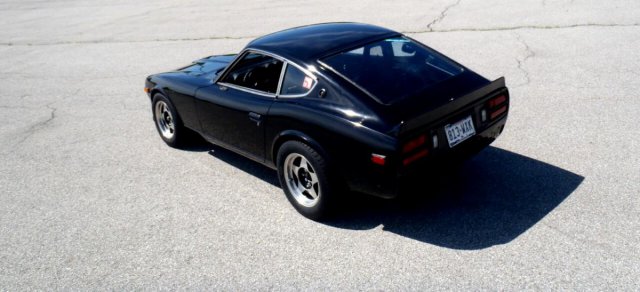

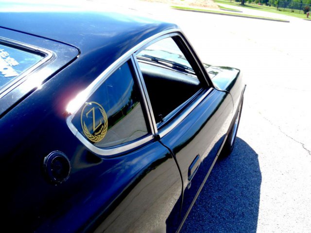

Got some good pics of the Z this weekend after spending some time rubbing compounding and waxing it. Also made it out to a small local car show with one of the guys from OKZCC with his killer 350Z. and I found out I really need to roll my rear fenders I am killing my tires.post-19246-0-29669000-1400508843_thumb.jpgpost-19246-0-40908700-1400508841_thumb.jpgpost-19246-0-30148500-1400508840_thumb.jpgpost-19246-0-25948000-1400508837_thumb.jpgpost-19246-0-40748900-1400508842_thumb.jpgpost-19246-0-05789500-1400508846_thumb.jpg
post-19246-0-93735900-1400509223_thumb.jpg like  the way this one edited up
post-19246-0-58548200-1400508838_thumb.jpgpost-19246-0-28748300-1400508839_thumb.jpgpost-19246-0-70868400-1400508839_thumb.jpgpost-19246-0-02989100-1400508844_thumb.jpg

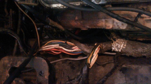

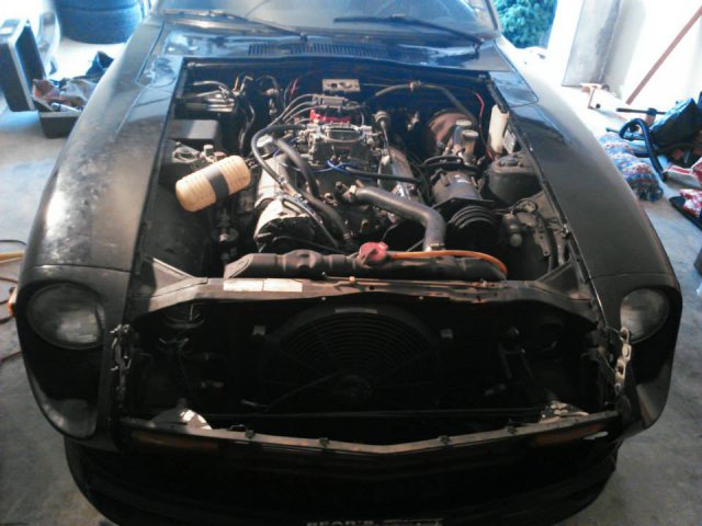

I am starting on the engine bay clean up and this is were it is at as of now.
post-19246-0-41874200-1401905365_thumb.jpg cluttered
post-19246-0-80068300-1401905331_thumb.jpg ratty harness

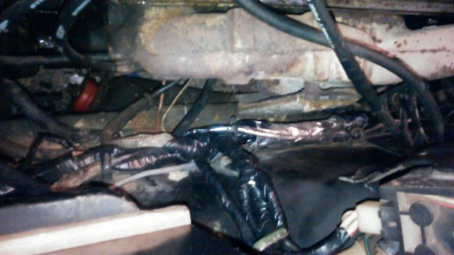

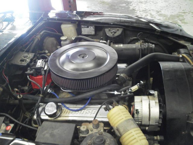

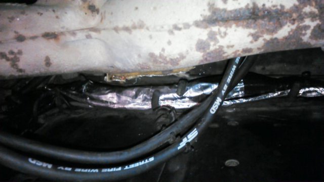

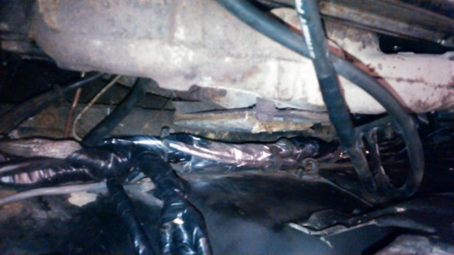

Ok I got some work done last night and so far so good.I started buy removing the A/C that has not worked in along time along with all brackets and the condenser and all piping vac bottle and vac solenoids.Then  striped the harness of all the old heat shielding it had and e-tape. I picked up some of the high temp resistant e-tape we use at my job along with some DEI goodies the aluminium heat reflect  tape along with the slip through heat sleeve. After e-taping every thing in the bay along with re routing some wires I set off to heat shield the harness were it passes by the rams horn manifold. I layed 3 layers of the reflect tape then cut and wrapped the sleeve around it then wrapped that in the reflect tape. Came out looking much better along with painting my brake booster it is looking much better but will be getting some more love soon if the weather lets me.
post-19246-0-57049400-1401991333_thumb.jpg old heat shield and exposed wires
post-19246-0-05089800-1401991336_thumb.jpg striped and e_taped
post-19246-0-87450300-1401991338_thumb.jpg striped and e_taped
post-19246-0-10530700-1401991341_thumb.jpg drivers side minus a/c with cleaned up wires

post-19246-0-97411400-1401991344_thumb.jpg new heat shielding on
post-19246-0-00211700-1401991347_thumb.jpgnew heat shielding on
post-19246-0-71252100-1401991576_thumb.jpg nice gap that was not there to start

evolution of my bay and engine
post-19246-0-65101100-1401992083_thumb.jpg in the beginning
post-19246-0-44661300-1401992084_thumb.jpg just got it to OK
post-19246-0-30461400-1401992085_thumb.jpg new rad and air filter
post-19246-0-49021600-1401992086_thumb.jpg some changes be still cluttered
post-19246-0-13480600-1401992650_thumb.jpg as it is now much better still more change to come
post-19246-0-50441200-1401992653_thumb.jpg phone pics sorry

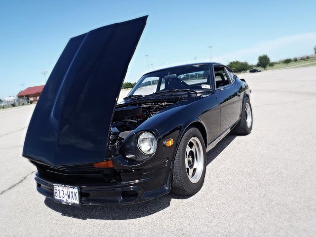

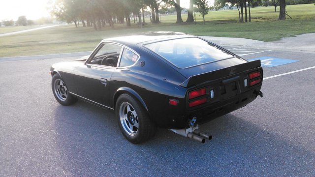

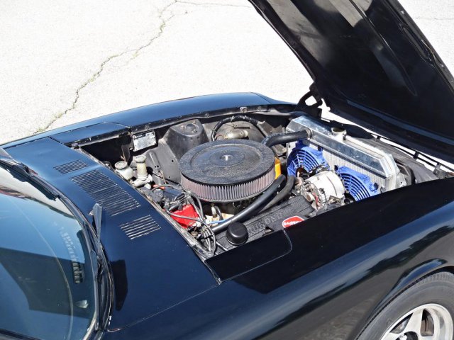

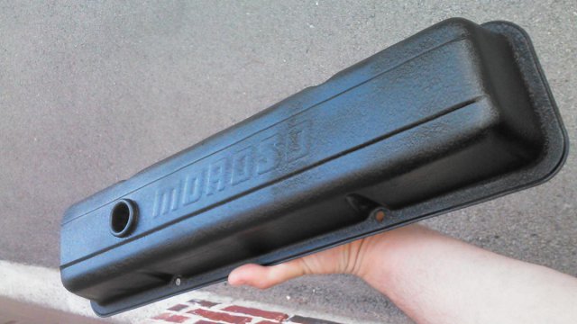

Over the weekend I got the engine bay finished up cleaned and painted the valve covers and pulled the exhaust manifolds and painted them. Along with getting the car all cleaned up for IFO Tulsa. The only draw back of the weekend is IFO got canceled due to weather . But since i had spent a few hours cleaning the car for the event i took some more pics. I am finally ok with popping my hood now. I also got some good interior shots along with a good shot of the rear strut tower brace I made and the drivers seat is faded but fits me perfect got to love old school Recaro . Now its time to save for wheels tires and bigger brakes.
