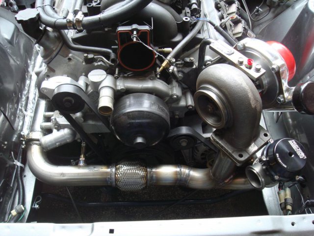

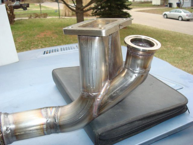

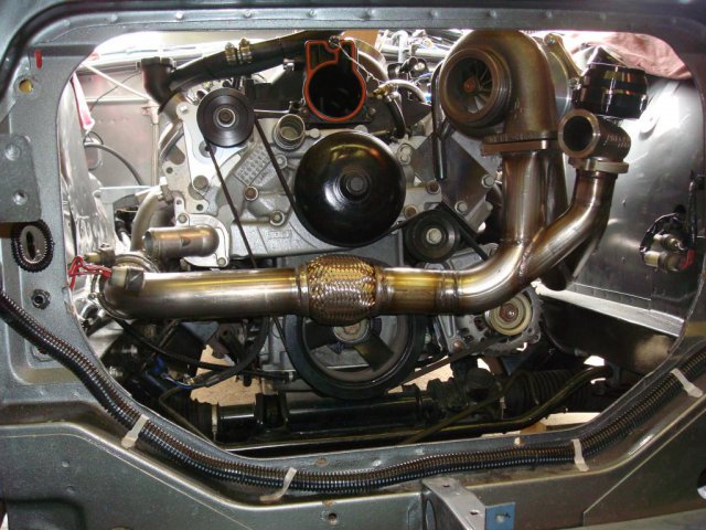

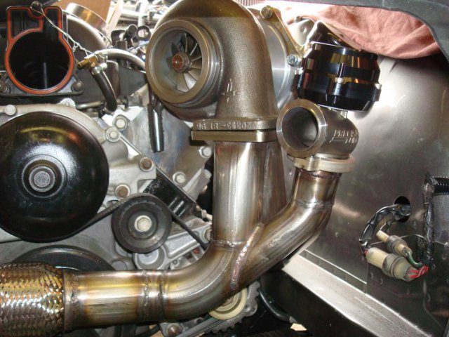

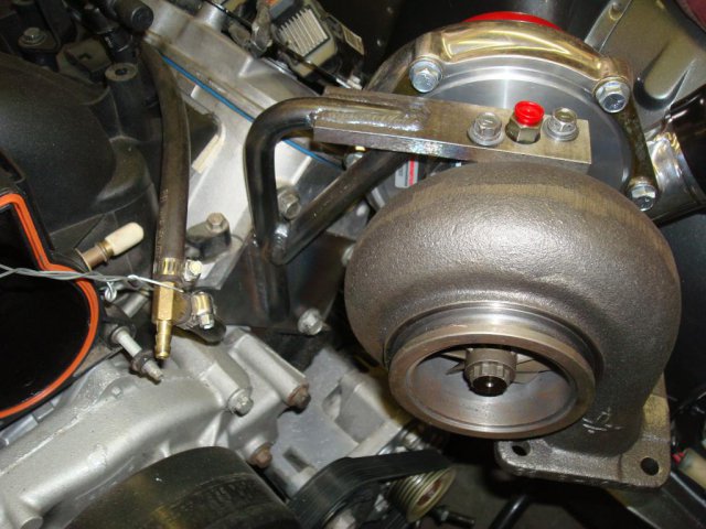

Slow78z Posted March 21, 2014 Author Share Posted March 21, 2014 I've been working here and there on the car the last couple of weeks. Kansas weather bites! One day it will be sunny and 70* outside and the next its 30* and snowing. Anyways, enough whinning and on to the good stuff. I needed the turbo to set a little closer to the engine so I made a different turbo mount that is probably 5 time more solid. I'm almost done with the crossover as well. Just need to finish up the wastgate merge and tig it onto the crossover. The welds don't look the best but in my defense it's my first time welding stainless tubing. lol. The welds look nicer on the inside then they do on the outside because of the purge welding. New turbo mount Purge tig welded crossover. Wastegate merge Quote Link to comment Share on other sites More sharing options...
SUNNY Z Posted March 22, 2014 Share Posted March 22, 2014 Is that 2.5"? Quote Link to comment Share on other sites More sharing options...
Slow78z Posted March 22, 2014 Author Share Posted March 22, 2014 Is that 2.5"?No sir, it's 2.25 Quote Link to comment Share on other sites More sharing options...
mattd428 Posted March 22, 2014 Share Posted March 22, 2014 That should help it spool quickly. Quote Link to comment Share on other sites More sharing options...
Slow78z Posted March 23, 2014 Author Share Posted March 23, 2014 That should help it spool quickly.It should indeed. From what I've been researching, 2.25 will support well over 1000hp and even 2 1/8 could have been used but I just couldn't go that small. Lol Quote Link to comment Share on other sites More sharing options...
mattd428 Posted March 23, 2014 Share Posted March 23, 2014 Sounds about right. Quote Link to comment Share on other sites More sharing options...
SUNNY Z Posted March 24, 2014 Share Posted March 24, 2014 No sir, it's 2.25 Ah. Looks bigger. Quote Link to comment Share on other sites More sharing options...

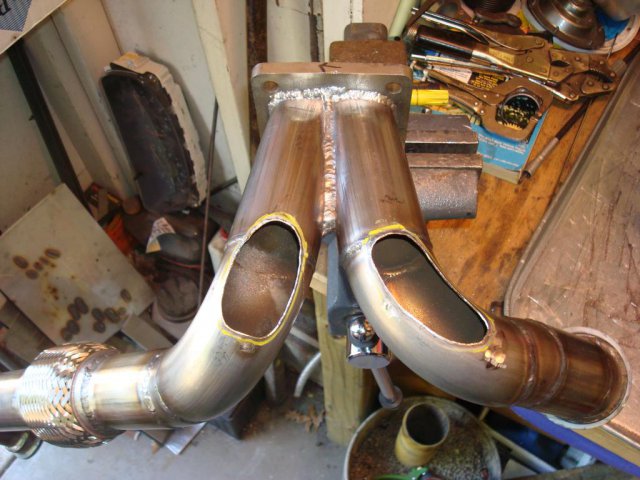

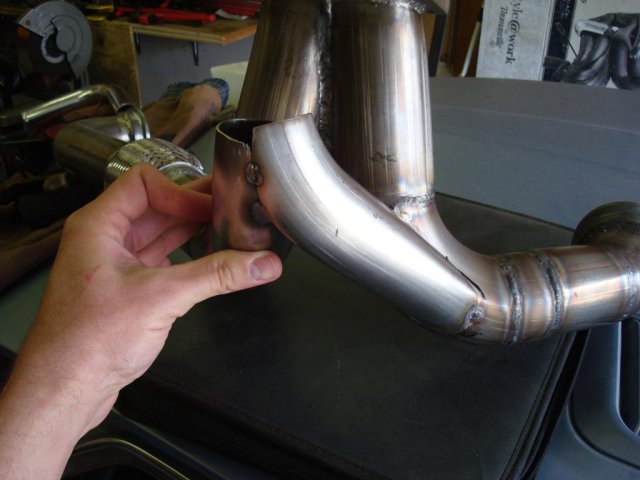

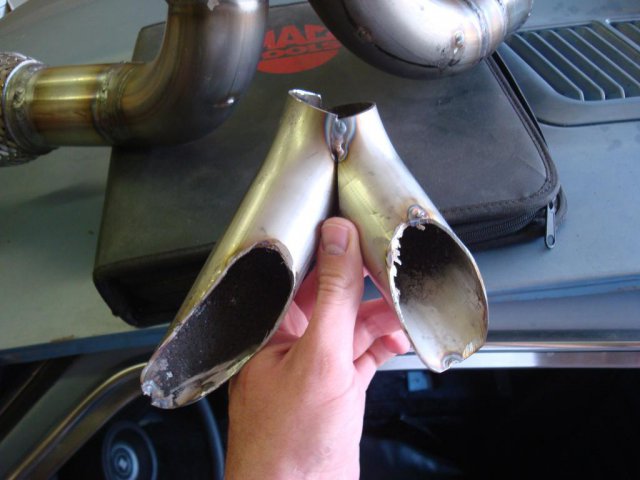

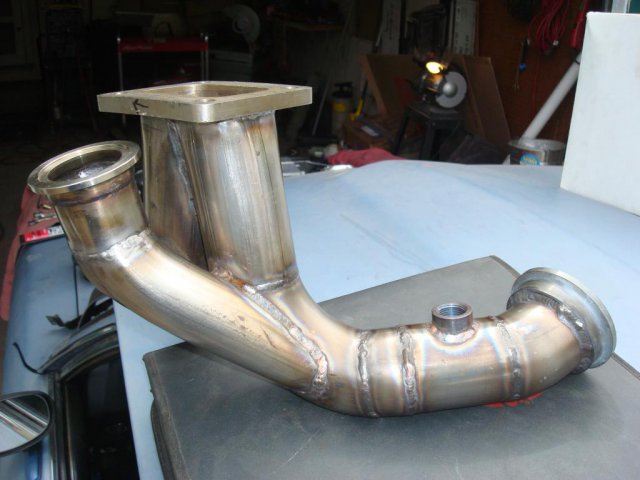

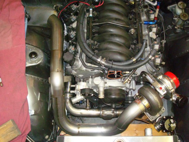

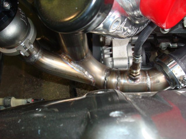

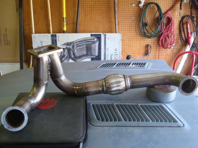

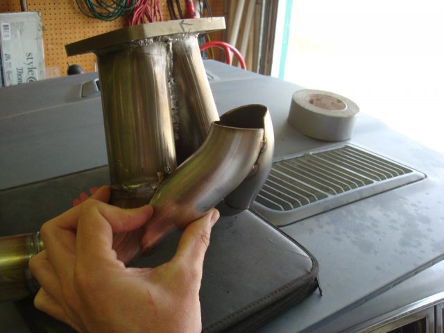

Slow78z Posted April 2, 2014 Author Share Posted April 2, 2014 More pictures! Cut some holes with a plasma cutter in this pic. A fellow gear head sliced them out in no time for me. I realy need to get a plasma cutter. Burned in wastegate merge. Installed crossover with wastegate. Got started on the down, up, and over pipe. That exhaust is going to be so dizzy it's going to puke when it finaly gets out. Quote Link to comment Share on other sites More sharing options...
SUNNY Z Posted April 2, 2014 Share Posted April 2, 2014 (edited) WG merge looks good. Will you be using the O2 sensor pictured for a wideband port? You might do some looking around on that. In my research I found that you want your wideband within 18" of the turbo outlet. My system doesn't use O2's at all, only a wideband. Looking good though! Also, I'd HIGHLY recommend changing that fitting on the inlet of your fuel rail. They have ones now that actually thread in from the back side, along with slipping over the factory push on fitting for a positive lock. I had mine come off last year on a WOT pull, and doused the headers (and EVERYTHING in the engine bay) with gas. I'm very lucky it didn't start a fire, or I'd have been sitting on the side of the road watching the car burn. Tip #2 - Carry a fire extinguisher. It would be terrible for anyone to watch their car burn down on a country road or even return road at the track for that matter!!!! Edited April 2, 2014 by SUNNY Z Quote Link to comment Share on other sites More sharing options...
socorob Posted April 2, 2014 Share Posted April 2, 2014 I just got my replacement fuel push on connectors yesterday. I had the black ones with the plastic clip then read on a few different forums of people here and there having them pop off and catch or almost catch the car on fire. I decided to replace them with the blue screw together ones while I'm doing the plumbing just to be safe. Quote Link to comment Share on other sites More sharing options...
Slow78z Posted April 2, 2014 Author Share Posted April 2, 2014 WG merge looks good. Will you be using the O2 sensor pictured for a wideband port? You might do some looking around on that. In my research I found that you want your wideband within 18" of the turbo outlet. My system doesn't use O2's at all, only a wideband. Looking good though! Thanks Sunny Z. The O2 bung that is pictured is just bank 1 for the ECM. Bank 2 is bung is on the other end of the crossover just after the 90. The wideband is going in the downpipe. Also, I'd HIGHLY recommend changing that fitting on the inlet of your fuel rail. They have ones now that actually thread in from the back side, along with slipping over the factory push on fitting for a positive lock. I had mine come off last year on a WOT pull, and doused the headers (and EVERYTHING in the engine bay) with gas. I'm very lucky it didn't start a fire, or I'd have been sitting on the side of the road watching the car burn. Tip #2 - Carry a fire extinguisher. It would be terrible for anyone to watch their car burn down on a country road or even return road at the track for that matter!!!! I remember your post on your build about the fitting coming off during a pull. Man that would have been terrible to catch on fire. I'm glad it didn't. I was also sceptical about the fitting holding so I had already decided to use safety wire to hold it from popping off. I've also got safety wire holding the fittings on the corvette filter/regulator. In this pic I had just cut it off to remove the fitting and intake. I will check out the fitting your talking about. I didn't even know it was an option. By the way, the fire extinguisher has a nice cozy home behind the passengers seat. Quote Link to comment Share on other sites More sharing options...

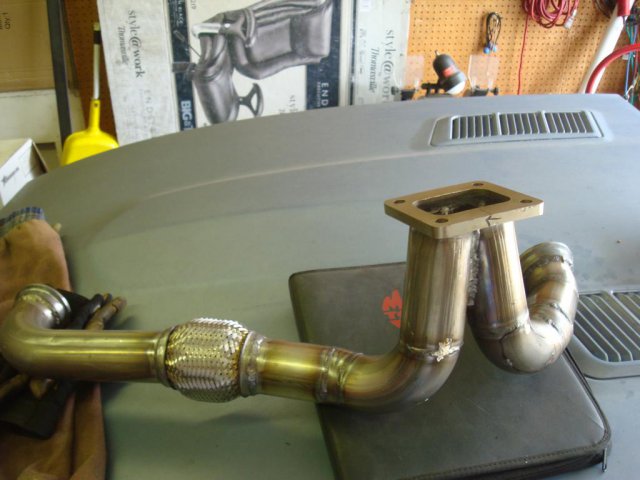

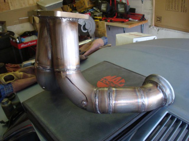

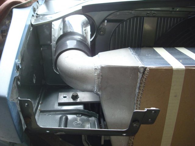

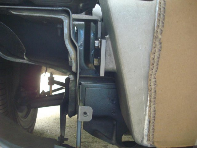

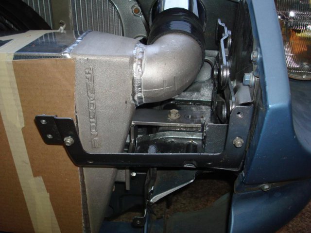

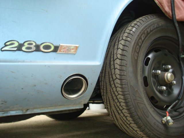

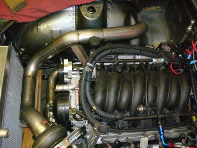

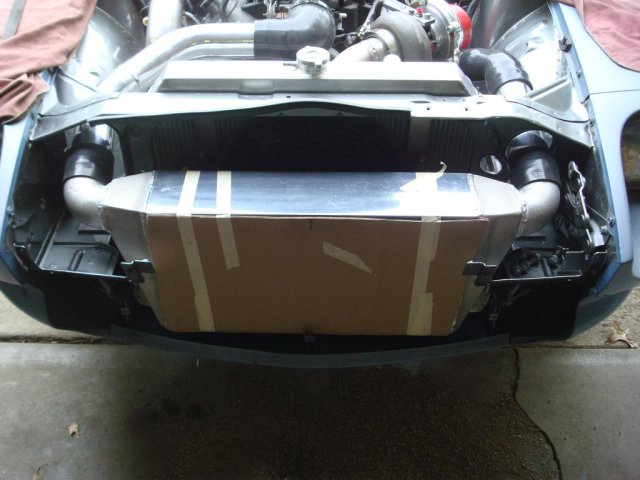

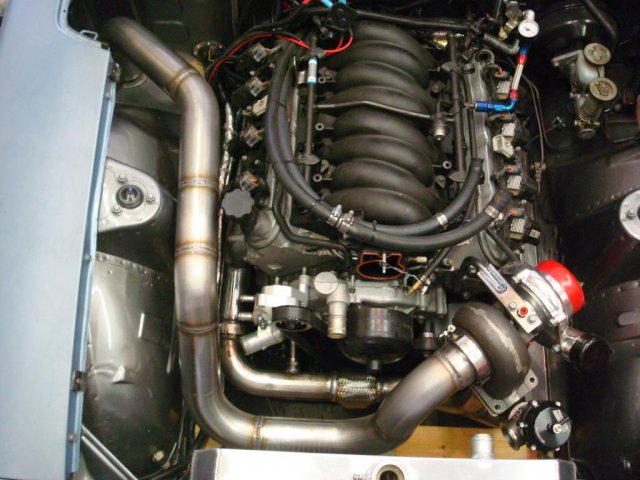

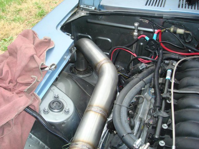

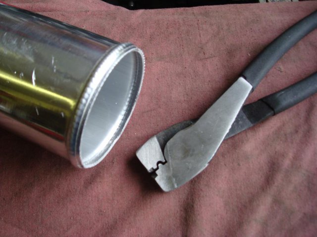

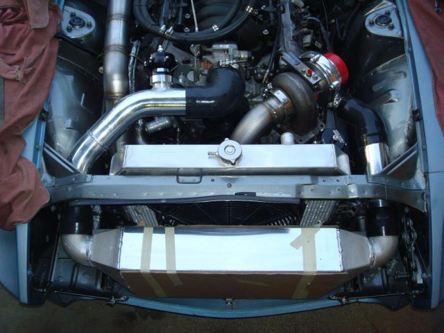

Slow78z Posted April 24, 2014 Author Share Posted April 24, 2014 We have been having some nice days here all in a row lately so I've been able to get more done. It's acctually starting to come together and look like a turbo car now. It's so exciting! I've also decided to change my fuel. I was going to go with E85 but with limited availability in my area and the difference in consumption, I have decided to go with good old 91 octane with water/meth injection. I have an aluminum fuel line also and E85 likes to eat aluminum. More progress pics. Mostly finished down pipe. I made a flange to help support the metal where I cut out a 4 inch hole. Passenger side fender exit exhaust. I'll be purchasing or making a flange for this opening also Mounted the intercooler with just enough room for the fan. Also cut off straight tubes from intercooler and welded on elbows. Most of the charge side is done. I just need to figure out a air intake setup. Custom bead roller. (Harbor Freight wire cutter/crimper) Quote Link to comment Share on other sites More sharing options...
