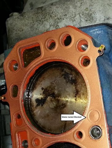

AZGhost623 Posted February 23, 2014 Author Share Posted February 23, 2014 SO... Got everything off. #6 was pretty wet, and noticed a water jacket was blocked on the MLS gasket near #6. I plan to call Cometic up tomorrow directly and ask what the heck. The punch out for the jacket is there, but its not cut. The water jacket is there on the block and on the head. I doubt Ill be able to do anything with a 'return' now that the MLS gasket has been sprayed with copper. I also put down a very thin layer of rtv red silcon gasket on the block as well for safe measure around all the water jackets. But my thinking is if that jacket is blocked off, then it might be trying to get that pressure out any which way it can... Quote Link to comment Share on other sites More sharing options...
Josh280z Posted February 24, 2014 Share Posted February 24, 2014 Maybe they left the water jacket blocked on purpose, not saying that it is true but you might check it with a regular gasket and then modify accordingly... Quote Link to comment Share on other sites More sharing options...

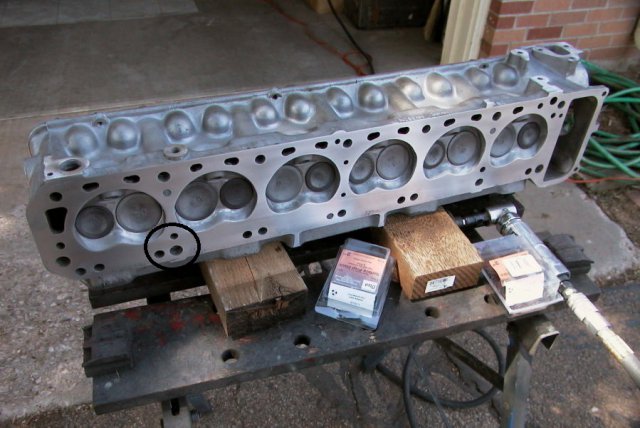

NewZed Posted February 24, 2014 Share Posted February 24, 2014 How about a picture of the cored but not removed MLS coolant hole? Just for future lurkers. Here's an image of a Fel Pro P90 headgasket, borrowed from RockAuto.com Quote Link to comment Share on other sites More sharing options...
AZGhost623 Posted February 24, 2014 Author Share Posted February 24, 2014 (edited) Here are the pictures I sent over to Cometic. They are reviewing and will get back to me. On your felpro pic, the waterjacket is open where it is in question on the MLS gasket closed off. I have read on other websites, that the holes may be different sizes to help with metering the flow of oil/coolant through the head/block which isnt a concern of mine. I did read on some BMW forums, they weld up coolant passages to help with better flow/pressure, where as an MLS corrects this right out of the box. So not sure if this is intended as some kind of performance mod or not. Hope to hear back from Cometic by end of day so I can get this buttoned up one way or another (to drill it out or not). Its the only hole is question, everything else is open. Edited February 24, 2014 by AZGhost623 Quote Link to comment Share on other sites More sharing options...
NewZed Posted February 24, 2014 Share Posted February 24, 2014 Thanks. These head gasket questions come up all the time, it will interesting to see what Cometic comes back with. If you stick a wire through those holes in the head you might find that they're connected, so blocking one does just change the flow in that area of the head, but not stop it. But that's where flow is low, the back of the head, from what I've seen on this forum so blocking a passage there seems odd. Maybe they know something special. Quote Link to comment Share on other sites More sharing options...
AZGhost623 Posted February 24, 2014 Author Share Posted February 24, 2014 (edited) Well they told me to send in my old felpro gasket and they will add a new line to their catalog for it. In the mean time I can either drill out the hole or wait until they get the template modeled for a gasket to fit 1980 to 1983. Edited February 24, 2014 by AZGhost623 Quote Link to comment Share on other sites More sharing options...
NewZed Posted February 24, 2014 Share Posted February 24, 2014 So the guy you're talking to at Cometic doesn't know why it's that way and is taking the easy way out. They'll offer a mystery gasket and a Fel-Pro copy. Oh well. Quote Link to comment Share on other sites More sharing options...
