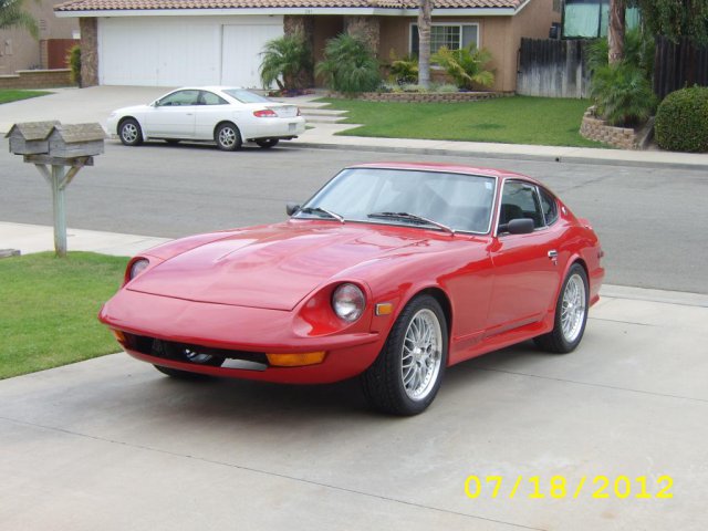

FrankieD Posted March 21, 2014 Author Share Posted March 21, 2014 My budget of $10,000.00 came from a quote from "Bones fabrication...hot rods & muscle cars" a local shop. They have an excellent reputation and complete facilities. As for the rest of the car the body/interior and suspension have all been done. I'm in a little over $15k for that. Quote Link to comment Share on other sites More sharing options...
ktm Posted March 22, 2014 Share Posted March 22, 2014 Frankie, the car looks fantastic. You have to take everyone's quotes for swap prices with a grain of salt. Everyone does things differently. My swap cost me around $8,000 and that includes the price of the engine and transmission. I did all of the work myself, but my car was previously setup for fuel injection from my earlier turbo build. If I had to include the cost of setting up the car for fuel injection, I would be at $9,000 to $10,000. FYI, I hope the shop is not manufacturing their own mounts. You can pick up JCI mounts, which includes the driveshaft, for $600. Buy the ceramic coated headers from JTR for $500 and you are set. Everything else the shop will need to build. Quote Link to comment Share on other sites More sharing options...
