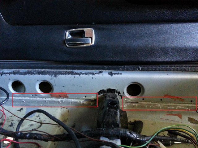

Hi guys. I have started the process of stitch welding all the seams of my 280z and ran into a issue. How do I prep the crevice between the rockers and the floors for welding? It seems to narrow for my wire brush, on my grinder, to get the paint off. Hell, do I even have to reinforce this area?

I used a knotted wire wheel first, then dug the rest of it out with a pick. Worse is the arch over the wheel wells, BTW.
If I had it to do over again I'd lay a piece of sheet over the joint and weld that. In the wheel well there are 3 or 4 layers, and getting them all clean enough to make a decent weld is a real PITA.
Edited by JMortensen
It looks like that joint has a spot weld every inch and a butt-load of sealer to get out.  I wouldn't bother welding that section (the pain to benefit ratio does not support the required effort).  Since you have a 280z, I would really pick and chose where to stitch weld if at all.  The 280z is like a 1,000 times sturdier than a 240z with lots more spots, whereas the 240z has lots of edge welding from the factory with large spaces between welds (the metal at the edge of the weld fatigues and breaks away from the weld), especially in the trans tunnel at the rear of the tunnel and at the firewall.  But honestly, the pros would know better than I do; I'm only reflecting what I have seen personally.

I guess I got to the easier stuff first; I already welded the laps at the firewall/floor and at the rear of the transmission tunnel (behind the seats). I will definitely heed your advice and weld between the rocker and the floor, underneath the car.
It's pretty relieving to hear that I can have choices on where I want to stitch weld. What I've been reading is that I should be aiming to weld every seam/lap in a S30. So in that case, are there particular areas that needs more attention than others for a 280z chassis? It would be especially nice to hear that I can ignore the wheel wells :)
