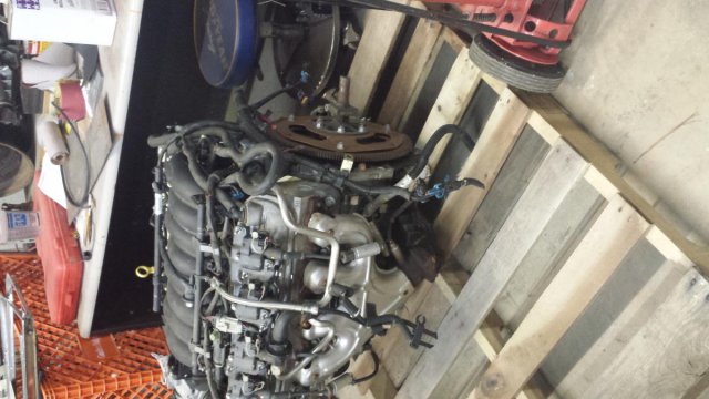

grayson260z Posted April 9, 2014 Share Posted April 9, 2014 (edited) So I've had my eyes on a ls1 engine and a bunch of parts I couldn't identify at my cousins shop. I've just about got my dad sold on the idea of swapping a Chevy V8 into my 260Z and he actually seems really interested. (probably because it's GM) AAnyway I was wondering about your rear end setups on your V8 swapped Z's I know the common option is a R200 LSD or welding a R180 but I'm still kinda anxious about putting close to 350 hp to the wheels on a 40 year old car. Also I need help IDing the engine its self. It's an aluminum block LS1 so I know it's a car engine but I'm unsure about the displacement. I remember somebody at a family reunion saying something about a 5.3l at their shop but I thought the 5.3's were truck engines? My dad swears my cousin got the engine out of a Corvette a few years back but I'm not sure. Thank you guys! PS; I know many people will get the exhaust manifolds off of a Vortec truck to modify into a turbo manifold and I was wondering what the most common truck you can get the manifolds off of is? Edited April 9, 2014 by grayson260z Quote Link to comment Share on other sites More sharing options...

mattd428 Posted April 9, 2014 Share Posted April 9, 2014 Corvette accessory drive. Look at the had casting number 799 243 is ls6 241 and i think 853 is ls1. On the front or back of each cylinder bank and behind the flywheel I believe is the engine size. Pretty sure its and ls1 from the pic. Also look at the valve covers perimeter bolts is a 97-98 engine center bolt valve covers are 99 and up. Quote Link to comment Share on other sites More sharing options...
mattd428 Posted April 9, 2014 Share Posted April 9, 2014 Post better pics. Quote Link to comment Share on other sites More sharing options...

280zjake Posted April 9, 2014 Share Posted April 9, 2014 its either LS1 /LS2 Corvette look and see if it has a throttle cqnle or dbw hrottle. its not a Z06 motor w automatic flexplate Quote Link to comment Share on other sites More sharing options...
RebekahsZ Posted April 9, 2014 Share Posted April 9, 2014 Look for any numbers cast on the block or heads and post them. The answer to your questions is in the numbers. Don't worry about your rearend until you have the motor and tranny in and running-folks always get ahead of themselves on this subject. Shoot a photo of the front of the engine so we can see the alternator and crank pulleys and the throttle body. Quote Link to comment Share on other sites More sharing options...
SUNNY Z Posted April 9, 2014 Share Posted April 9, 2014 Those are C5 exhaust manifolds. Its an LS1, 99-04. Can't tell if theres an EGR port on the top of the intake or not. If so, its an LS1 intake, meaning that its Pre-2001. I'd guess 853 or 241 heads. Either way, it will be a great motor for a Z! The swap can be done for a reasonable price, but don't get carried away with the "while I'm in there" stuff...... ask me how I know. Quote Link to comment Share on other sites More sharing options...
grayson260z Posted April 9, 2014 Author Share Posted April 9, 2014 I'll try to get a better picture some time soon. The picture was dowloaded from Snapchat so it has super bad quality Quote Link to comment Share on other sites More sharing options...

grayson260z Posted April 9, 2014 Author Share Posted April 9, 2014 Better look at the engine. Also I was thinking wouldn't smaller twin turbos be easier to mount rather than running pipe to one side of the bay for a single? IC piping might be a pain and having to buy twin BOV's Quote Link to comment Share on other sites More sharing options...

mattd428 Posted April 10, 2014 Share Posted April 10, 2014 99 and up ls1 out of a vette. Quote Link to comment Share on other sites More sharing options...
grayson260z Posted April 10, 2014 Author Share Posted April 10, 2014 What kind of power do you estimate it would make? Either way it's more than enough for a Z lol Quote Link to comment Share on other sites More sharing options...
SUNNY Z Posted April 10, 2014 Share Posted April 10, 2014 (edited) Easily 300++ to the tires bone stock. Edited April 10, 2014 by SUNNY Z Quote Link to comment Share on other sites More sharing options...
