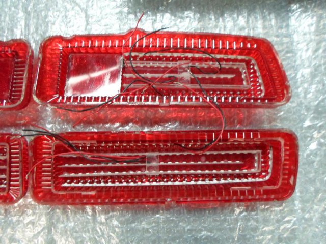

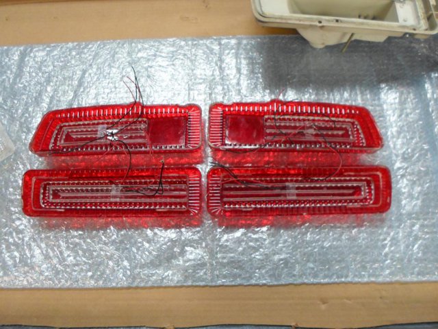

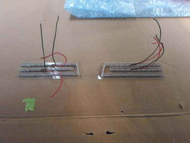

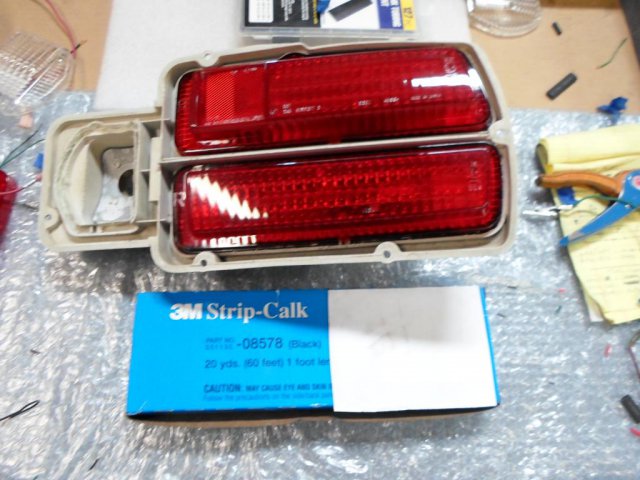

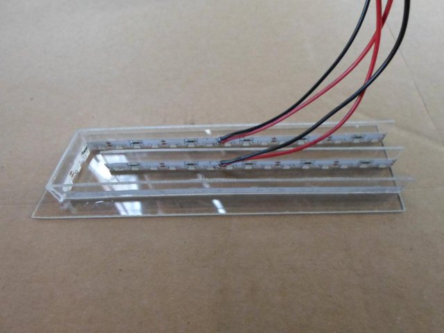

Here's how I did the inserts . Nice to have a sign shop next to my shop . Still waiting on a replacement sequential module .

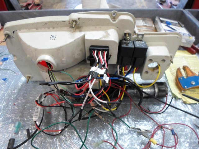

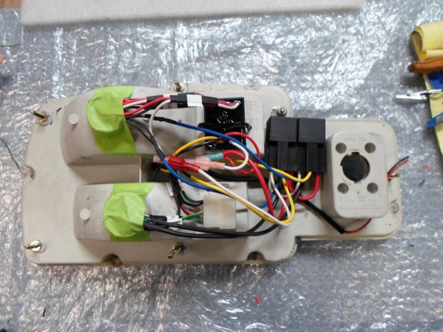

Will be doing my brake lights today . Wiring is going to be fun . Since I'm incorporating running lights ( perimeter strips ) with turn signal and brake , I have to use relays and diodes to make them work ( in theory ) . We will see .

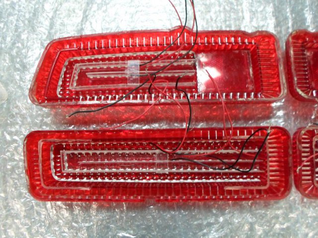

Finally , I got one side done , still waiting on dimmer modules for the other side . Will post VDO later . Only one thing that I didn't expect is , when brake applied , the LEDs slowly ramping up to full brightness and when release , with running lights on , the outer ( running lights ) LEDs won't dim back down at times . It will if I tap the brake again .

Here's a mess that i have to deal with . Got a little carry away with this LED tail light project .  :lol: .
Cleaned up a little .

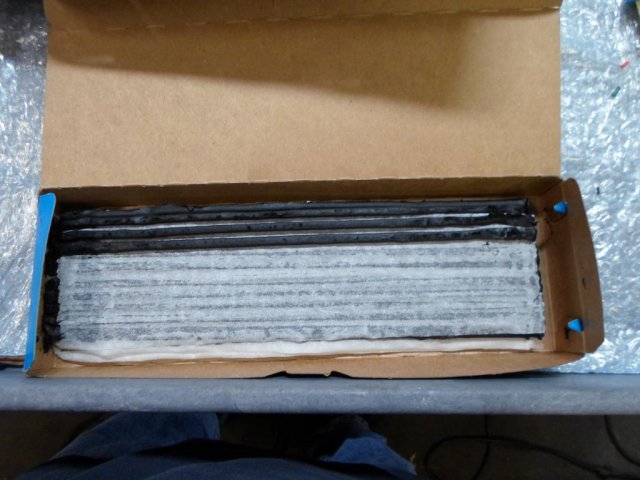

This is what i used to reinstall the lenses .
It works great . Easy to use and will not hardened up , stays tacky .
