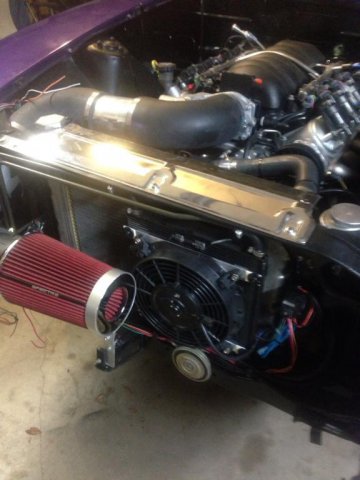

Mikey303LSZ Posted May 22, 2014 Share Posted May 22, 2014 This is my current air filter location. I want cold fresh air but afraid of water related issues when driving in the rain. Anyone got thoughts or experience they could share? Quote Link to comment Share on other sites More sharing options...
mattd428 Posted May 22, 2014 Share Posted May 22, 2014 What's wrong with that? Quote Link to comment Share on other sites More sharing options...
Domzs Posted May 22, 2014 Share Posted May 22, 2014 Don't drive it in the rain or use half of a coffee can around the filter , you get the idea . Looking good . I don't like the idea of driving my Z and ZX in the rain , not fun . Quote Link to comment Share on other sites More sharing options...
Domzs Posted May 22, 2014 Share Posted May 22, 2014 I used OE air filter box with K&N filter ( came with car ) . Quote Link to comment Share on other sites More sharing options...
RebekahsZ Posted May 22, 2014 Share Posted May 22, 2014 I had the same concerns. The hood covers it pretty well. Mine is the same and it has been fine. Have raced on days with 4" of standing water on the track and rain so hard I couldn't see the cones. Car ran great. No traction but plenty of power. K&n would have us oil their filters but I never do because I don't want the mess. Quote Link to comment Share on other sites More sharing options...

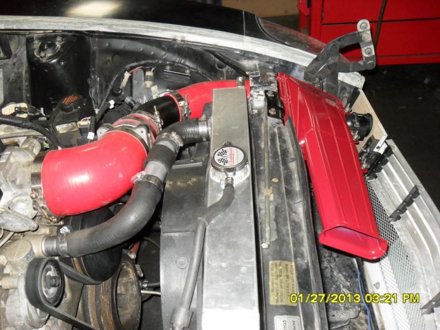

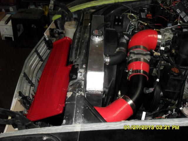

Zfan1 Posted May 22, 2014 Share Posted May 22, 2014 I had mine up front like yours (bigger filter) but Im guessing it caused some sort of turbulance because my Z would start to run real hot. I moved it into the engine compartment, it's now in front of air vent at radiator support and that cured my over heating issues. Quote Link to comment Share on other sites More sharing options...
Zfan1 Posted May 22, 2014 Share Posted May 22, 2014 This is a before and after shot Quote Link to comment Share on other sites More sharing options...
Domzs Posted May 22, 2014 Share Posted May 22, 2014 This is a before and after shot Looks great . I just don't like idea of sucking hot air from engine compartment ( hurts HP ) , especially with headers . I would build some kind of block off panels/plates or box . Quote Link to comment Share on other sites More sharing options...
