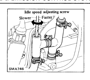

NewZed Posted June 9, 2014 Share Posted June 9, 2014 The factory option, same concept. Quote Link to comment Share on other sites More sharing options...
