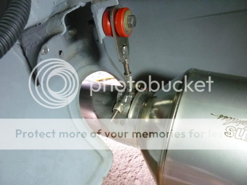

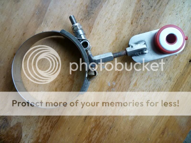

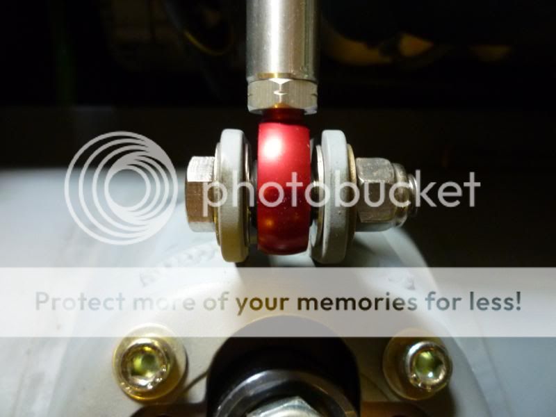

Zzeal Posted September 26, 2014 Share Posted September 26, 2014 (edited) Here's a way to make a "T-bolt" muffler clamp do double duty as an exhaust hanger. I started with a Summit hanger, cut it off at 2-1/2" and slotted it to accept a 1/4"-20 coupling nut. I "mitered" the end of another coupling nut on a bench grinder to conform to the T-bolt. Then, it's nice to have a friend who's a welder! All this stuff is stainless, so this time I'm slathering the threads with anti seize… I recently got caught out, unexpectedly, by the 'ol stainless galling, seizing routine. I didn't think loosely assembling the stainless would be a problem… ended up having to cut the nut off of this bolt!. The other side came apart, luckily. This ends up being a rather pricey hanger though, because stainless. The stupid T-bolt alone cost over $20, hanger another $20, nuts and rod were $6, and if you had to pay for the welding, yikes!. Anyway, I just wanted to get the idea out there. You could maybe do something similar, using less expensive pieces parts. And while I'm prattling on about fabbin' stuff… here's something else that could maybe help someone who's new to cutting thin, sheet aluminum with a jig saw. The finest blades I've found locally are Bosch's 17-24 Progressive Tooth T-118-A's. These are still too coarse for 1/16" (type 3003) aluminum. they apparently clog up with the aluminum, ,sometimes kick back and even bend the piece you're cutting out. I've found if you source some finer 36 TPI blades, like the T-118-G's, lube up your cut line with a wax stick, or with a little light oil, and run a variable speed saw at about half throttle, you get nice, consistent cuts, and without the anxiety. Steve Edited September 26, 2014 by Zzeal Quote Link to comment Share on other sites More sharing options...
