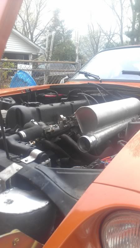

AT THE FRONT OF THE ROCKER COVER.
No need to yell, he who's name can't be pronounced.
As I see your giant intake plenum I think I won't have any issues. I'll just angle the throttle body downward.
Thanks for the useful pic.
The hood slopes down, you will have no issues except for the front corner.

That intake didn't clear the hood by about 3/4". It also is 22" long, so the shorter LD intake plenum should clear fine.
