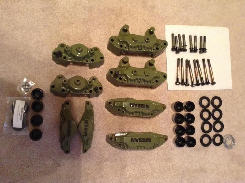

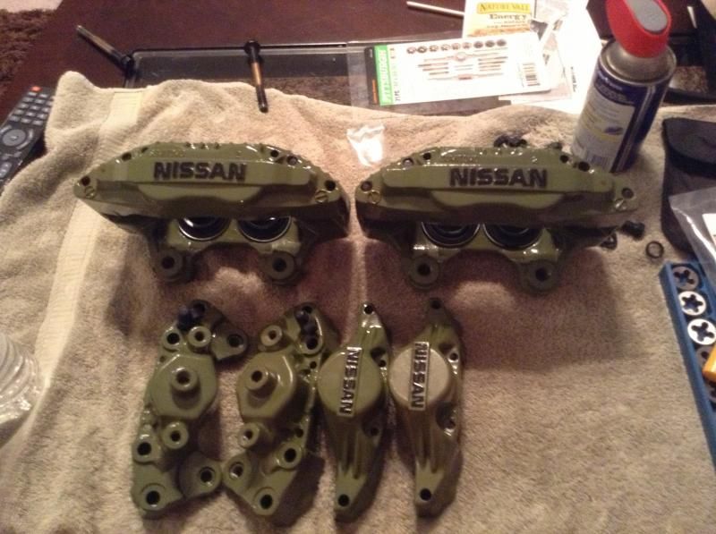

Dat260Z Posted October 16, 2014 Share Posted October 16, 2014 (edited) Those were before rebuilding/powdercoating . I now have front and rear z32's ready to be mounted. Here is a breakdown of what I have invested : Front bracket $175 Front rotors:$125 Rear brackets:$150 Rear rotors:$110 Front z32 aluminum 30mm calipers $250 Rear aluminum z32 calipers :junkyard find for $35 for the pair Z1 motorsports caliper rebuild kit: all 4 corners :$50 (do not buy) Stainless braided lines with banjo fittings $125 Brake pads $100 Powdercoat $45 A good amount of time braking down , sandblasting, powdercoating , rebuilding calipers )And I got some sweet decals made to stick on the raised NISSAN lettering..probably wont stay on very long but they are pretty. I will throw so,e high temp paint on the letters if the decals come off. Edited October 16, 2014 by Dat260Z Quote Link to comment Share on other sites More sharing options...

roger280zx Posted October 20, 2014 Share Posted October 20, 2014 Those decals should only be used to paint the letters on those calipers, as they will be gone the first time you actually use the brakes. Paint that area of the caliper the color you want the letters. Let it cure thoroughly then install the decal over the letters, then paint the caliper. Once that flashes you can remove the decal and expose your painted letters. Quote Link to comment Share on other sites More sharing options...
