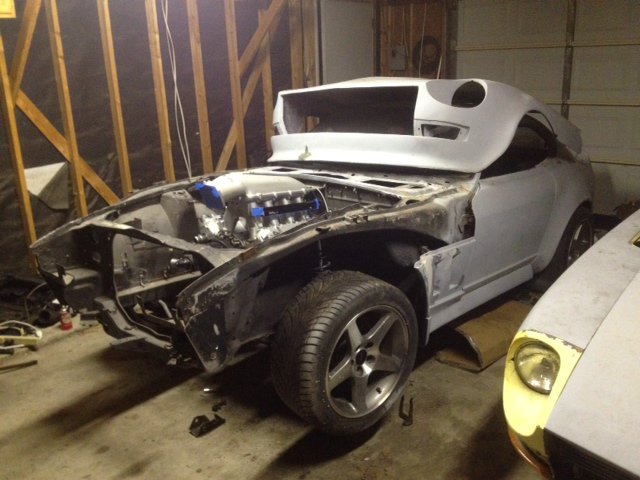

zeeboost Posted November 13, 2014 Share Posted November 13, 2014 I hope to join within a year's time, but for now this is as close as I'll be to the club Quote Link to comment Share on other sites More sharing options...
