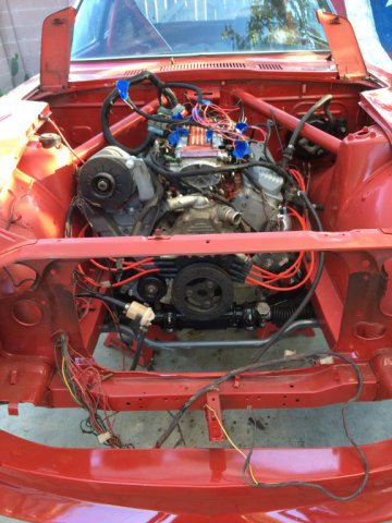

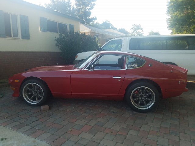

Silver Mine Motors Posted August 24, 2015 Author Share Posted August 24, 2015 Finally got the car back from the paint shop. It looks Looks beautiful! Been hard at work. Re-installing body parts, Changing bushings, sway bars and Installing the Lt1 engine and T56 trans. So far things are moving fast with minimal complications. Here's a few pictures Quote Link to comment Share on other sites More sharing options...

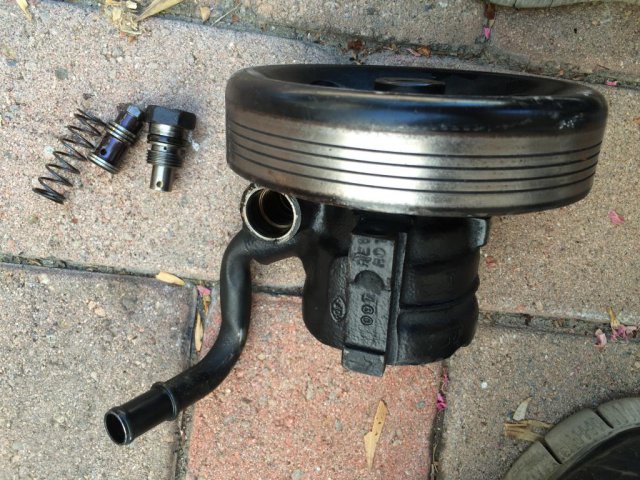

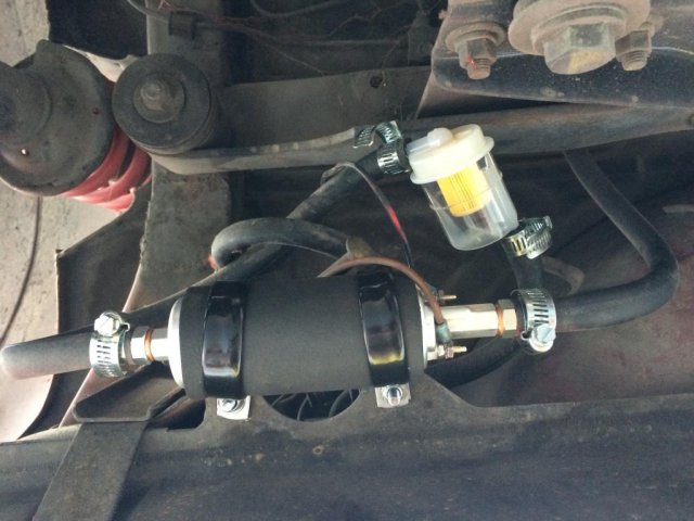

Silver Mine Motors Posted September 5, 2015 Author Share Posted September 5, 2015 Still working hard on the 240z. Been buying many parts and prepping the engine for the first start. Changed the clutch master cylinder with a Tilton unit. Running fuel lines and filters, changing oils, installing sensors and wiring. Deleted the A/C and powersteering pumps. Had a drive shaft made. Installed a WALBRO 255LPH fuel pump, and more. Quote Link to comment Share on other sites More sharing options...
Silver Mine Motors Posted September 17, 2015 Author Share Posted September 17, 2015 Update: We installed the accessory and belt system. Aluminum radiator and Taurus fan with all hoses and water block off plugs. Sent PCM out to get flashed. Started building intake system. Currently working on all the wiring and sensors. We are getting very close to starting this beast. So excited to hear it run. I can't wait to start working on my favorite part; brakes and suspension. Quote Link to comment Share on other sites More sharing options...

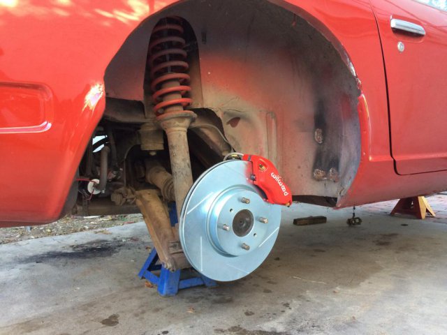

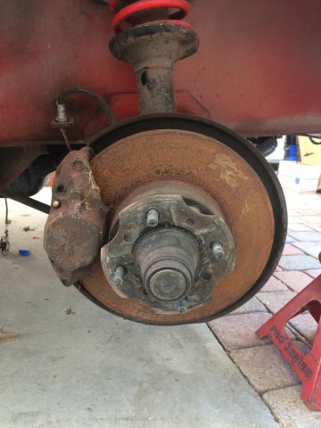

Silver Mine Motors Posted November 14, 2015 Author Share Posted November 14, 2015 (edited) Been working 240z. Installed front and rear wilwood brake upgrades. Installation was easy. Also installed new Tie rods, Ball joints, Rack Boots, Lowering Springs and Tokico Shocks. Finished most of the engine just waiting for parts. Also need to change the fuel hard line since it's leaking. I made these how to install videos for the brakes: Edited November 14, 2015 by Silver Mine Motors Quote Link to comment Share on other sites More sharing options...

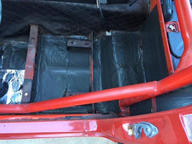

Silver Mine Motors Posted November 26, 2015 Author Share Posted November 26, 2015 The 240z model was a very loud and uncomfortable car. I'v herd it compared to a coke can on wheels, and I kinda agree. That's why we installed rubberized Sound deadening on our interior. I'm hoping to reduce the road noise significantly. Also installed rear 7/8 sway bar. Realized our gas tank was full of rust so it is being chemically cleaned now. Check out the picture of the inside of the gas tank before treating. pretty rusty! Can't wait to see how it looks when it's back from treating. Started installing some exterior lights and emblems which were all restored. New Complete carpet kit being installed next. Quote Link to comment Share on other sites More sharing options...

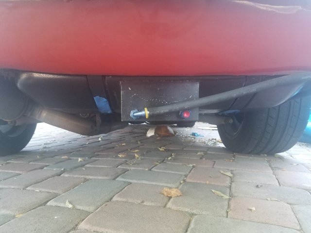

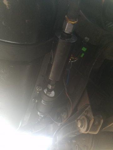

Silver Mine Motors Posted July 18, 2018 Author Share Posted July 18, 2018 Been working on the car some more. Got a new used gas tank and welded an external sump on it. Then had it professorially cleaned and re sealed. Installed AN fittings to a Huge fuel filter with cleanable filter screen. installed a WALBRO 255LPH fuel pump. Re installed the door panels and seats and many other interior parts. Car would not start for months while We tried everything. In the end it was the third opti spark unit that works. We also converted the LT1 ignition system to use 8 x LS1 coils, using Bob Bailey LTCC kit. Now the car runs great! Fast and even a little scary. Sorry for the late reply, I bought the roll cage as a general kit. It had to be re bent and modified to fit, plus I added a few extra parts. Quote Link to comment Share on other sites More sharing options...
