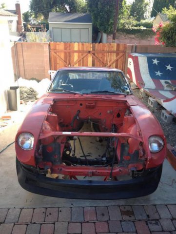

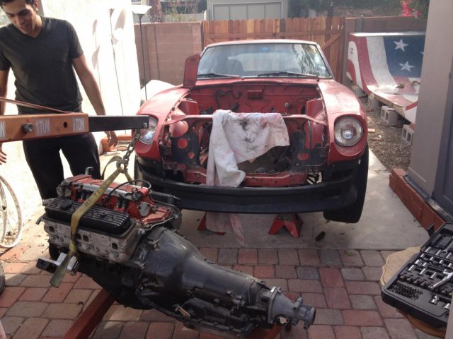

I bought the car with the rebuilt LT1 engine so why not keep it. I don't want to sell it, add money to get a used LSx. Today I removed the drive train  and de-greased the engine bay to prep for paint. Also removed all the lights, exterior parts. Going to install some fiber glass ZG fender flares to clear the 17x9.5/9 Rota RB wheels tomorrow.
Also need to start looking for a T56. I think I'm looking for one that came out of a Camaro with an LT1.

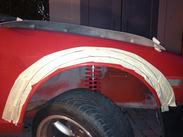

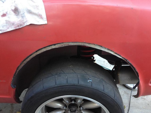

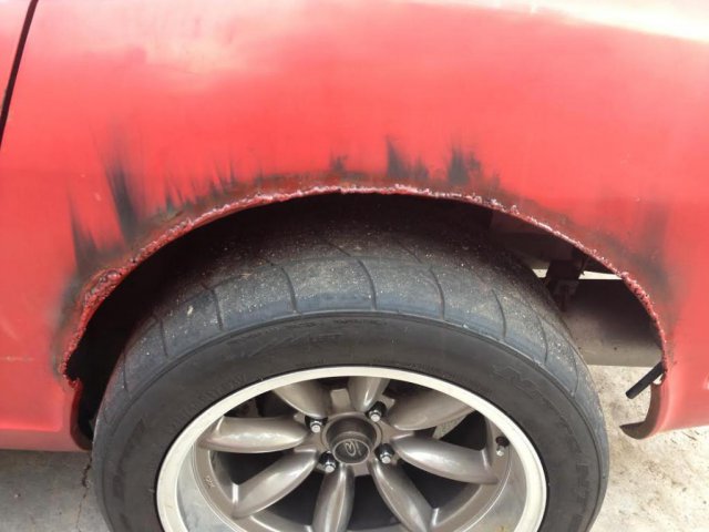

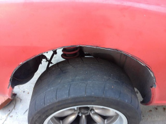

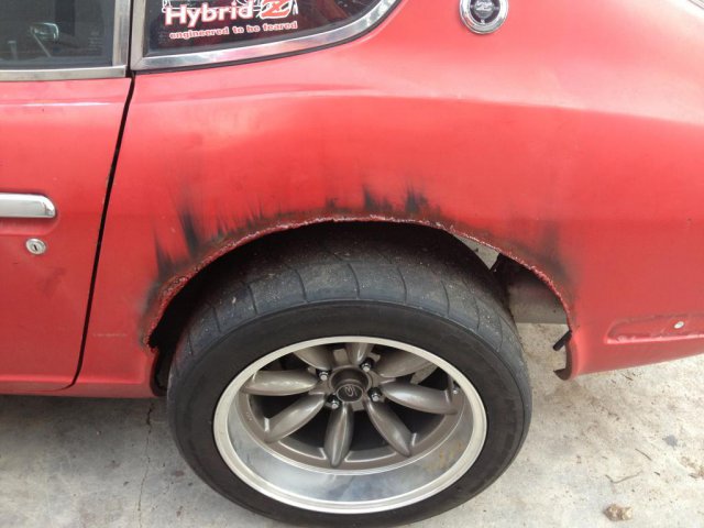

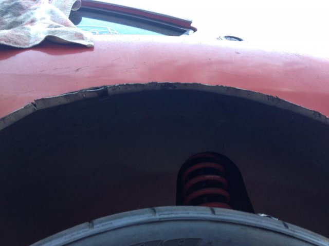

Started cutting original fenders off to make room for big wheels and to install ZG Fender Flares. It was so hard to Take a hand grinder to my perfect fenders, but it had to be done in order to have the 275's in the rear. Here's a few pictures.
Also bought a 8Pt. roll cage to stiffen up the body.

Good your going to keep the LT-1 engine.  It can be rebuilt and made as strong as a LSx engine.  If the LT-1 already has the ECU computer wired in, your in good shape.  A good T-56 will cost between $2500.00 - $3000.00.  Been there, done that.  Will require flywheel, clutch pressure plate, clutch plate, bearing for rear of crankshaft and perhaps Quicktime 9023 bellhousing/scattershieid.  Best start off with new T-56 as it is the least hassel.  Flywheel must be counter-weighted for external balance.  Get a good clutch pressure plate and clutch plate.  Will require clutch pedal, master and slave cylinders,  Been there, done that.

Lol no, a LT1 T56 is cheap and easy to find. They can be had for $1000 on craigslist. Just use the stock bellhousing as it was made to mount to an LT1.

Also finished cutting fenders and welding rear inner and outer fenders together.
Next I'll install the 8PT. roll cage, and then off to paint.
