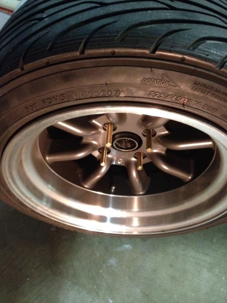

aongch Posted December 20, 2014 Author Share Posted December 20, 2014 Extended studs that fit are these 'GM' 100-7713 (long version) fit perfectly. These have the 0.509" knurl diameter. Test fit on street wheels, hey it's a track set up. Quote Link to comment Share on other sites More sharing options...

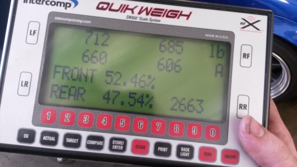

gnosez Posted December 23, 2014 Share Posted December 23, 2014 Interesting corner balance numbers. The usual problem is getting weight moved to the Right Front. Back in the day it has been mentioned that new motor mounts were made to allow the SCCA engine to be moved over more than an inch to the right and back about 3/4-inch. Legal? NFW. Lessons learned, leave the battery up front and make sure the fuel cell is as far right as possible. Total body weight is spot on for a caged car with an interior, driver and fuel. I assume the corner balancing was done with the sway bars and strut bars disconnected to start. Nice looking set-up and forget what anyone says about your exhaust noise. I love it. Quote Link to comment Share on other sites More sharing options...

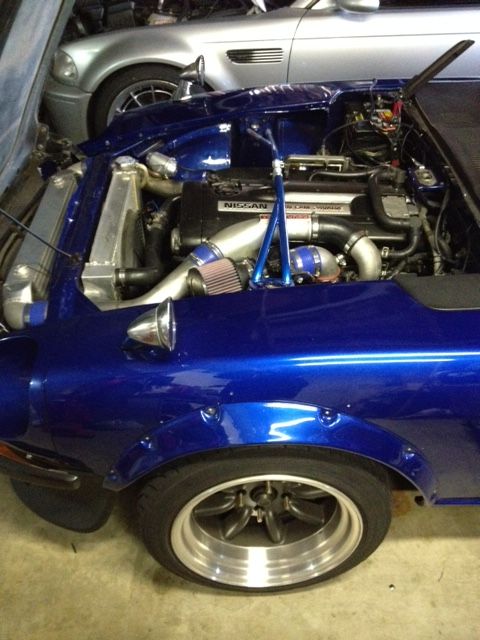

aongch Posted December 24, 2014 Author Share Posted December 24, 2014 (edited) West End did adjust the front STB at the strut mounting holes, for fine tuning camber changes and did not impact corner weight appreciably. I have the older EMI plates which are not fully slotted (future upgrade) but have specific adj mount points. Current camber set at -2.75 ft and -2.3 rr. Next hole adj at front would give -3.25, maybe too much for now.....but pyrometer readings will tell all on my first track day As far as weight distrib I'm excited about ATL 8 or 12 gal upgrade to mount below the floor offset towards the passenger side. Battery can remain at stock location. Anyone can comment on this 12 gal, I'm looking for short height for under-floor mount? Edited December 24, 2014 by aongch Quote Link to comment Share on other sites More sharing options...

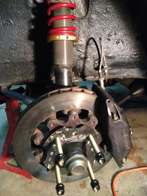

aongch Posted December 24, 2014 Author Share Posted December 24, 2014 (edited) Done with the front ARP extended studs, rears to complete soon, I feel much safer now!! Threads are now M12 x 1.5. Front needed a 15 mm spacer to clear the Wilwoods with this street setup, but I'll probably keep the spacer for a little wider footprint for the track wheels. Edited December 24, 2014 by aongch Quote Link to comment Share on other sites More sharing options...

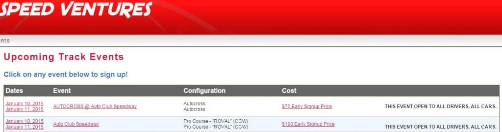

aongch Posted December 24, 2014 Author Share Posted December 24, 2014 (edited) My plan to shake things up will be this event, anybody local want to join on the 10th? I usually run the big track but will start off with auto-x for initial setup and working out any bugs. Been tracking with Speed Ventures for years, nice outfit. The auto-x is a non-work event, meaning you'll get 20-30 runs (~30-35 secs) if you stick around long enough. I might just end up signing up for the big track instead of auto-x, still prepping, fluids to change, ATE Blue, Redline, etc. Edited December 31, 2014 by aongch Quote Link to comment Share on other sites More sharing options...

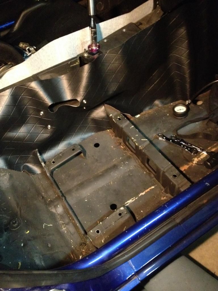

aongch Posted December 31, 2014 Author Share Posted December 31, 2014 (edited) A little bit of rain kept me indoors, some good came out of that. Had to cover up the ugly center tunnel, decided on the oem look, doesn't add that much weight. Five-point harness a must Thinking proper way to mount the ATL cell underneath, current tank sits secured on top. Is another option to build a tight steel box since I've seen those in ITS cars. Edited January 27, 2015 by aongch Quote Link to comment Share on other sites More sharing options...

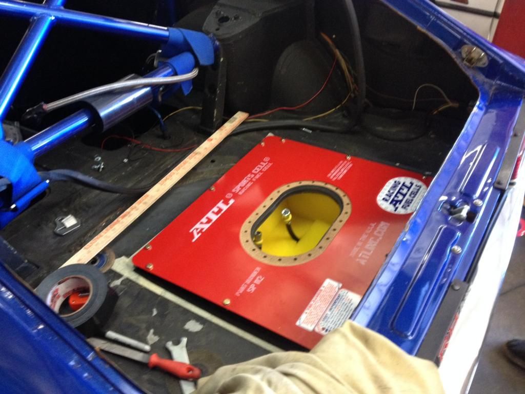

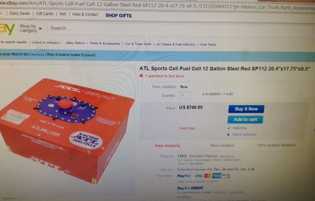

aongch Posted January 6, 2015 Author Share Posted January 6, 2015 (edited) I'm upgrading to ATL SP112 (12 gal) and relocating to underneath the floor. Any suggestions on where to place the Aeromotive pump and dual filters? Passenger side by rear side frame rail, or front of tank near diff carrier? Should I go with new hard lines or braided steel? Again, for a mainly tracked car, best safety in mind. I've been searching and looking at ITS set ups coming up with lots of variations. Btw, I always use a driver's suit, full carbon-x underwear, balaclava, gloves, not cutting corners, even in So Cal heat. Edited January 16, 2015 by aongch Quote Link to comment Share on other sites More sharing options...

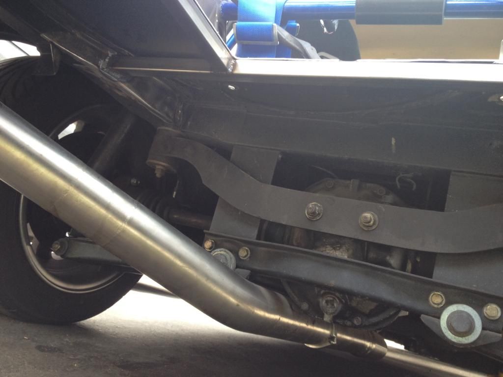

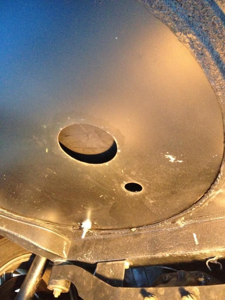

aongch Posted January 15, 2015 Author Share Posted January 15, 2015 (edited) Work is progressing on the ATL fuel cell conversion. This is to SCCA specs, totally encased, framing will be built and welded to frame rails, and all filters and pump will be underneath. I'm not messing around in this area! Full credit here goes to Offset Motorwerks in Glendora CA. Under framing 1"x1" tubing, consulted Spec E30 official to meet SCCA rules. Cell will also be supported once dropped in. Stabilizing straps, and notice the 12-gal tank has plenty of ground clearance. Track days are short, mileage wise, not worried about the smaller capacity. Full credit here goes to Offset Motorwerks in Glendora CA. Edited September 3, 2016 by aongch Quote Link to comment Share on other sites More sharing options...
EF Ian Posted January 26, 2015 Share Posted January 26, 2015 Sounds like its been done properly, good to hear. Quote Link to comment Share on other sites More sharing options...

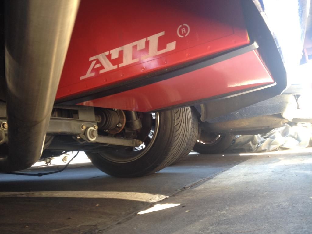

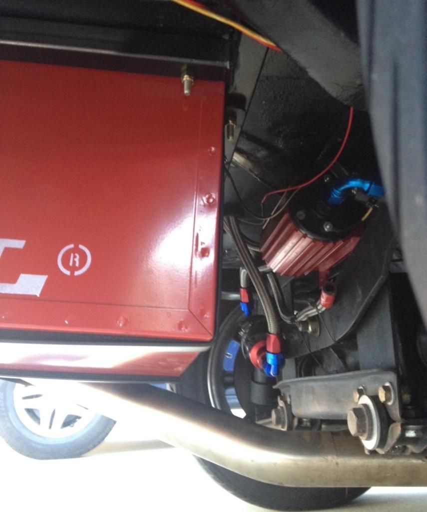

aongch Posted February 5, 2015 Author Share Posted February 5, 2015 (edited) ATL installed in the sealed box, fully supported underneath. Aeromotive pump and filter under the chassis, away from passenger compartment. Edited February 7, 2015 by aongch Quote Link to comment Share on other sites More sharing options...

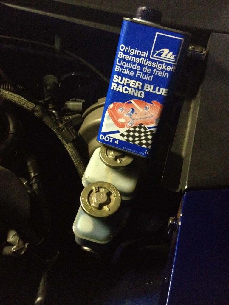

aongch Posted February 8, 2015 Author Share Posted February 8, 2015 A couple more things done. Using ATE Super Blue now, was on Motul RB600 on prior cars, we'll see. Also the ATL install moved the cross weight just a bit away from 50/50%, which I will address before tracking, but at least center of gravity is now better, lower. This is with 150 lb driver and about 4 gallons gas: Quote Link to comment Share on other sites More sharing options...
EF Ian Posted February 19, 2015 Share Posted February 19, 2015 Nice work on the tank install.I'm interested in how you find the Quaife, I have one in my Civic and its great but I wasn't sure how well it would work in a RWD. Let me know how you find it. Quote Link to comment Share on other sites More sharing options...
