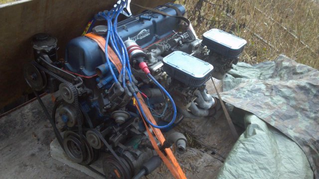

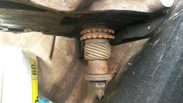

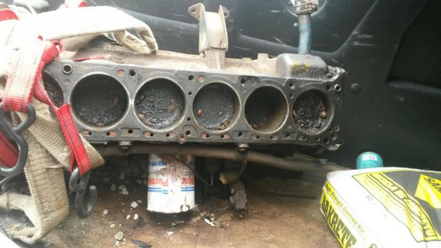

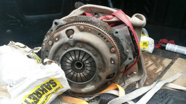

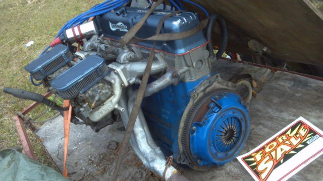

Project1 Posted January 12, 2015 Author Share Posted January 12, 2015 (edited) I found this motor for sale locally for $1000 ( I didn't buy it yet ..just saw it for sale) The guy didn't know much about it. I asked him if I could pull the head and check it out. All he said is the motor has been rebuilt and has a lot of power and proformance internals (whatever that means). It could be a good buy to use and just drop in maybe. I could put what I have for fuel injection on it and convert to MS. Or maybe worth it for parts or just too build on. The core I found to build, that I currently have, Is pretty rough, I'll try to put up some pics tomorrow of the core I have now. Any thoughts? Edited January 13, 2015 by Project1 Quote Link to comment Share on other sites More sharing options...
NewZed Posted January 13, 2015 Share Posted January 13, 2015 $1000 The guy didn't know much about it. I asked him if I could pull the head and check it out. All he said is the motor has been rebuilt and has a lot of power and proformance internals (whatever that means). That's a lot of money for a mystery motor. Did the guy have it built or just end up with it? What are you going to see if you pull the head? Besides piston tops and valves. Quote Link to comment Share on other sites More sharing options...
(goldfish) Posted January 13, 2015 Share Posted January 13, 2015 All power and money should be in the head. A well done documented head is worth some money. Quote Link to comment Share on other sites More sharing options...
NewZed Posted January 13, 2015 Share Posted January 13, 2015 (edited) My experience with people who say they don't know much about what they're selling is that they actually do know, and that there are problems and they don't want to be responsible after they get your money. Or they're selling it for someone else who wants to be even farther from the sale. Or it could actually be a decent buy, but you won't know until you find the guy that knows. The thing about modified engines is that they tend to be used hard, often breaking. Edited January 13, 2015 by NewZed Quote Link to comment Share on other sites More sharing options...
Project1 Posted January 13, 2015 Author Share Posted January 13, 2015 That's a lot of money for a mystery motor. Did the guy have it built or just end up with it? What are you going to see if you pull the head? Besides piston tops and valves. I just wanted to do a visual inspection, look for damage and try to identify parts. Quote Link to comment Share on other sites More sharing options...
Project1 Posted January 13, 2015 Author Share Posted January 13, 2015 My experience with people who say they don't know much about what they're selling is that they actually do know, and that there are problems and they don't want to be responsible after they get your money. Or they're selling it for someone else who wants to be even farther from the sale. Or it could actually be a decent buy, but you won't know until you find the guy that knows. The thing about modified engines is that they tend to be used hard, often breaking. Totally understand ...I was worried about the same thing. Quote Link to comment Share on other sites More sharing options...
Project1 Posted January 13, 2015 Author Share Posted January 13, 2015 (edited) So I talked to the seller on the phone today. The story: He said he races ford trucks. He bought this motor from a guy with a shop who builds trucks. He put this motor in his truck with a datsun 5 speed tranmission. He ran it one time and blew the transmission. He built a new transmission and ran it one time and broke the new transmission where it hooks to the drive shaft. He said he has both the tranmission still, and I could have thoes as well. Now he's running a 305 motor. End of story. I never know about trusting random people selling stuff like this. But if this were the case, maybe if I put a less aggressive cam in, i could use that as my staring block and head. It's worth a thought. The pics attached are the core I have. It's not pretty but it was the only one in a reasonable distance I could find. I'm sure it will clean up nice with a bore and a hot tank though. Edited January 13, 2015 by Project1 Quote Link to comment Share on other sites More sharing options...
SleeperZ Posted January 13, 2015 Share Posted January 13, 2015 (edited) Too much money for a mystery motor. You should be able to negotiate to much lower, and if not, walk away. Edited January 13, 2015 by SleeperZ Quote Link to comment Share on other sites More sharing options...
Project1 Posted January 13, 2015 Author Share Posted January 13, 2015 (edited) Too much money for a mystery motor. You should be able to negotiate to much lower, and if not, walk away.That's probably really good advice. I'll offer $500 on mystery motor basis. Not even knowing what cam and such makes it a long shot. Like NewZed added, it's probably beat up a good bit. If I can get it pretty cheap it's probally worth the headers and some parts at the least. If not, I'll just stick to my current build plan and strip this block and get it to the machine shop. Thanks a lot for everyone's opinion. I appreciate everyone's experience. Edit: lmao ...he said hell no he will throw it in the trash for $600 . Well, back to building. Edited January 14, 2015 by Project1 Quote Link to comment Share on other sites More sharing options...
