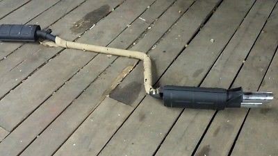

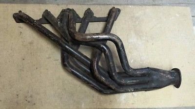

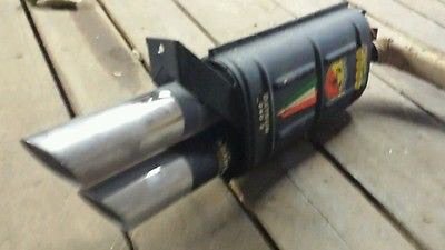

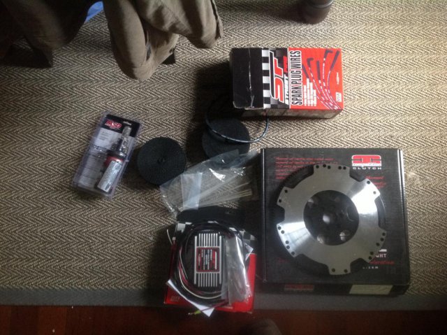

Parts Ordered/ Some I have:

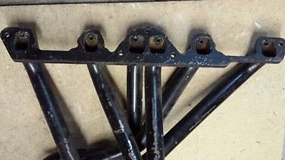

- Doug Thorley 6/1 Header.
- Abarth new old school full exhaust w/ middlemuffler and endmuffler (I was really excited to get this exhaust, if you have ever heard one, they sound awesome)
- MSD street fire box/ coil/ wires. (maybe not going on untill the MS install)

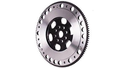

- Competition Clutch 13lb flywheel.
- 140amp alt and yellow top
Next I'll get the intake/ fuel rail/ injectors squared away.
Then from there I'll start working on this MS.
As far as a cam (Braaps Rec's), that will go on the next motor. This seems like a good solution to me so I can take my time and build the MS and a L28 the right way. It will also be good to have the bolt-ons in place to suport a well built L28 and have some experience with the MS on a stock motor.
I'll try and post some pics soon. I read about the flywheel and I went back and forth on doing it or not. Also thought about the 18lb lighten stock one vs. a 13lb or a 10lb. I decided the 13lb was the best for the range I will be building in.
Thanks again for all the knowledge and experience. I would have made different decisions with out the help and I had never even heard of MS.

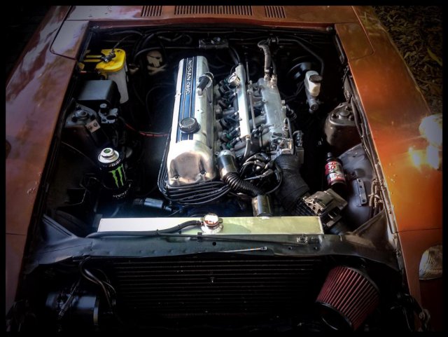

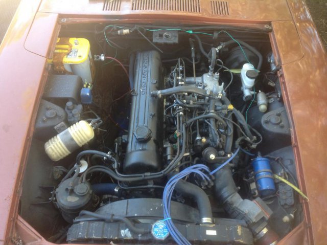

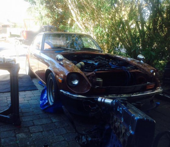

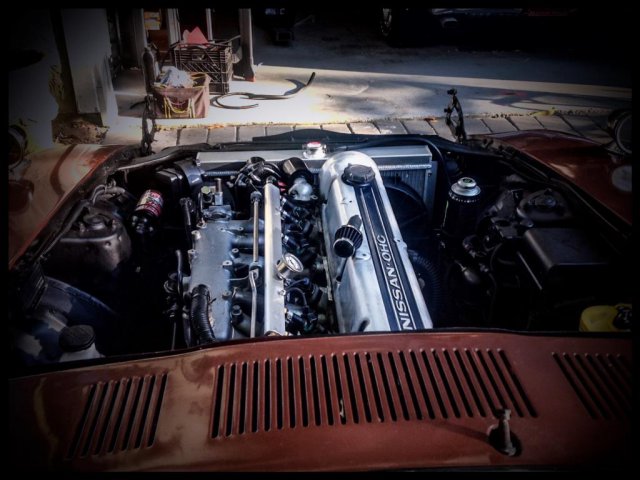

Edit: put some pics of the parts, one of the Z as it sits, and one of the motor before much was touched.

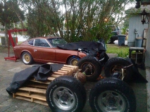

Also .. Heard people swapping the ford 9 rear axle. So I got a pair on ford super duty 10.5/ front 60 .. Thought I would put theses on next, ...might need a litte fender trim but they should be strong and wide. I attached a pic :-)

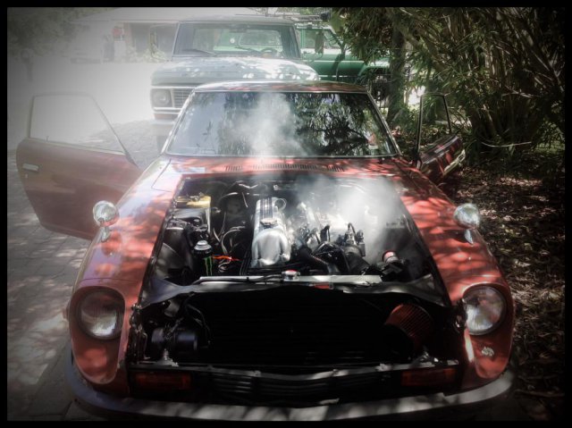

The mystery motor is pretty close to going in.
Header and exhaust are in the mail.
I decided to run the stock manifold and injectors for now. I think it will work best if I save the manifold, injectors and stuff all for the new head. That way I can put the new parts in with the right sensors for the MS and just do the Head/Manifold/injectors and fuel/ MS .. All in one swap over.

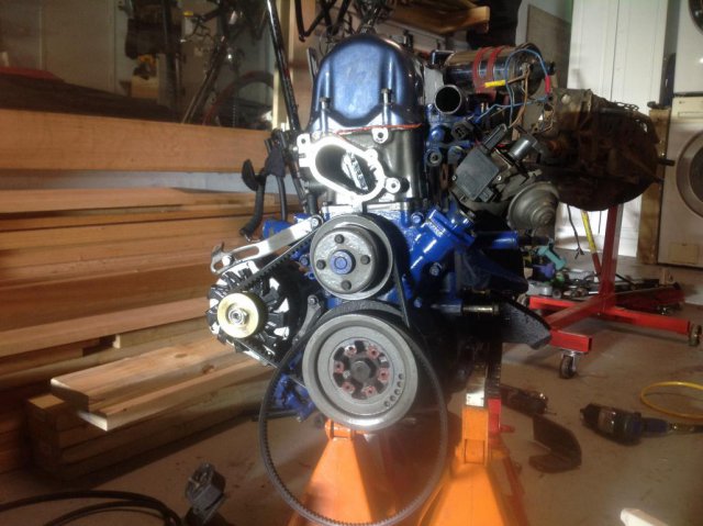

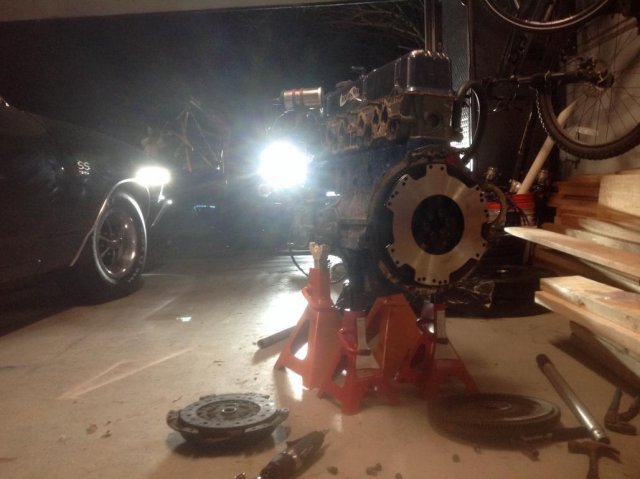

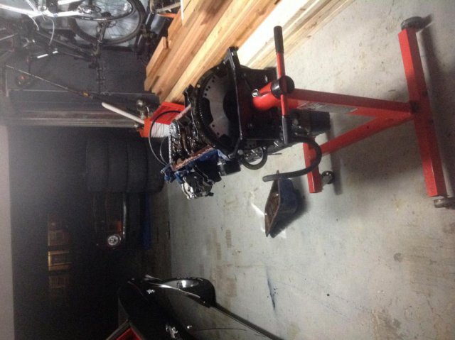

Here's where I'm at, attached are some pics.

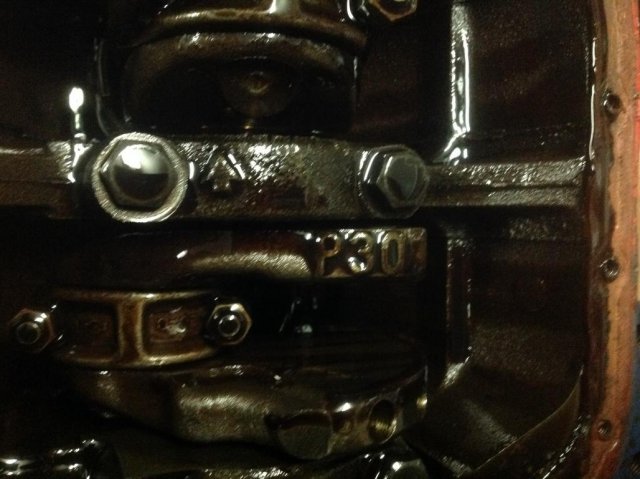

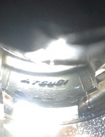

So I pulled the pan on the mystery motor.
The crank says p30. Isn't that a 240 l24 crank?
So this is an 83zx motor. The a cam marked K (maxima maybe or stock ZX) and a 240z crank? I'm confused.
The Pistons are stamped Atusgi, which I think are stock.
Edited by Project1
I don't know the block code on the Maxima L24's.  Probably the same as the ZX's, it's just a block, bored to size.  L24E with a P79 head?
I don't know L24 cranks either.  Measure the stroke and you'll know more if nobody posts in the mean time.  Measure the bore too.

I'll take a look. It's almost ready to go in so I almost hate to pull it apart too much.
The oil pan is different, however that might just be a N24 vs F54 thing ..idk.
The block is stamped L28. Is the maxima block stamped l28 or l24?

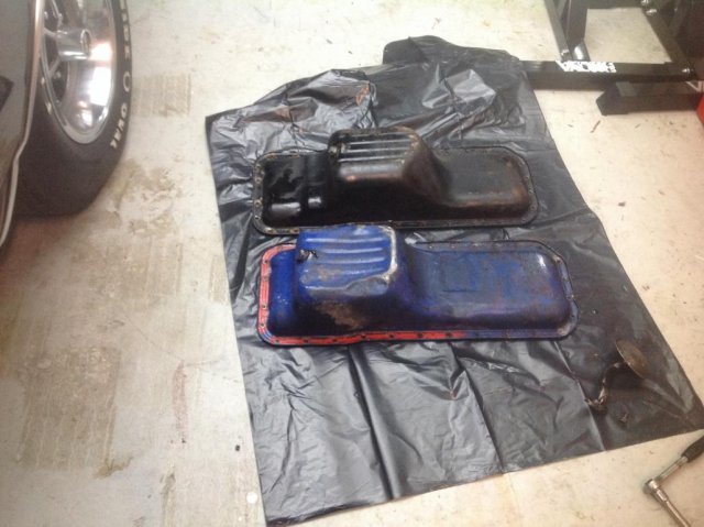

Any recommendations on which oil pan to run.
The black one is the one that was on my old motor. The blue one on the mystery motor. I know the oil pan is a tight squeze.
I guess I'll use the blue one, it a little beat up, but the inside looks fine

Actually, it could be a hybrid engine.  Some people think the L24 crank with L28 bore makes for better high RPM performance.  Back to measuring stroke.  http://www.zcar.com/forum/10-70-83-tech-discussion-forum/41844-long-short-stroke.html  Post #4.
And here.  He's built several. http://www.classiczcars.com/topic/39741-new-engine/
I'm just throwing ideas out there.
Edited by NewZed
Im guessing that's what it is. I got a chance to read the treads you posted, I think that's what it is. L24 crank and rods w/ stock l28 pistons. P79 head with a maxima cam. Edited by Project1
