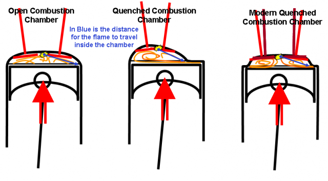

2 words, detonation threshold! If I had the time this morning I'd post all the details, sadly this morning. I'm short on time. :(
In short, the Datsun L6 is hypersensitive to detonate as mentioned in this thread already. On premium pump gas it does not like more than 9-9.5:1 compression ratio. Granted it should tolerate upwards of 10.5:1 premium on pump gas, but more often than not it doesn't and those combinations end up retarding the ignition timing so much that they lose more power from the ignition retard than they gained from bump in compression ratio. Mixing the flat top pistons with the N42/47 head generally results in engine that rattles on pump gas. There are many topic on that discussion in the L6 section.

ALL RPM's. It isn't just a narrow band, or the upper range or the lower. The detonation threshold across the entire operable RPM range from below idle to well above redline, under all conditions drops when the compression ratio is increased.
