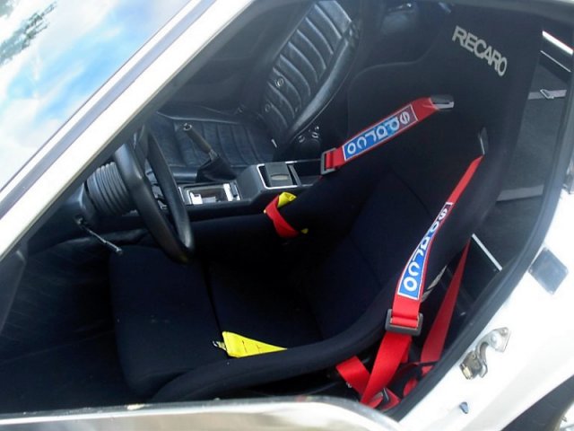

ryant67 Posted January 18, 2015 Share Posted January 18, 2015 For what it's worth, I used to have a Recaro Pole Position in my 240Z, and it fit perfectly. It was mounted on recaro rails, onto the stock seat supports. I only took it out because it was too much of a hassle to use day to day - difficult to get in and out of, and horrendous to swivel in when going through McD's drive-thru It was great for spirited driving though, very strong side support. Quote Link to comment Share on other sites More sharing options...
