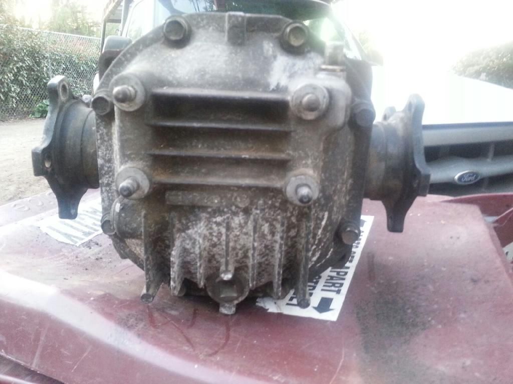

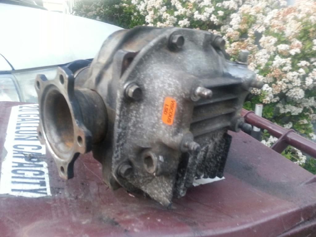

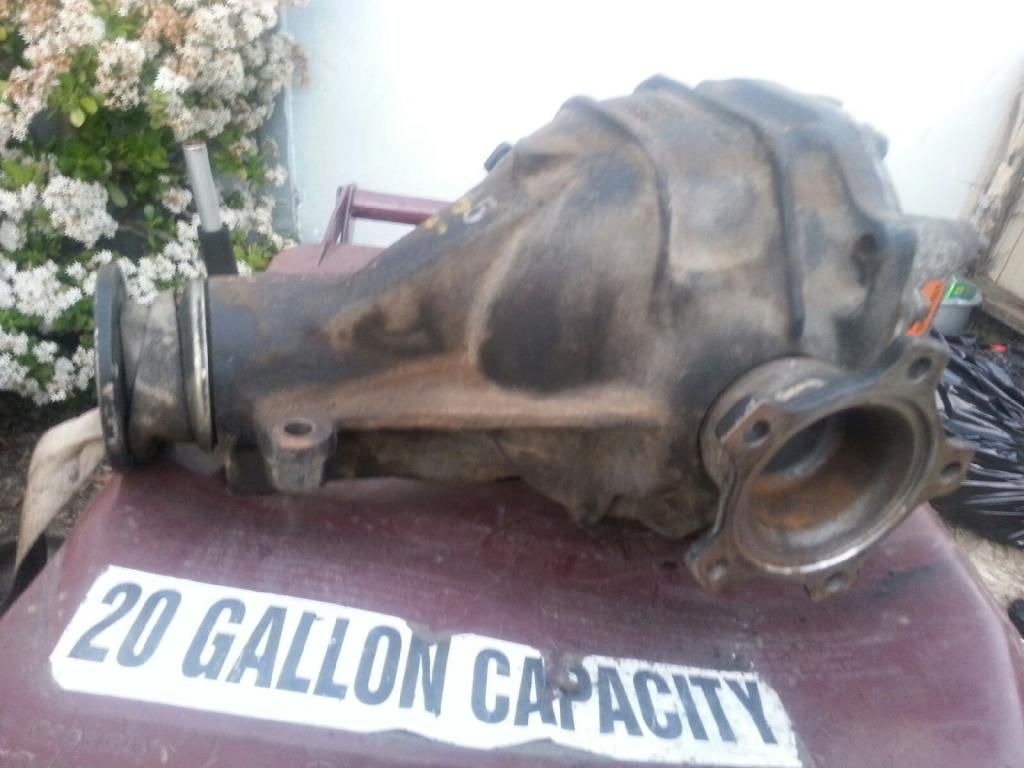

ImNtUrBuddyGuy Posted January 31, 2015 Share Posted January 31, 2015 Hello guys! I don't post here much, I am mostly a lurker but I need some of your expertise. I looking at a r200 LSD that the guy claims is off of a 1986 300zx--from all my research they only made the LSD from late 1987-1989. I am trying to find out if this guy mistook the year and I really have a genuine 87-89 LSD I could buy on the cheap, unfortunately I am not in the area where he lives so I can't check it out my self I only have pictures as references Could help me properly identify this. Thanks Quote Link to comment Share on other sites More sharing options...
nix240z Posted January 31, 2015 Share Posted January 31, 2015 looks like a r200 short 240sx rear end... Quote Link to comment Share on other sites More sharing options...
tamo3 Posted January 31, 2015 Share Posted January 31, 2015 It looks like short nose. Not from 300zx. Quote Link to comment Share on other sites More sharing options...
NewZed Posted January 31, 2015 Share Posted January 31, 2015 (edited) It says "VISCOUS LSD" on the orange sticker. And it's obviously a short nose. Looks like cheap on the cheap. I think that later 300ZX's, like 1990 on, came with short noses. Still a common, inexpensive diff that is not a bolt-in for a Z. Edited January 31, 2015 by NewZed Quote Link to comment Share on other sites More sharing options...
ImNtUrBuddyGuy Posted January 31, 2015 Author Share Posted January 31, 2015 Alright, thanks for the help. Looks like this guy really has no idea what he is talking about Quote Link to comment Share on other sites More sharing options...
