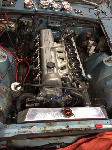

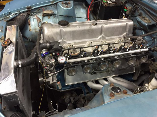

I have a 3.0l with jenvey ITB's and am running a aem infinity 6. I was wondering if anyone else was using the infinity & would share some of their maps. I just got it started yesterday & am just starting to tweak it. I would love a head start with a ignition map & fuel map start point. post-41676-0-75190300-1422849467_thumb.jpgpost-41676-0-75447200-1422849563_thumb.jpg post-41676-0-18959400-1422849975_thumb.jpg
Once the motor is finished & kinks worked out it will be pulled back apart for full soda blast & paint.

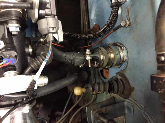

Thank you. Over 40 hours of strip, seal, crimp heat shrink. Each connector has a heat shrink lable on it with the device it's plugged into & the pin location at the ecu. Example (Injector 1 c1-31) the same at the ecu end. After 27 years repairing cars you have an idea what would be nice when trouble shooting a problem. It takes a lot more planing than I realized to make it really clean. The yellow wire hanging by the distributor is just temporary until I get the temp gauge wire I have in the circular connector connected to the gauge. The wire is all mil spec & the connectors are Deutsch with gold terminals.
Wow, you didn't mess around! Looks great.
