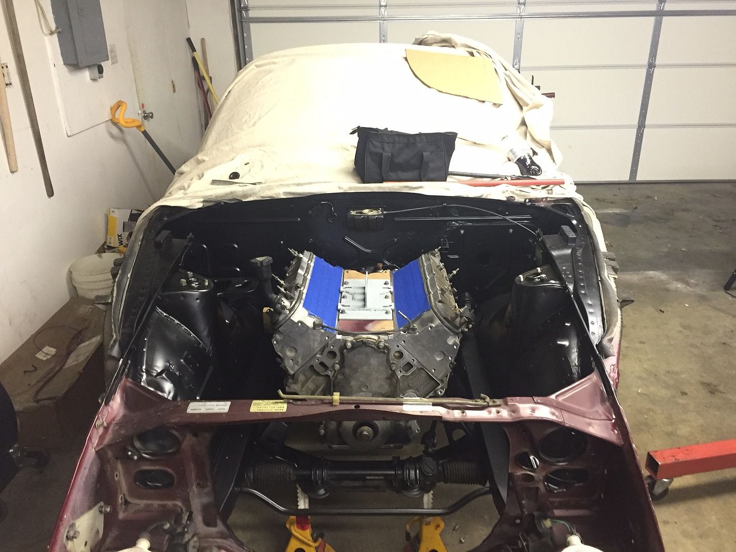

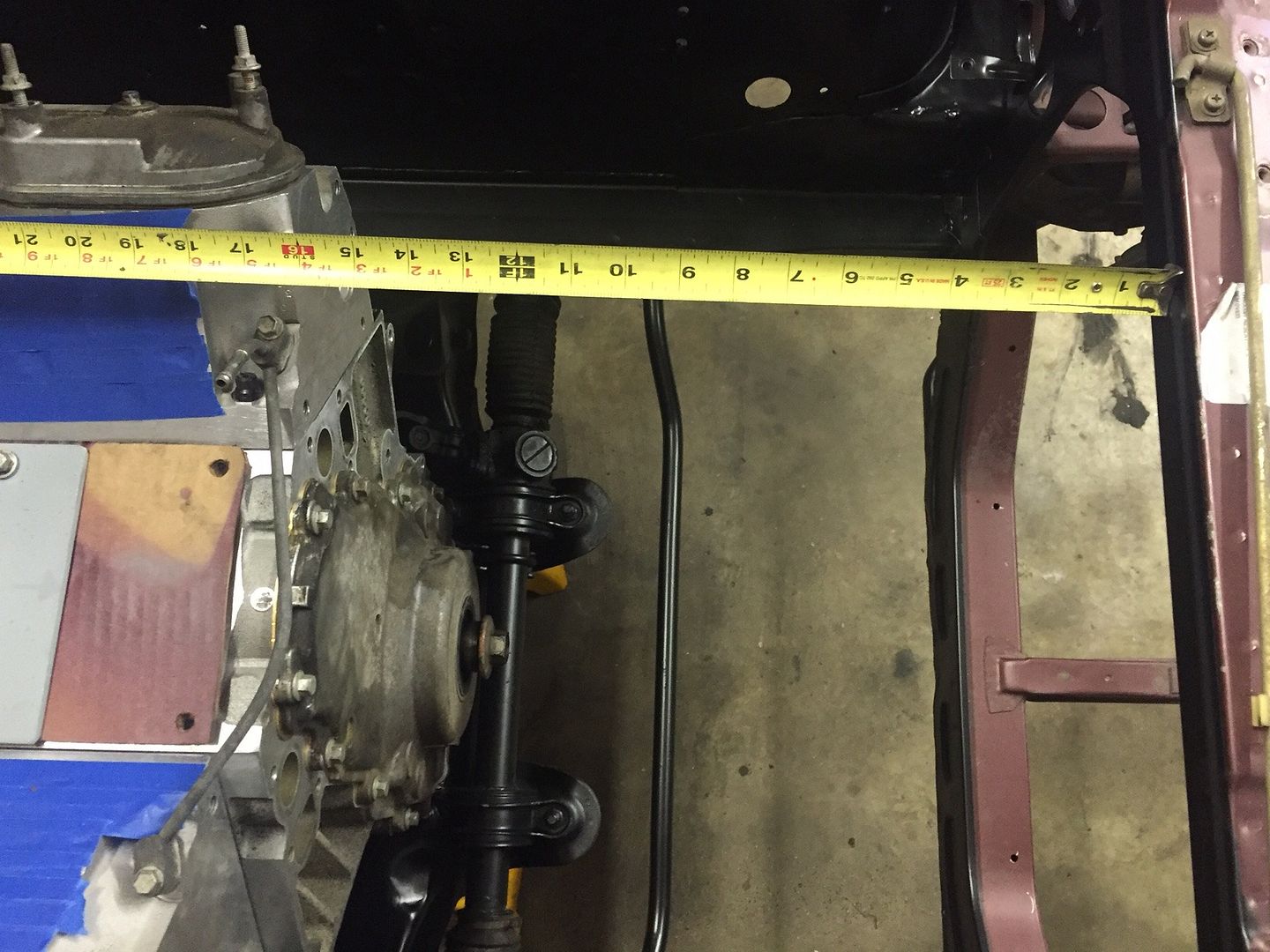

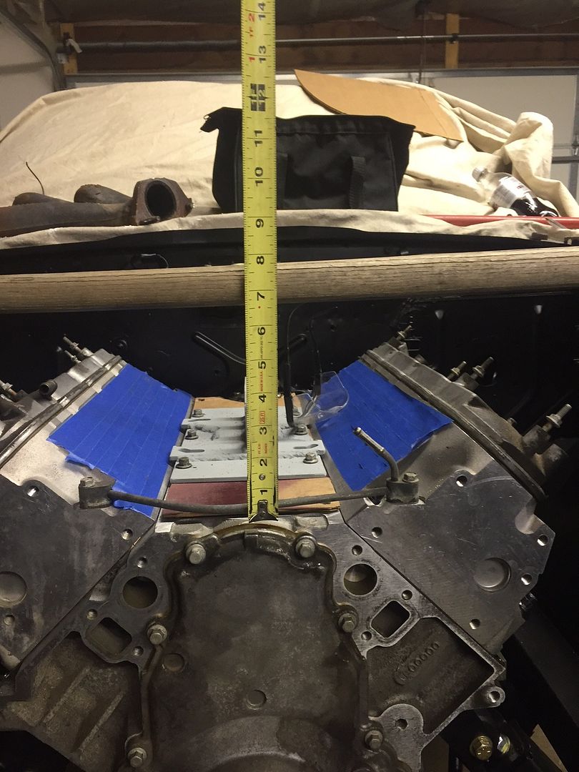

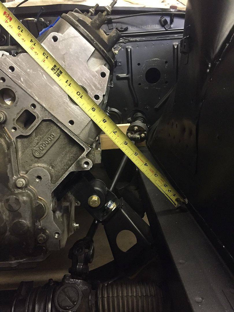

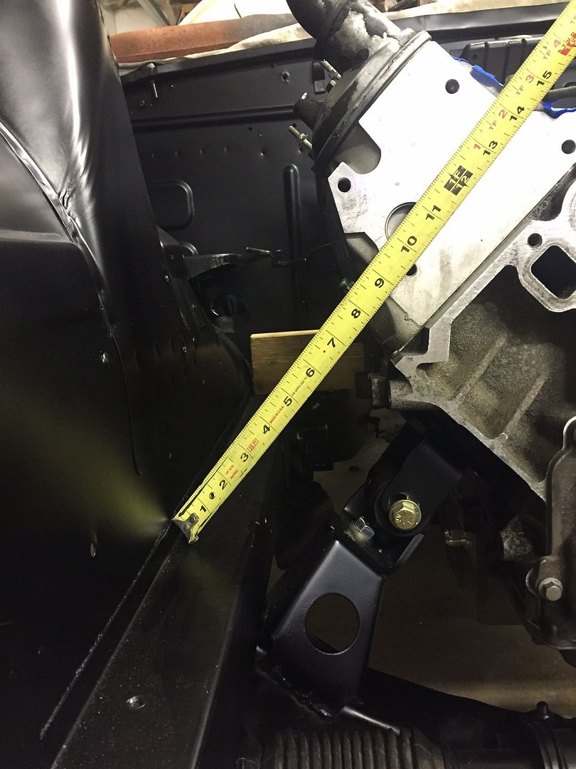

zspeed22 Posted December 14, 2015 Share Posted December 14, 2015 (edited) Test fitting my engine with the Dirty Dingo mounts. Took the pictures for myself then decided I could share them here. This is with the engine pushed all of the way back. No issues with steering. I am using a Fbody pan . Edited December 14, 2015 by zspeed22 Quote Link to comment Share on other sites More sharing options...
