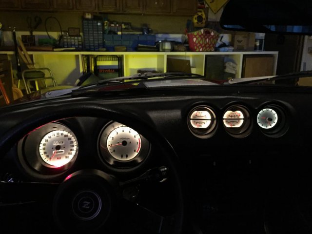

Phantom Posted November 2, 2015 Share Posted November 2, 2015 I kept the Datsun gauges but installed white face conversions and the higher wattage dash bulbs from Motorsport Auto and removed the green lenses. If you go with Autometer you'll not have all your gauges on the dash (Datsun has two split gauges) and you'll have to find another location for the turn signal indicators. If you stay with Datsun gauges you'll have to either get a CableX translator to drive your cable driven Datsun speedometer or you'll have to change the transmission over to a mechanical output. I went with the CableX and have had no issues with it in 12 years. Quote Link to comment Share on other sites More sharing options...
trackzpeed Posted November 2, 2015 Author Share Posted November 2, 2015 I was going to keep the split gauges and just replace the speedo and tach....... CableX is so freaking much$$$$ for what it is, it's hard to choke down. Who did you use, or how did you convert your tach to work with the LS1? Quote Link to comment Share on other sites More sharing options...

Phantom Posted November 3, 2015 Share Posted November 3, 2015 I was going to keep the split gauges and just replace the speedo and tach....... CableX is so freaking much$$$$ for what it is, it's hard to choke down. Who did you use, or how did you convert your tach to work with the LS1? My car was the JCI development car so Johns Cars did the tach conversion.j I've seen some other guys here on the site that used someone else. I just know John. I know what you mean about the $$. These cars can get really expensive to do it right - no matter which way you go. Quote Link to comment Share on other sites More sharing options...
CableSrv Posted November 3, 2015 Share Posted November 3, 2015 I went with speedhut's gauges for speedo and tach. Honestly love them and they cost about as much as the damn cableX cost. As for the others? You generally don't need a clock because aftermarket radios have them... or voltage/amps. Simple oil pressure and water temp and fuel level is all that is really needed. However I have a bluetooth obd2 reader so that I can see what my voltage is if I ever need to while on the road. Quote Link to comment Share on other sites More sharing options...

trackzpeed Posted November 3, 2015 Author Share Posted November 3, 2015 I looked at the speedhut too..... just not clear on what the ideal size is for speedo and tach. What did you use? Quote Link to comment Share on other sites More sharing options...
CableSrv Posted November 3, 2015 Share Posted November 3, 2015 I went with 4.5in for the 2 main ones, however they still require the old bezel of the old gauges. Not sure if the 5.5 ones would fit without that? I simply just took the 3 screws out of the old black scoops and removed the old gauge and then used tubing to press fit the gauges in. Quote Link to comment Share on other sites More sharing options...
