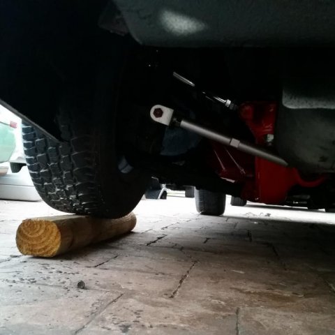

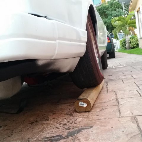

noilan Posted October 28, 2016 Author Share Posted October 28, 2016 (edited) That's not true lol When I bolted it up it was if anything too low Edited October 28, 2016 by noilan Quote Link to comment Share on other sites More sharing options...
calZ Posted October 28, 2016 Share Posted October 28, 2016 And your control arms are at a negative angle, which is not how the suspension was designed to run. Like 260DET said, getting it on and functional and having a grafted suspension that's in its proper ride height range are two very different things. Quote Link to comment Share on other sites More sharing options...
noilan Posted October 28, 2016 Author Share Posted October 28, 2016 They're at that angle in those pics with the stock s130 rear struts, on s14 coils they sit at proper angle and it doesn't ride like a boat anymore Quote Link to comment Share on other sites More sharing options...
TUME Posted October 29, 2016 Share Posted October 29, 2016 Pics please, with S14 coils. Also i'm curious what is your ride height with them? Quote Link to comment Share on other sites More sharing options...

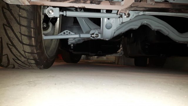

260DET Posted November 11, 2016 Share Posted November 11, 2016 (edited) I'm talking ride height with the suspension arms at the correct OE angles eg LCA should angle down towards the outside at ride height. Pic shows my race two seater's suspension at full droop but at ride height the LCA's (gold colour in the pic) still angle down. Edited November 11, 2016 by 260DET Quote Link to comment Share on other sites More sharing options...

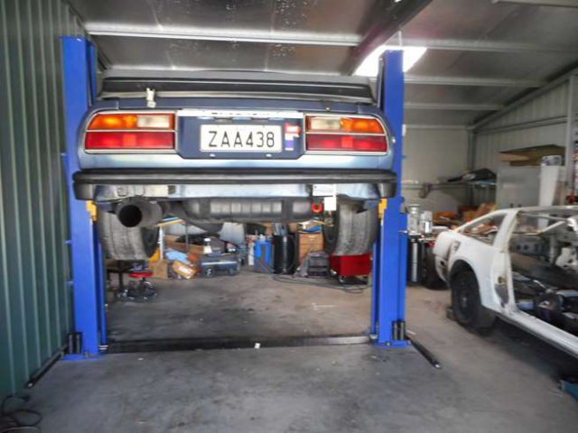

TUME Posted November 11, 2016 Share Posted November 11, 2016 So am I. Not sure who to You answered, but I´m still intrested noilans´s setup with proper coils. Just went to carage and take picture my (cars) ass, and it looked like this. I have ground clearance 13cm i.e 5in. Well it´s S30, but principle is the same. Quote Link to comment Share on other sites More sharing options...
