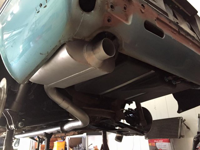

Blob1620 Posted August 14, 2015 Share Posted August 14, 2015 Hi All, Now that my car is road worthy and I'm starting to use it on a consistent basis, I've noticed that the muffler I chose for my exhaust is really far to droany for my taste and I was wondering if anyone had some suggestions for mufflers that sound good but dont make you hate life with your RB swap. for reference, I'm running an rb25 with a t3/t4 turbo, internal wastegate with a 2.5" v-band down pipe connector. I made the entire exhaust myself, v banded in 3 places, 2.5" from the turbo back with a single Thrush chambered muffler (flowmaster 40 ripoff) in the stock location. I've included a picture from when it was mocked up as the black coating makes pictures lack luster in the final installation. I chose that muffler since it fit really well in the stock location, i fear getting a longer one wouldn't work out due to proximity to the left rear wheel. So, what are you guys running and how do you like it? Quote Link to comment Share on other sites More sharing options...
BluDestiny Posted August 14, 2015 Share Posted August 14, 2015 If you just want to take the drone out, you need a glasspack or resonator somewhere under the car. Quote Link to comment Share on other sites More sharing options...
Blob1620 Posted August 14, 2015 Author Share Posted August 14, 2015 If you just want to take the drone out, you need a glasspack or resonator somewhere under the car. Yea, I like the tone, its just the in cabin noise thats getting me. I figured replacing a large portion of my mid pipe with a 24" glasspack might help a bit. Thing is, I had a 240sx with an rb20 and LESS muffler then this thing, and it sounded great and was almost stock level quiet. it just had a 2.5" pipe all the way back to a run of the mill ricer muffler. No extra resonators or anything like that. Quote Link to comment Share on other sites More sharing options...

Blob1620 Posted August 19, 2015 Author Share Posted August 19, 2015 I have a 24" resonator coming that I'll be adding to the mid pipe. I'll do a before after video. Another part of this is probably my engine mounts. CXRacing mounts, that aren't quite solid, but have very little bushing to reduce vibration getting to the chassis. I guess I'll see what the resonator does. Thanks for all the suggestions folks! Quote Link to comment Share on other sites More sharing options...

Blob1620 Posted November 23, 2015 Author Share Posted November 23, 2015 So, the 24" resonator and now a Thrush turbo muffler.... still super buffety at cruising speeds. WAY better then the two chamber, but way louder then my S13 was.... my just be insulation and the fact that the s13 had a back seat too. anyway, the solid mount I have on the diff cross member for a hanger location is going to get a rubber isolator next, hopefully that helps a bit. Quote Link to comment Share on other sites More sharing options...
