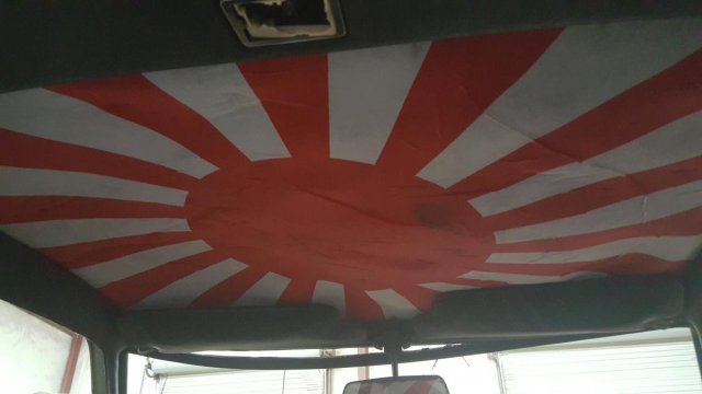

I haven't posted here in forever it seems like. A lot of you guys have yet to be introduced to the green Z unless you've seen it on Facebook. We picked it up actually to only rob the fenders from for the red one but I've ended up falling in love. It's a hardtop car whereas the red one has a sunroof. I attempted to make a new headliner for it where the factory one was torn up. post-42809-0-72427700-1439594402_thumb.jpg
