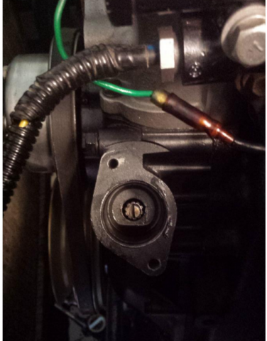

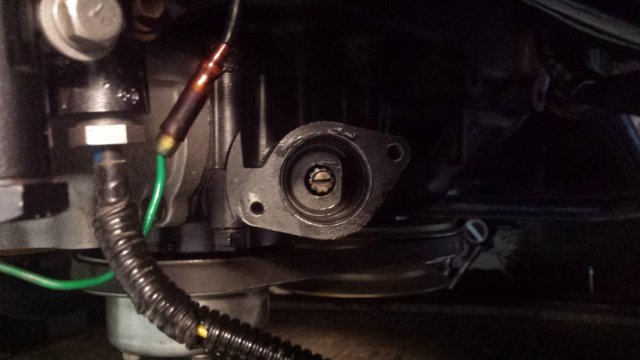

mainboyd Posted October 23, 2015 Share Posted October 23, 2015 (edited) Ok so I been searching for a few days now on why my distributor rotor is facing the complete opposite direction then where it should be. Long story short, I have a 240z with a L28ET motor and it was running perfectly 2 weeks ago, had it sit for a week then tried starting it again and all I got was back firing through the exhausts pipe and it did not want to start. Before having it sit for a week I was working on getting the distributor shaft perfect by dropping the oil pump and placing the shaft in the right position. This was done just before I had the z sit for a week. Anyways I decided to take the distributor cap off and noticed the rotor is facing completely the wrong way. I have no idea how it happened or if it was always that way. So I followed the manual and everything online that I can find to properly place the shaft correctly and I am positive that I have done that correctly. The only thing is that when I put the distributor back on the rotor is still facing the wrong way. Why?? And why would all of a sudden it won’t start? I verified that the motor is at TDC by looking at the two front camshaft lobes to see if they are pointing upwards and the notch on the crank pulley is at 0. Either way, I set the distributor shaft in the correct position so that is what should determine where the distributor rotor is facing/starting before even trying to start or run the car. Also, there is only one way the rotor can be bolted on to the shaft because there is only one tapped hole on one side of the shaft, the hole does not go through the shaft. I have attached pictures of how everything is set. sorry for the pictured coming out sideways. I dont know why they came out like that. Edited October 23, 2015 by mainboyd Quote Link to comment Share on other sites More sharing options...

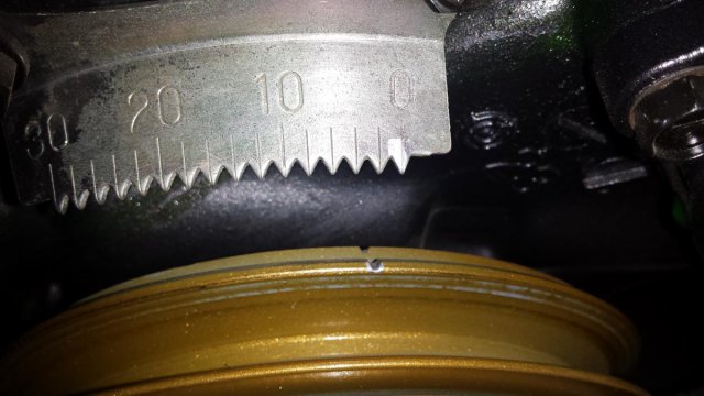

NewZed Posted October 23, 2015 Share Posted October 23, 2015 Sorry, I didn't really look at your pictures. What timing number were you trying to hit? Just curious, since you're working with the ECCS system. Quote Link to comment Share on other sites More sharing options...
mainboyd Posted October 23, 2015 Author Share Posted October 23, 2015 I was just trying to shoot for any number on the scale because it wasn't even hitting the scale, past the 30 mark when using the timing gun. Quote Link to comment Share on other sites More sharing options...
NewZed Posted October 23, 2015 Share Posted October 23, 2015 Since you're rotor is way off, the plug wires may have been rotated to make the engine run. You might try using different plug wires to find the new "#1" wire. Since the engine runs right, one of your plug wires will probably give you a light in the range. I can see why you decided to mess with it now. You might be able to still set timing, just in a non-spec. way. Quote Link to comment Share on other sites More sharing options...

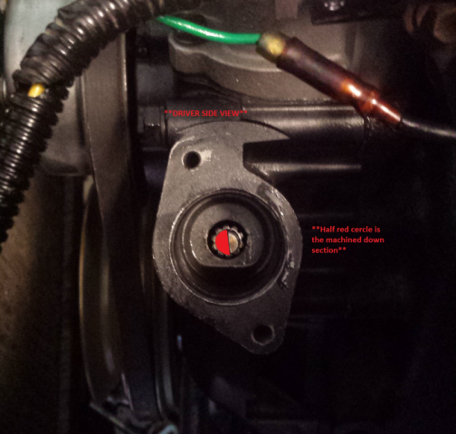

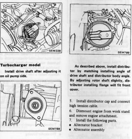

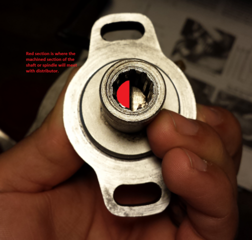

mainboyd Posted October 24, 2015 Author Share Posted October 24, 2015 (edited) I suggest you start over. Put cylinder #1 exactly at TDC and go from there. Well lets take a step back and think about this here. First what I am trying to figure out is why my distributor rotor is off 180 degrees. Lets leave "TDC" out of the equation for now because, and correct me if I'm wrong, the motor does not need to be at TDC if I'm trying to determine why my rotor is off. If you think about it, the placement of the rotor is determined by the placement of the shaft. Technically the shaft can be placed in any position (but there is only one correct position if wanting the car to start). So by taking "TDC" out of the equation it makes it a little easier to find out why the rotor is facing the wrong direction because we are not having to worry about if we are at TDC any more. So by looking at the three pictures I put together on this specific post I have made it a little easier to see where my shaft is placed by making the important things to realize in RED. Now when looking at the pics I believe that the shaft is in the correct position according to the manual and what I have searched for online. However, when I place the distributor on, the rotor is then pointing in the wrong direction (keeping in mind that the distributor can only fit one way due to the machined end of the shaft and of the distributor). AND THIS IS WHAT LEADS ME TO WHY I STARTED THIS TOPIC. Edited October 24, 2015 by mainboyd Quote Link to comment Share on other sites More sharing options...
NewZed Posted October 24, 2015 Share Posted October 24, 2015 The simplest answer (Occam, Einstein, KIS, whatever) is that somebody pounded/manipulated your rotor on to the distributor shaft 180 off. Remove the rotor from the top of the shaft and see what's under there. Consider what connects the top of the shaft to the bottom, on a ZX trubo CAS/distributor. Never had one myself so don't know how they're put together. Quote Link to comment Share on other sites More sharing options...

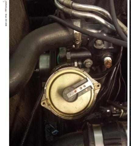

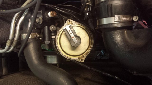

NewZed Posted October 24, 2015 Share Posted October 24, 2015 Rotated your first pictures just to show what you're talking about. The oil pump drive quill looks right but the top of the CAS shaft with the rotor is 180 off. It's either the rotor or the top of the CAS shaft that's not right. If the bottom fits, that's all that's left. Quote Link to comment Share on other sites More sharing options...
NewZed Posted October 24, 2015 Share Posted October 24, 2015 Actually, looking at the pictures, it looks like the rotor is more like ~160 degrees off, not 180. Hard to be sure since the pictures aren't from exactly the same position. Something weird with the CAS shaft or the rotor fit. Quote Link to comment Share on other sites More sharing options...
