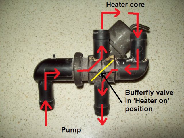

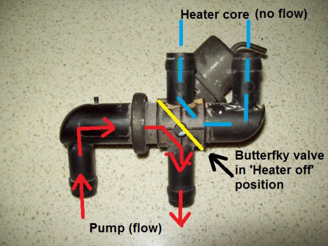

Boy from Oz Posted October 26, 2015 Author Share Posted October 26, 2015 (edited) I actually want to use the heater so blocking off at the pump is not an option. Jay, I retained the valve from the donor car (see attached) but like the replacement valves it is vacuum operated whereas the the Vintage Air valve is electronic. What I really want to know is whether blocking both inflow and outflow to the heater core, and creating a return loop, critical in LS1 systems? Edited October 26, 2015 by Boy from Oz Quote Link to comment Share on other sites More sharing options...

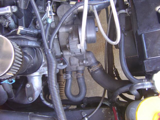

EastTnZ Posted October 26, 2015 Share Posted October 26, 2015 (edited) I'm hearing this... Summer time- use a short piece of heater hose and redirect the outlet and inlet from the waterpump to itself and loop it (not plug it completely). This gets rid of heat creeping through the hoses. Insulate the firewall. Winter time- reconnect the heater hoses to the firewall so you can have heat. Problem solved The only time this happened to me was because the heater control valve didn't work and was stuck wide open. Couldn't get the air below 55ish out the vents. Put a vise grip on one of the heater hoses and bam 30 degree air. It was July or August and it worked great! Edited October 26, 2015 by EastTnZ Quote Link to comment Share on other sites More sharing options...

Phantom Posted October 27, 2015 Share Posted October 27, 2015 If I understand the original question you're asking whether to use a basic 2-way (open-closed) valve or a 3-way (open-bypass back to source) valve. Either will work but I personally prefer the simper 2-way valve. It stops flow when no heat is required rather than redirecting the flow back the the engine. The stock Z valve is a 2-way valve. That is the valve I'm using with the heating system in my LS1 280Z. Works just like it did with the L28 in the car. Is it possible that you're over thinking the installation? Quote Link to comment Share on other sites More sharing options...

Phantom Posted October 27, 2015 Share Posted October 27, 2015 Evidently the LS1 doesn't need continual water flow through the heater lines as mine has the stock Z heater control valve that stops flow. I've driven it 38k miles, most of it in hot Texas weather, and have never had an issue. Quote Link to comment Share on other sites More sharing options...
