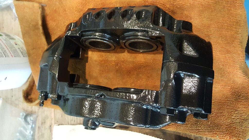

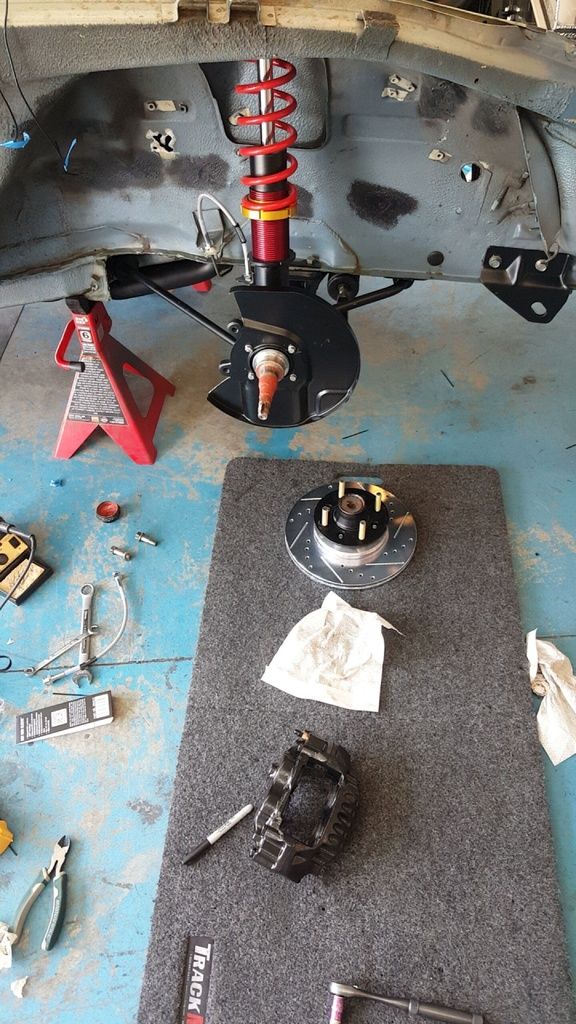

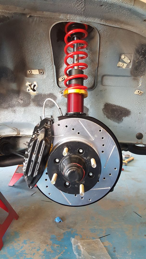

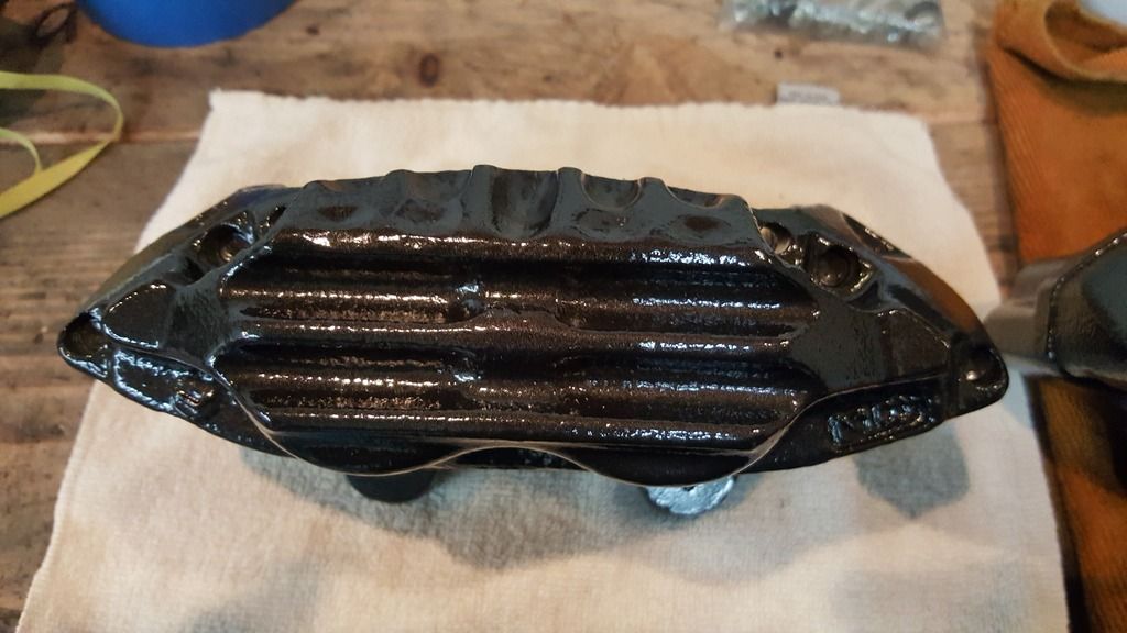

Stock Car Mafia Posted May 10, 2016 Author Share Posted May 10, 2016 Spend a few minutes throwing some paint on the calipers. They turned out ok, but they are going to be very subtle with how much dark/black paint that are on the car. I was going to paint them red which would make them contrast really well but wanted to do something a little different. I chose the alloy gray metallic that is the same color as the Mustang and Datsun valve covers. Quote Link to comment Share on other sites More sharing options...
Stock Car Mafia Posted May 11, 2016 Author Share Posted May 11, 2016 (edited) Updated suspension/drivetrain goals: 1. Get struts sections and welded up. 2. Remove old bushing, ball joints, and tie rods. 3. Send parts off to powdercoater. Still considering colors for this. Black or a medium gray to change it up. Have brother sandblast. 4. Scuff and paint suspension. VHT Rollbar & Chassis satin black. 5. Install front wheel bearings. 6. Replace one rear inner stub axle bearing. Ended up replacing both. 7. Install new bushings. 8. Tear in to the R200 CLSD and check tolerances and install the new clutch discs. 9. Swap open R200 pinion flange on to CLSD R200 pinion. 10. Wait for Chequered Flag Joe's shortened axles and 27 spline flanges. Rebuild axles and assemble rear drivetrain. 11. Cut front spring perch for camber plates. 12. Reassemble. This should wrap up this upgrade so I can move back to the motor swap: 1. Install clutch MC 2. Install brake MC and adjust push rod. 3. Weld up engine bay holes. 4. Find firewall plugs or weld in patches. 5. Drop in motor. 6. Fab and weld up exhaust. 7. Find solution for steam vent. 8. Mount and wire gauges in dash. 9. Wire up engine harness. 10. Make battery cables. There are still a few things I need to obtain: - Vacuum tee - Driveshaft bolts - Nut Serts and welting for flares - 18 gauge sheet of metal to tin off the gas tank - front brakes lines and bending tool - Diff. fluid - Trans fluid - Weatherstripping for tach and speedo - Speed bleeders - Seamsealer - Fish scale - Extinguisher This week is busy at work so I hope I can get a few things done. Edited May 17, 2016 by Stock Car Mafia Quote Link to comment Share on other sites More sharing options...

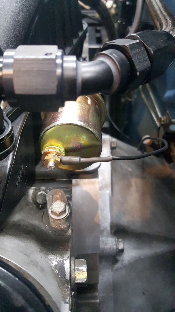

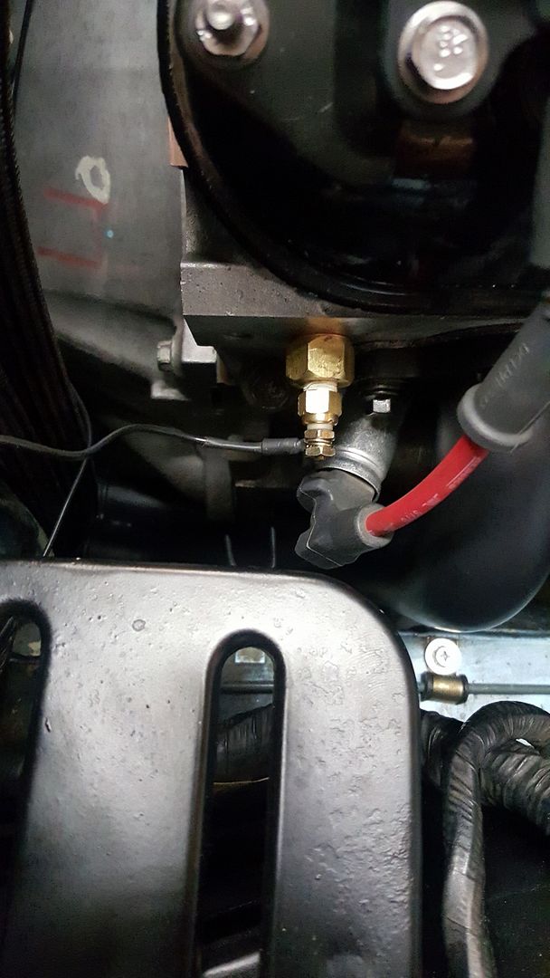

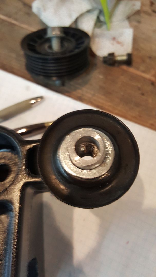

Stock Car Mafia Posted May 14, 2016 Author Share Posted May 14, 2016 Not much happened last night except for getting a lot of misc. shit and wiring goods. I noticed the alternator pulley was off by about 1/8" when I had my motor assembled last so I bought a washer and drilled it out. I did end up putting it on the back side underneath the black pulley washer. The coolant temp and oil pressure senders got wired up in to the car. I am going to use O-ring terminals on both ends and tighten it to the gauge. Then throw a quick disconnect of some sort in between the dash and the wire inside the car so the dash can easily be pulled out. Quote Link to comment Share on other sites More sharing options...

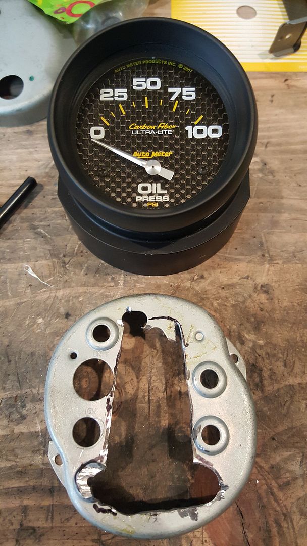

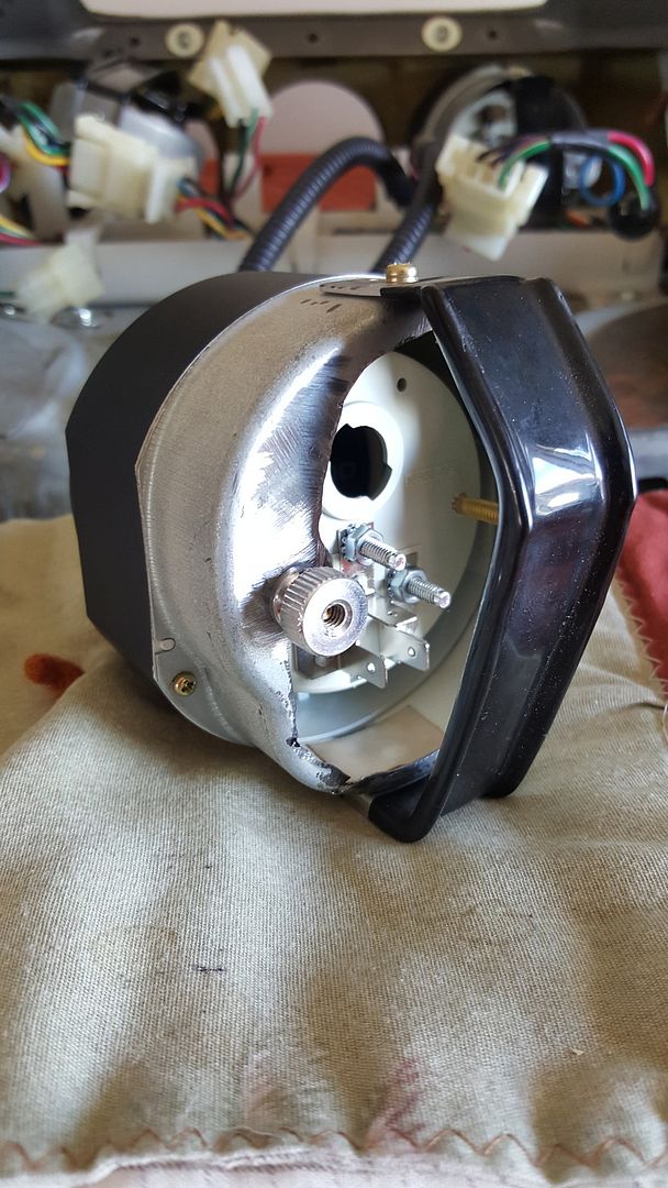

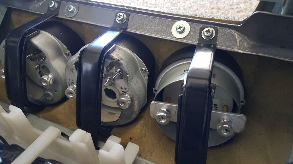

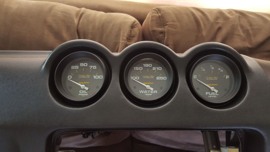

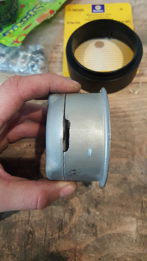

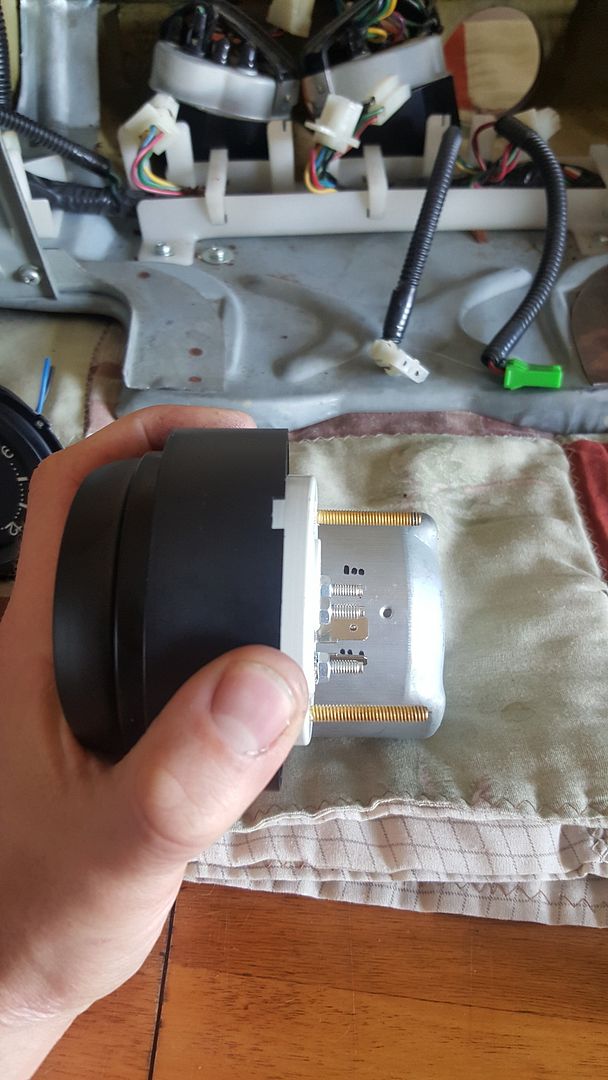

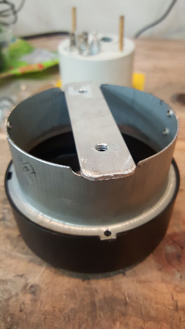

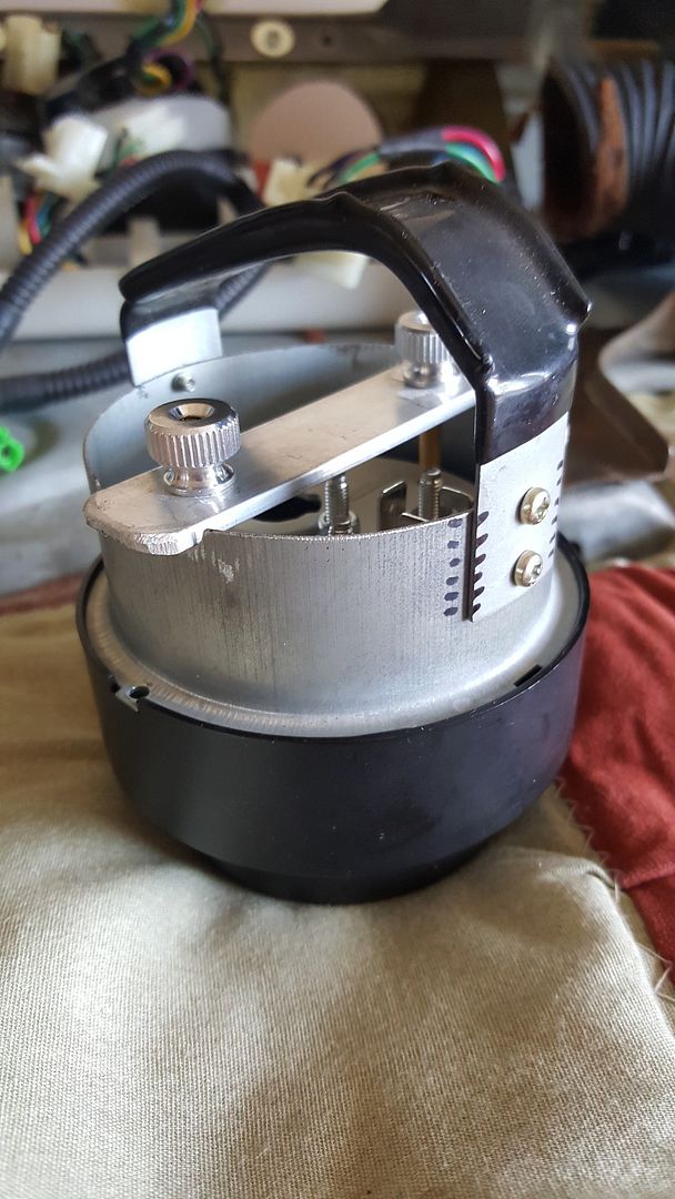

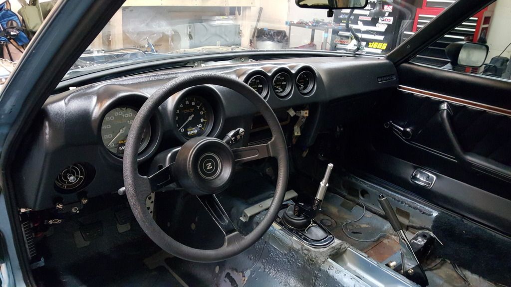

Stock Car Mafia Posted May 15, 2016 Author Share Posted May 15, 2016 I spent some time on Friday fabbing up the mounts for the 3 pod gauges. I decided to put them in order from left to right: Oil Pressure, Water Temperature, and Fuel Level. After some thought I didn't want to **** with making new brackets for the most part and chose to gut the stock housings and use those for somplicity. The hardest one to determine to mount was the clock housing. It is much deeper than the other two and the threads of the autometer gauge wouldn't stick past the back. I ended up cutting the back portion off. I cut right above the 2 screw holes for the back gauge bracket. I then cut out a groove for some aluminum strap to sit across for the gauge to bolt to. I cut some aluminum and drilled the holes for the gauge. I had to do this because there still wasn't enough clearance to get the aluminum brace and nut on the threads. Here is the gauge all mocked up. Turned out really nice. The other two gauge housings worked just fine. All I had to do was get them roughly centered, drill the holes for the gauge and cut out a section so the lights and wire hookups could be accessed. It's not shown in this picture, but all the holes that were cut, were cleaned up so they aren't sharp and won't cut any of the wires. The clock/fuel level gauge didn't fit really snug when bolted down and could be turned slightly. I fixed this by adding a little 3/8" weatherstripping. And the great thing is they bolt in the stock location. It definitely turned out nice and didn't take to long to get put together. Quote Link to comment Share on other sites More sharing options...

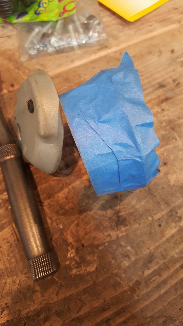

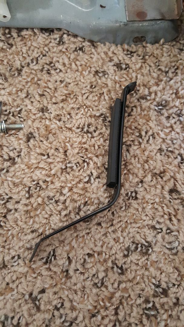

Stock Car Mafia Posted May 15, 2016 Author Share Posted May 15, 2016 Today I ran and got some 7/16" weatherstripping. I was recommended to use 3/8" and then make some brackets but this was the only size that was available at O'Reilly and I am hoping to get away with just having them pushed in snug. I wrapped the gauges right behind the bezel and pressed them on so the adhesive would stick. This was a 5 minute job and now allows me to fine tune them to where I'd like them. I want them as far back as I can get them. If I ever get happy with the location I have them positioned, I can then take the dash back out and fab up some mounts. Today I hope to get most of the wiring done, except for the battery cables which I may be able to do tomorrow. Quote Link to comment Share on other sites More sharing options...

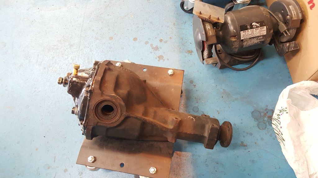

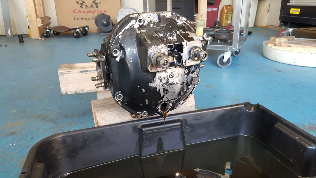

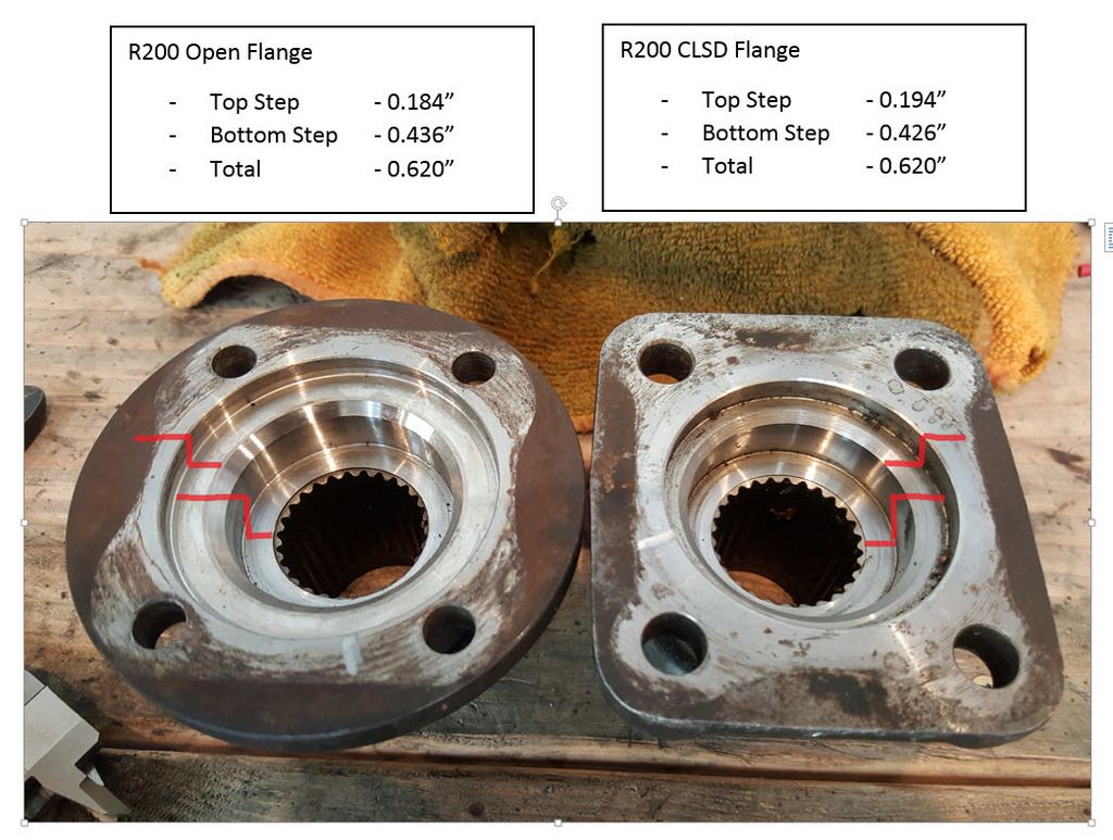

Stock Car Mafia Posted May 19, 2016 Author Share Posted May 19, 2016 I took the time to swap the flanges last night. Both flanges were the same height. The best way I found was to measure the depth of each flange to determine how thick the flanges are. Both were slightly different but came out to the same thickness of 0.620" The tool is not pretty but extremely functional for holding the flange while the nuts are loosened. I did get the larger 250 ft.lb. torque wrench so this made the job easy. The breakaway torque for the CLSD flange nut was 182 ft.lb.. The nuts were marked as well to realign them when retightened. I drained the open diff so I could swap the cover on to the new one. Now instead of a paint shop, the garage smells like diff fluid. The pinion nut was tightened to the torque that broke it and the nut lined right back up. I threw some blue loktite on the nut as well. I plan on scuffing and painting the diff. before it goes in. I was able to get a vacuum tee so I could tie together the vacuum coming from the inside and the fuel pressure regulator to the back of the intake. I also got the radiator hose fitting so I could get the steam vent hooked up. I marked the hose as to where I would make my cuts. The 1/4" hose will run under the intake. I need to pick up some decent hose clamps. I broke the cheap ones that I had laying around. Last but not least, I wrapped up the tach wiring and started on the speedo late last night. Two questions are left hanging: - How important is it to install a "fast-acting fuse" for the tach and speedo? - Which color wire running to the tach is the power wire? The only info in the service manual is the illumination wiring. There is a green wire running to power the bulb I believe for the "brake" bulb. Is this one switched 12V? Quote Link to comment Share on other sites More sharing options...

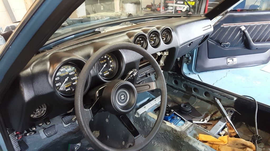

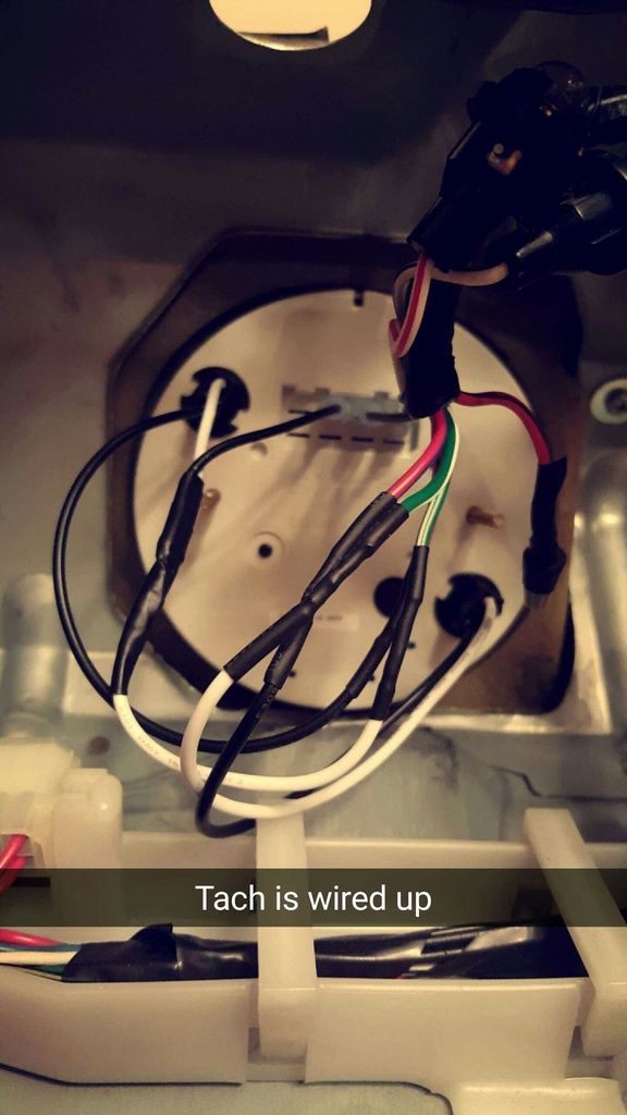

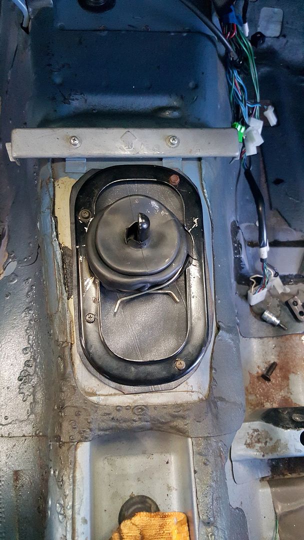

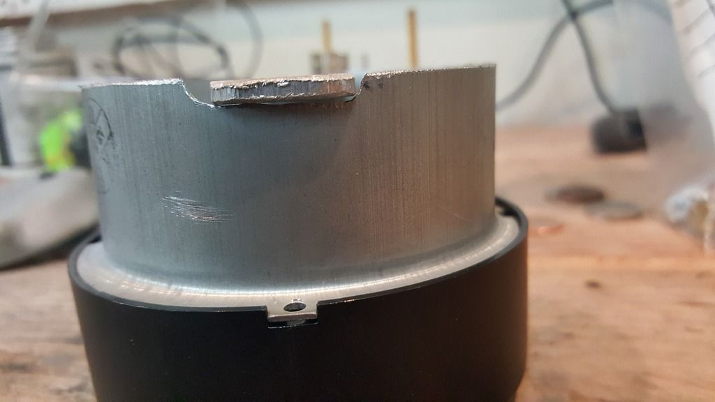

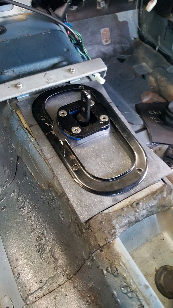

Stock Car Mafia Posted May 20, 2016 Author Share Posted May 20, 2016 I got the speedo wiring finished and the dash put back in the car. I will have to say it does kind of suck putting the dash in by yourself. I loosened the steering column bolts to make it easier to get the dash in. I also found some thin rubber at work in just the right size to make a shift boot for the car. I made some basic measurements to see where the shifter would fit through the rubber. The B&M rubber cover and clamp came off for this. Then I left an extra 1/4" or so so it could fit snugly over it. I laid the stock boot retainer over it to line up the screw holes and make some marks. The retainer was too small for the shifter so I had to cut and dye grind out material on both size to make it line up. Then I cut out the shape of the retainer leaving 1/4" hang off. The B&M boot and clip got installed prior to this. I had to pound down the passenger side of the retainer to it would fit tight. I might have to take this back off and contour it a little more. I'm hoping this keeps the dust out of the car! I then was going to install just the straight shaft for the shifter but the guy must have red locktit'ed the bolts and I broke two allen wrenches trying to free them. Quote Link to comment Share on other sites More sharing options...
Boben Posted May 20, 2016 Share Posted May 20, 2016 The dash looks really good. Quote Link to comment Share on other sites More sharing options...

Stock Car Mafia Posted May 21, 2016 Author Share Posted May 21, 2016 Thanks Boben, I am very pleased with how it turned out. Let's just hope that dash doesn't have to come out again. auxilary, I hope to have it running and driving soon. Quote Link to comment Share on other sites More sharing options...

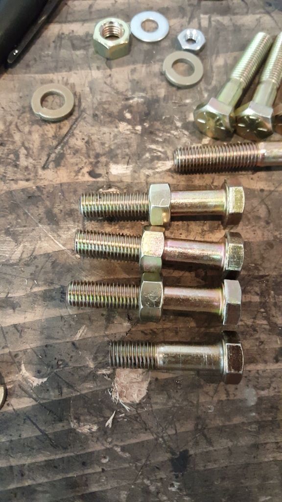

Stock Car Mafia Posted May 25, 2016 Author Share Posted May 25, 2016 I can't post in the drivetrain thread nor find the information for this from any of my searches... Joe does not provide the bolts for his flanges for the Z31T axles. Does anyone know the thread pitch and length of the bolts that are needed for these? Quote Link to comment Share on other sites More sharing options...
