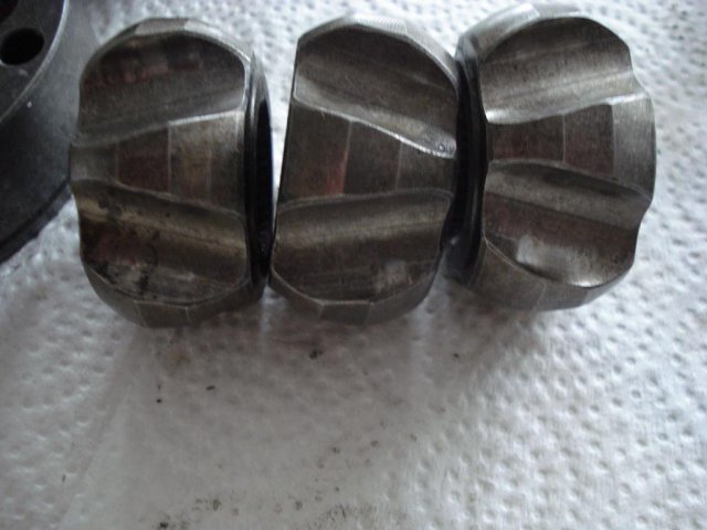

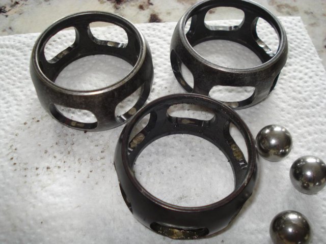

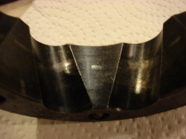

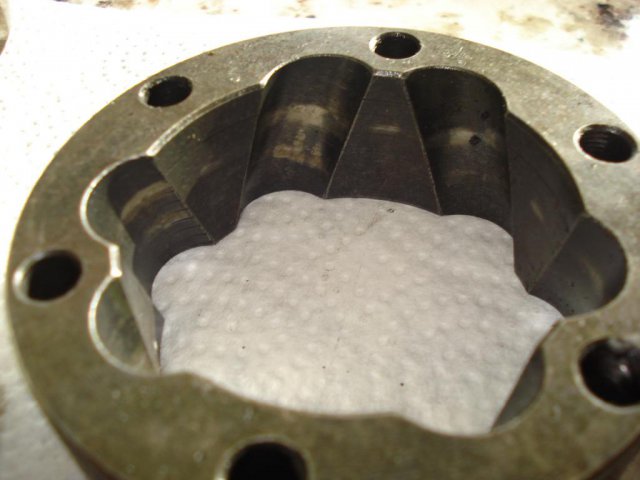

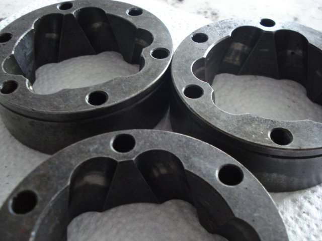

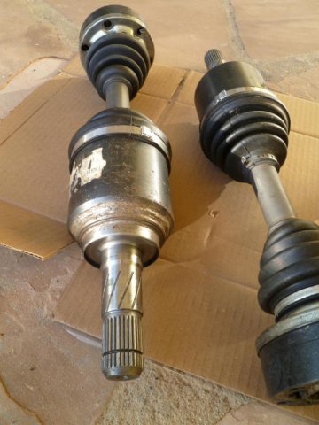

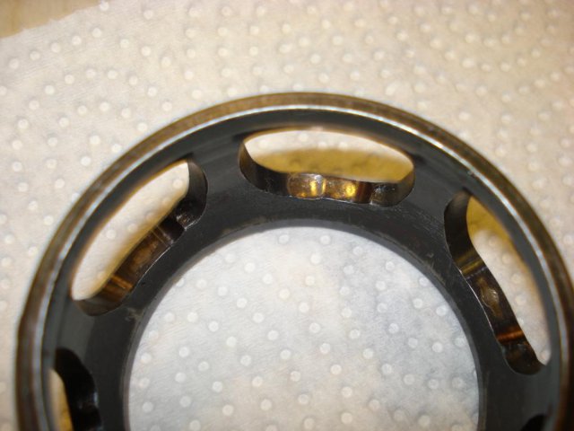

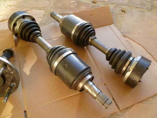

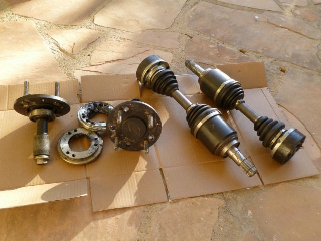

DREW RBZ Posted November 21, 2015 Share Posted November 21, 2015 (edited) I wanted to add my 2 cents to this thread in relation to the wolf creek racing "porsche style" cv axle kit. I installed these on my car and have done approximately 2000 miles since. I had always been aware/annoyed of the amount of "slop" or play in the rear end since installing these axles and the play seemed to get progressively worse with added mileage. I run new quaife 4.11 differential with chequered flag racing chromoly stubs. Diff is supported by a ron taylor diff mount on top and stock mount on bottom (no movement). Driveshaft is custom with new upgraded u -joints. This car is not drag raced and I do not do hard launches for the record. Fast forward to last week. The rear end was getting very annoying...letting off gas/ starting off would result in more play/slop in the rear end and there was a bit more noise from the rear end. I decided to pull the rear end and have things checked out. The diff and diff bearings are perfect...the driveshaft and joints are perfect...the diff mounts are solid. So I pulled apart the CV axles and found that the "Porsche style" CV cages were chewed up and worn/pitted badly. Took the assembly to a local CV shop that does custom work for various high performance cars. The tech advised that the CV axles had damage to the CV's in particular the cages which in his opinion were not high quality. (Wolf creek racing states on their site that they use chromoly cages with hardened races???). I thought this would be of interest to those considering this setup. I would not recommend the wolf creek racing axle kit, especially you V8 high torque guys... Here are a few photos of one of the disassembled CV's with photos of the damage and a diagram of a CV and related bits. Edited November 21, 2015 by DREW RBZ Quote Link to comment Share on other sites More sharing options...
Rob L Posted November 21, 2015 Author Share Posted November 21, 2015 ^^^ solid info Quote Link to comment Share on other sites More sharing options...

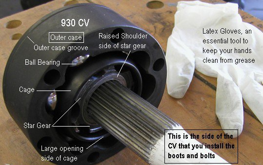

NewZed Posted November 21, 2015 Share Posted November 21, 2015 Here are a few photos of one of the disassembled CV's with photos of the damage and a diagram of a CV and related bits. Could it be that the shaft was either too long or too short? Looks like the balls were getting forced to one side of the cage. How does the other cage look? And the balls. Quote Link to comment Share on other sites More sharing options...

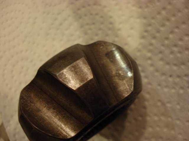

DREW RBZ Posted November 21, 2015 Share Posted November 21, 2015 All four cages have similar damage. The damage is also to both sides of the cages. The balls themselves appear to be in fairly decent shape but do feel a little rough (very small scratches/pitting). The star gears and outer cases show some minor sign of wear (shiny areas). It appears that these cages are the weak link in the CV however I do not profess to be any kind of expert in this field. Here are a couple more photos: Quote Link to comment Share on other sites More sharing options...
NewZed Posted November 21, 2015 Share Posted November 21, 2015 Here's some good stuff on cage materials. Apparently there's some compromising involved depending on application. I wonder if a new cage would get you back to where you started, or if the races and balls have too much play due to wear. #4. http://driveshaftshop.com/blog/?p=567 The fact that the cages are worn on both sides makes you wonder also though, if there was enough travel available in the first place. Just wondering, don't know much. Quote Link to comment Share on other sites More sharing options...

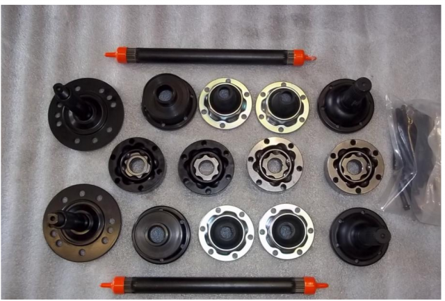

CHEQUERED FLAG JOE Posted November 22, 2015 Share Posted November 22, 2015 (edited) Hi Guys, here is some info I think might help. Made by the same manufacture that has been making my other parts. My CV kit for the Z car actually started out as a CV kit for the Datsun 510 with a R200 that was designed to replace the weak parts in the 510. I had it build for the Z car as good axle parts are very hard to find. Keep in mind this is a bolt in kit no modifications needed. If you are using adjustable lower arms and your car is 1 inch wider I can get you axles 1/2 inch wider. I have sold 3 kits for the 510 and 5 for the Z car. I have had no contact with the customers as far as any problems what so ever. As for the CVs they are chromoly with 300M center section. They are not cheap you can buy cheaply made 930 CVs for $40.00 or built right for $220.00 mine are the $220.00 version. The CVs are 28 spline plunging units. Any other questions please feel free to contact me I always answer the phone. Please keep in mind I'm in California. Happy Holidays Joe Edited November 22, 2015 by CHEQUERED FLAG JOE Quote Link to comment Share on other sites More sharing options...
