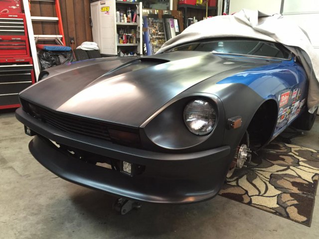

Smyrna388Z Posted December 21, 2015 Share Posted December 21, 2015 (edited) After a lot of work, I have finally got a cowl hood installed on my 280Z and wanted to share the results. Note: this hood is not a bolt on. Modifications were made to the front and rear of the scoop (personal preference), the front of the scoop was cut out, all four corners and the rear/back edge were glassed and shaped for improved body lines. The bracket attachment tabs were drilled, cut and spacers used to center the hood. I also cut material from the rear cross brace and filled with expandable insulation to add strength. I cut the material for a cleaner look and improved opening for cowl induction airflow. A lot of hours sanding, cutting and shaping gave me the rusults in the post. The paint is a brushed flat black from a 'rattle' can. The hood was purchased from Robert through 280Zone@cox.net Edited December 21, 2015 by Smyrna388Z Quote Link to comment Share on other sites More sharing options...
Jay Gadsby Posted December 21, 2015 Share Posted December 21, 2015 Looks great! Adds quite a bit without being too much. Quote Link to comment Share on other sites More sharing options...

gnosez Posted December 23, 2015 Share Posted December 23, 2015 Is that a train horn? If so do you have a lot of folks that drive slow on the track? I really like the look and look forward to what you find running it in hot conditions. Quote Link to comment Share on other sites More sharing options...
Smyrna388Z Posted December 24, 2015 Author Share Posted December 24, 2015 Good eye! It is a Dixie horn. No problems with high temps with the stock hood. I'll post if there are any differences with this setup. I found myself opening the stock hood in the staging lanes to let heat out. My plan is to relax in the car and keep this hood down. I will also post an ET improvements that I get from the cowl induction of fresh cool air. It will be a few months before the tracks open. Thanks. Quote Link to comment Share on other sites More sharing options...

Smyrna388Z Posted December 28, 2015 Author Share Posted December 28, 2015 Lights, grill, and bumper now in place. Quote Link to comment Share on other sites More sharing options...
