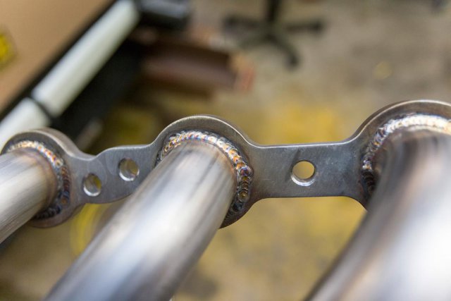

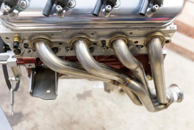

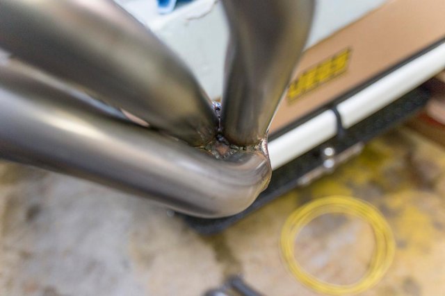

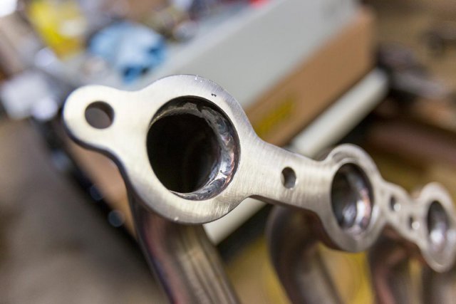

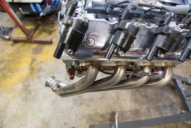

Update: I bought them both for a test fit. My thoughts and photos:
CX  1-5/8" Long Tube Headers:
Like the flange. Don't like the short collector. Most welds are good. Would prefer a slightly larger diameter (and avoid the instant step down at the flange). (Forgot to take a photo inside collector.)
post-14255-0-19081500-1453308152_thumb.jpgpost-14255-0-29841700-1453308153_thumb.jpgpost-14255-0-15482000-1453308155_thumb.jpgpost-14255-0-51202300-1453308156_thumb.jpgpost-14255-0-21242600-1453308158_thumb.jpgpost-14255-0-07887000-1453308183_thumb.jpgpost-14255-0-43287500-1453308186_thumb.jpgpost-14255-0-22847700-1453308187_thumb.jpg

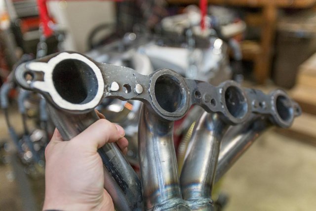

JTR / Sanderson 1-3/4" Shorty Headers:
Dislike the ground down-weld flange. Welds look like quick MIG work. Like the Larger Diameter tubing.
post-14255-0-41295100-1453308767_thumb.jpgpost-14255-0-13055200-1453308768_thumb.jpgpost-14255-0-98855300-1453308768_thumb.jpgpost-14255-0-75295500-1453308769_thumb.jpg
