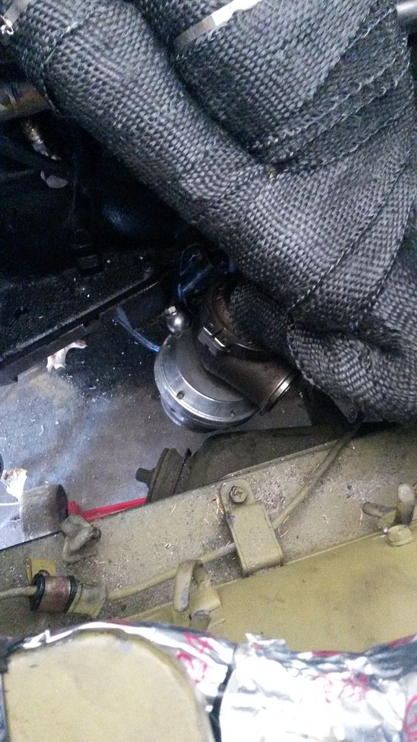

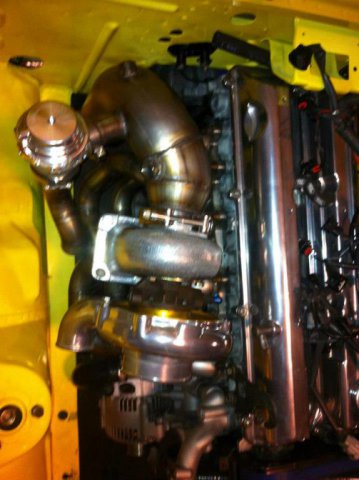

Drift Boss Posted January 24, 2016 Share Posted January 24, 2016 As far as the manifold goes, you can run the oem twins. I have this manifold, not sure who makes it, but it's PERFECT for a s30. Waste gate clears everything. I tried 3 different types before this one, all of which seemed to need modified. Ain't nobody got time for that. Quote Link to comment Share on other sites More sharing options...
Acesss Posted January 27, 2016 Author Share Posted January 27, 2016 (edited) On 1/24/2016 at 3:05 PM, Drift Boss said: As far as the manifold goes, you can run the oem twins. I have this manifold, not sure who makes it, but it's PERFECT for a s30. Waste gate clears everything. I tried 3 different types before this one, all of which seemed to need modified. Ain't nobody got time for that. Thanks for sharing the pictures! Do you know where you got the manifold? Also I was wondering how you liked the wiring specialties harness and if you're still on the stock ecu? As I think ill be going 1j as i don't plan to have anywhere over 500hp Edit: forgot to ask what you thought of the cxracing mounts Edited January 28, 2016 by Acesss Quote Link to comment Share on other sites More sharing options...

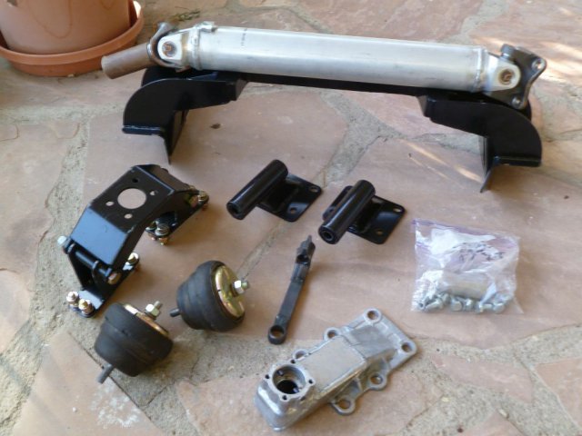

Drift Boss Posted February 24, 2016 Share Posted February 24, 2016 Cxracing mounts.... Here is the run down. (PPictures in my build status) I had a problem with them not setting the engine all the way back. I also had a problem with them falling over....like one would push the other one and make my engine set weird. After about the 10th time going in and re tighting them up... I ended up just welding them to my 280z subframe. DoNE. Never had a issue sence. I highly suggest the wiring spec harness. I know it's some money...but differently worth it. I wired in 2x 1jzgte to other cars (240sx and a supra) neither I enjoyed doing... I have wired many rb series and Sr series engines. Cake compared to wiring a jz. Oh, and yes stock ecu, stock injectors at 10psi never giving me issues. It's daily drivable this way, BUT I would not go out to drift events like this. Hope you catch what I am implying. (I suggest tuning) Quote Link to comment Share on other sites More sharing options...
Drift Boss Posted February 24, 2016 Share Posted February 24, 2016 I welded the cxracing bottom mount to my subframe and the top mount (engine mount) still bolts in. So you can remove the engine still with out issues. Quote Link to comment Share on other sites More sharing options...
