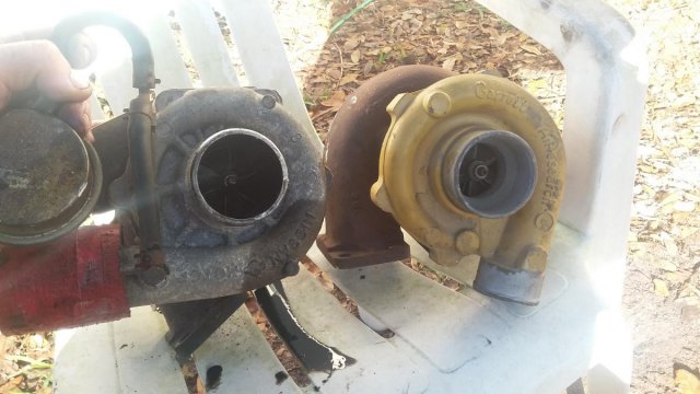

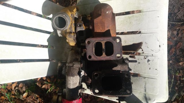

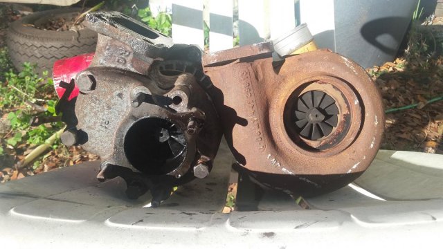

KidandhisCar Posted March 6, 2016 Author Share Posted March 6, 2016 I have another question , i was recently given a turbo off of a 3.9l perkins at work,the engine and turbo have less than 50hrs on it,and were on a stand used for classes for apprentices.they decided to junk the engine to clear up space,so i nabbed the turbo. Anyway the turbo is a garret air research ta3107. No waste gate,it is identical to the stock turbo,uses the same oil lines,only there is no waste gate,and the compressor wheel is about 10mm smaller.(measured with a mic) The stockers cartidge is junk,tipping the turbo over results in oil leaks out of the intake and exhaust,and has enough vertical shaft play to let either wheel touch their housings. Can i use the perkins unit for my build? If people are maxing out flow on the stockers,in my minds eye i think i would be alright without the waste gate. I doubt this would flow anymore than the stocker,but my main want to use this is it was free,and i recently bought another car to give me more time on the z,as the z was my dd,wich ruined the money i had saved for the turbo. Ive read that people say running without a waste gate will cause excessive boost,and overspeed the turbo during spool? During spool the wastegate should be closed to send all gases throufh the turbine,and then open once desired boost is reached. So if my turbo maxes out of flow before max rpm i should be ok correct? Please advise,and thank you Quote Link to comment Share on other sites More sharing options...
Xnke Posted March 7, 2016 Share Posted March 7, 2016 (edited) Exhaust wheel is OK size, but the compressor is much to small. it is not at all safe to run without a wastegate on an engine with an RPM range like The L28...nonwastegated turbos are generally used on engines that operate at a fixed speed and constant load. If you just run with the compressor maxed out all the time you'll be killing power in the exhaust, and creating huge amounts of heat from the overspun compressor. Not to mention the fatigue life of the compressor shaft... Keep the turbo, as it's a decent usable core for a low-HP build but get as bigger compressor section and put on it. The TA31 turbine wheel is often called a "stage 3" turbine wheel, you could have the stock wastegated housing bored to fit the bigger wheel and that would take care of any wear from the stock turbine rubbing. Then, find and fit a T04B/T04E compressor, you're looking at diesels in the 6.0L area for those. Edited March 7, 2016 by Xnke Quote Link to comment Share on other sites More sharing options...

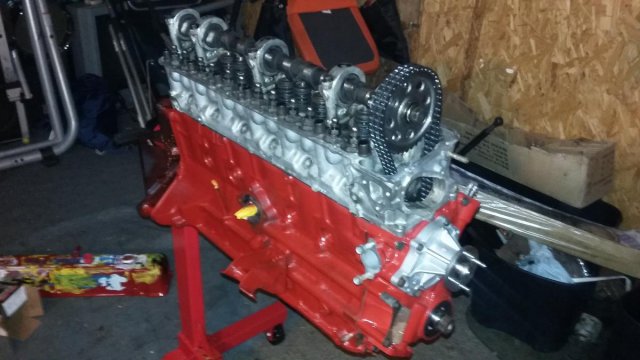

KidandhisCar Posted April 14, 2016 Author Share Posted April 14, 2016 (edited) I've got my heart set on the 3X,and it's staying that way.still haven't gotten the rockers in,but the head and timing set is on.here's a pic from the other night,still much to do Edited April 14, 2016 by KidandhisCar Quote Link to comment Share on other sites More sharing options...
