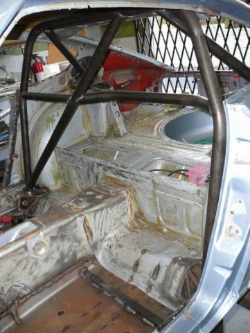

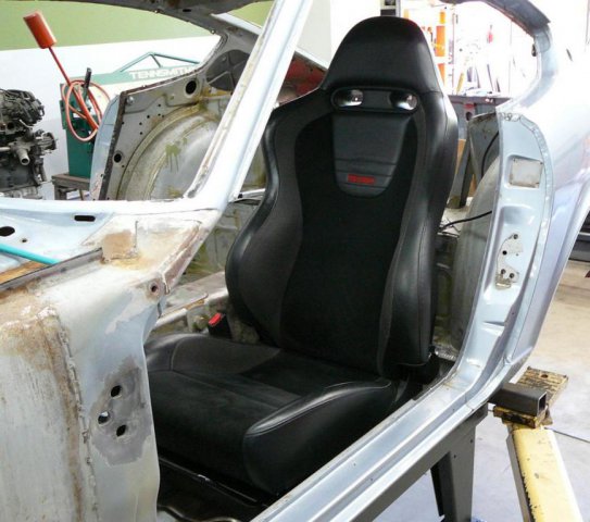

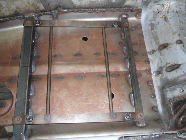

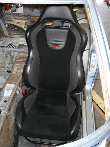

Nelsonian Posted March 18, 2016 Share Posted March 18, 2016 (edited) As for the height issue I can't comment on that as I am a shorty at only 5'8" and a buck sixty, but when installing old BMW Recaro seats to the stock mounting bars, even I at my short stature was getting cramped with space. Once I got a serious game plan formed for my build, I had new mounting bars and seat brackets installed along with the new floors and frame rails. The rear bar is lower than the front. I am using a Recaro seat made for the Mitsubishi Evo 9 with the sliders intact for that seat. Edited March 18, 2016 by Nelsonian Quote Link to comment Share on other sites More sharing options...
seanof30306 Posted March 19, 2016 Author Share Posted March 19, 2016 As for the height issue I can't comment on that as I am a shorty at only 5'8" and a buck sixty, but when installing old BMW Recaro seats to the stock mounting bars, even I at my short stature was getting cramped with space. Once I got a serious game plan formed for my build, I had new mounting bars and seat brackets installed along with the new floors and frame rails. The rear bar is lower than the front. I am using a Recaro seat made for the Mitsubishi Evo 9 with the sliders intact for that seat. Very nice work. Sitting in the mounted seat, do you feel you are lower than stock? if so, how much lower? Quote Link to comment Share on other sites More sharing options...
