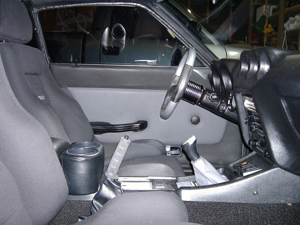

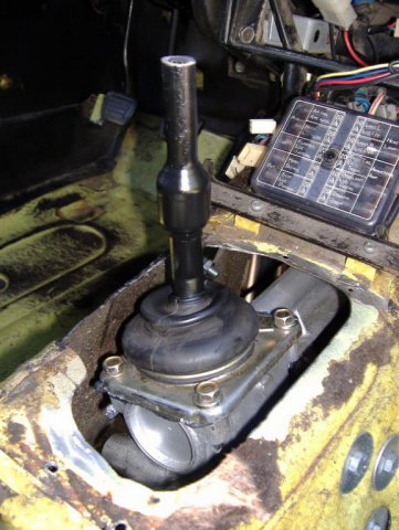

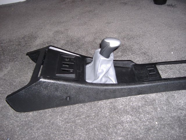

I have used 1990 Camaro World Class T5 transmissions  in two 240Z  SBC 350 builds. Both cars were built as daily drivers (son's college car, my work car).
The five speed is highly appreciated on freeways and road trips.
The T5 is tilted towards the driver's side, but poses no problem for installation. Use the Camaro bell housing so that the rear trans mount is horizontal. Only a small amount of trimming is required on the left side of the trans hump where the shift tower comes up through the floor.  I have pictures if you need them.

I actually looked at that as an option.  I've still got a V6 T-5 with the ford bolt pattern. use the T5 for a V8
How did you account for the tilt?  I assume one could fabricate a custom crossmember? If you use a Camaro bell housing there is no need to make a custom crossmember as the rear trans mount will be horizontal. As mentioned above you will need to trim the trans tunnel on the driver's side where the shift tower comes up.
Also, I noticed that on the V6 T-5's the tailshaft housing is longer.  When I test-fitted my V6 T-5, the shifter location ended up about 4" behind (towards the back of the car) the hole.  Did you have to account for this somehow? Forget the V6 T5  you have. It won't work.
