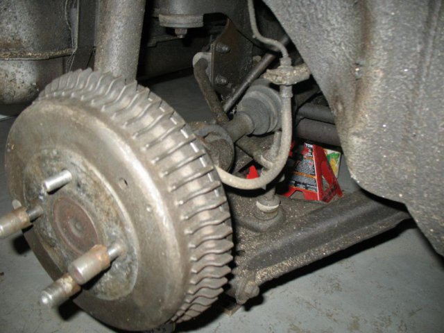

~KnuckleDuster~ Posted April 26, 2016 Share Posted April 26, 2016 Does anyone know what rear sway this is? I was in the hatch of a Z I bought and would like to clean it up and put it to use but curious where it mounts to. I tried looking around but didn't see anything similar. The bar is 19mm. Quote Link to comment Share on other sites More sharing options...

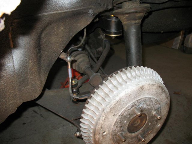

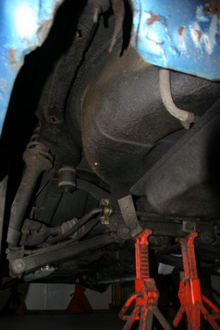

Apollyon12 Posted April 27, 2016 Share Posted April 27, 2016 (edited) Does the arm have a slight bend in it? This is the one I had on my car (not the MSA Blue one). Yours looks similar, except for the mounting brackets. Edited April 27, 2016 by Apollyon12 Quote Link to comment Share on other sites More sharing options...
jhm Posted April 27, 2016 Share Posted April 27, 2016 Looks like a ST rear bar for 240, with some funky homemade mounting brackets. Even though it was originally designed for use on the 240, it's a very popular upgrade on the 260s and 280s, as it does not bind with the rear LCAs on lowered cars like the stock sway bar is prone to doing. Quote Link to comment Share on other sites More sharing options...
Zipper Posted April 27, 2016 Share Posted April 27, 2016 Looks like a ST rear bar for 240, with some funky homemade mounting brackets. Even though it was originally designed for use on the 240, it's a very popular upgrade on the 260s and 280s, as it does not bind with the rear LCAs on lowered cars like the stock sway bar is prone to doing. Seems likely. And I think can bind with R200 mustache bar, so spacers are needed - my guess at those brackets. Quote Link to comment Share on other sites More sharing options...
