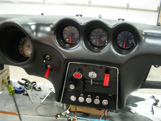

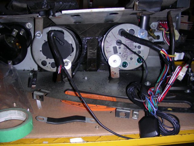

z mouse Posted April 27, 2016 Share Posted April 27, 2016 I installed speedhut gauges in my 1970.i used 4 inch and 2 5/8 inch sizes.i was able to fit all them in my original metal gauge pods with slight modifications.that way,they bolt up securely with the existing brackets in the dash and look quite original.i don,t think you can go wrong with speedhut considering they can be custom built for you and they have a good warranty.also the gauges have stepper motors that sound cool when you turn the key on. Quote Link to comment Share on other sites More sharing options...

Dlirium Posted April 28, 2016 Author Share Posted April 28, 2016 I installed speedhut gauges in my 1970.i used 4 inch and 2 5/8 inch sizes.i was able to fit all them in my original metal gauge pods with slight modifications.that way,they bolt up securely with the existing brackets in the dash and look quite original.i don,t think you can go wrong with speedhut considering they can be custom built for you and they have a good warranty.also the gauges have stepper motors that sound cool when you turn the key on. Brilliant, those look amazing!! Quite a project pulling the entire dash out!! Quote Link to comment Share on other sites More sharing options...

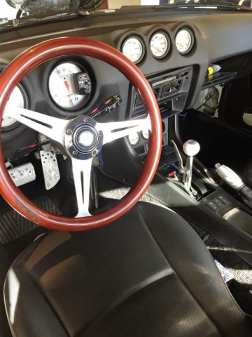

ryan95i4 Posted May 10, 2016 Share Posted May 10, 2016 The speedhut gauges look really good.I have autometer pro comp gauges in mine, the 2 5/8 fit perfect in the dash pods Quote Link to comment Share on other sites More sharing options...
