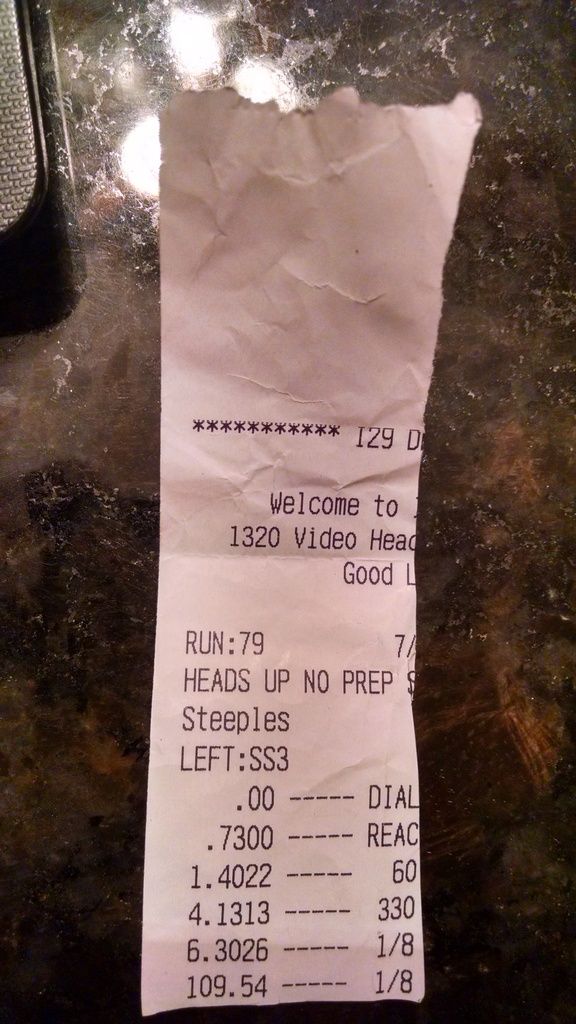

SUNNY Z Posted July 16, 2016 Author Share Posted July 16, 2016 Took the car to the track for the first time since...... shit, since drag week 2014 ... Pulled my trailer and gear over an hour there, and made three passes. Two of which are personal bests for the car! Launched out of boost, and ran out of gear a good 75' before the traps. I'm just happy I still remembered how LOL VIDEO VVVVVVVVVVVVVVVVVVVVVv http://vid592.photobucket.com/albums/tt4/steepss/SidwayZ/TRIM_20160716_081447_zpssxmsyjzz.mp4 Quote Link to comment Share on other sites More sharing options...
RebekahsZ Posted July 16, 2016 Share Posted July 16, 2016 Love it! 1.42 60' even with all that spin. "Ran out of gear.." At 106mph with a 3.55 and 28" slicks... 3rd gear? We gotta get you a faceplated tranny. You deserve it. Quote Link to comment Share on other sites More sharing options...

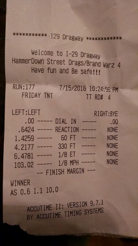

SUNNY Z Posted July 17, 2016 Author Share Posted July 17, 2016 (edited) Entered the stick class at the local no prep last night and made some good rips. Here's the fast pass of the night. I ran a 6.47, 6.30, 6.35, 6.36, and spun hard to a 6.60 and lost the final to a good friend who killed it in his 5.0 coyote YSI Mercury Capri at a 6.20@115. And a picture of me on the 2 step. She is VIOLENT. Video VVVVV Edited July 17, 2016 by SUNNY Z Quote Link to comment Share on other sites More sharing options...
