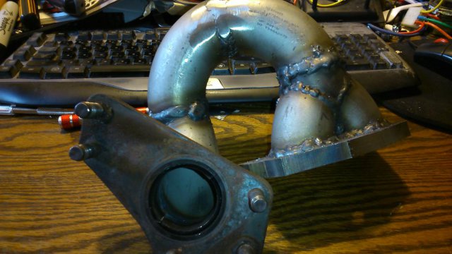

I think I'll do just that for now. I'm more curious to see what kind of, if any, performance gains I can get with this particular design.
Slip joints will work just fine for this application and don't take up that much space.  Burns has single and double slips for this.  I've been using single slips on my manifold for several years now with no leakage issues - the inner tube tends to heat and expand more than the outer so it seals just fine once hot.  You are at a point now where you could implement this and not have to f*** with fixing it later, and you will almost certainly have to fix it later if you don't address it now...

Could I get away with making my own slip joints, or do I have to buy specially made ones from Burns? Do they have to  be an interference fit, or should they be able to move freely? Would a single slip be adequate, or is a double slip joint required? Suppose I put them just off the flanges where they bolt to the head? Or would they pull too far away and cause leaks? I'm new to slip joints on a turbo manifold - Only ones I've seen are leaky ones on N/A headers. Sorry for the gratuitous questions - I'd rather this stuff didn't fail at all, and some mechanic friends are telling me I'm thinking too much about this.

You want the slip joints to be able to expand in the direction that the manifold is going to grow as it heats up.  I'm thinking I would put single slips in the following locations:

We're working on a support bracket for the turbo, most likely going to hang it off the intake manifold, since that seems strong enough. When I get in touch with my friend who TIG'd it together for me, I'll ask him about putting in some slip joints. Like I said, it's gotta come off for ceramic coating, anyway.

Sweet looking manifold and the design is unique.  As others have stated put the slips on the straight legs after the 1-2 merge and 5-6 merge.  A single slip can have leakage, but it is not typically audible and more so that you can see carbon blow-by over time.  I personally prefer a double slip over single just because and that is what I use on manifolds I fabricate. (sorry Tim :huh: )  As a note, the welds look hot so if you didn't use a flux paste or purge you could end up with cracking regardless of slip joints.  Also, if this is 0.065" it should be 321SS and not 304SS or it will likely crack.
FYI, this was the first 0.065" 304SS twinturbo manifold I made back in 2002, which ended up cracking.  So we all learn from our experiences over time.
This is a manifold I made for my EVO in 2012 and it is still going strong after 40K miles.  Thick walled 316SS twinscroll with double slip joint.

That stuff looks almost like the sch-10 stuff that vibrant makes, which I once used on an experimental J-pipe that mounted on a stock late L28 manifold. I welded it with just my MIG, and used 1/2" mild steel for the main flange, and a reused turbo flange from a Subaru up-pipe. I didn't like how close the downpipe was to the firewall, though, so I made the full manifold in question, but that was TIG'd together by a retiree from the airforce. He says it shouldn't crack, but we'll see.

Yes, the EVO manifold is sch10 from Treadstone.  The advantage is that you have the ability to get tight radius bends that are not otherwise available with standard 0.065" stainless.  For an L28 manifold it would be more suitable since there are space constraints.  I also found that short runner manifolds do hella-good for spool on a street car where response is critical.  I may suffer on the topend vs a long runner manifold, but I really like the boost response.
On my 2L I make 27.3psi @ 3848rpm with a GTX3576r and 27.4 @4351rpm with a GTX3582r both logged in 3rd gear.

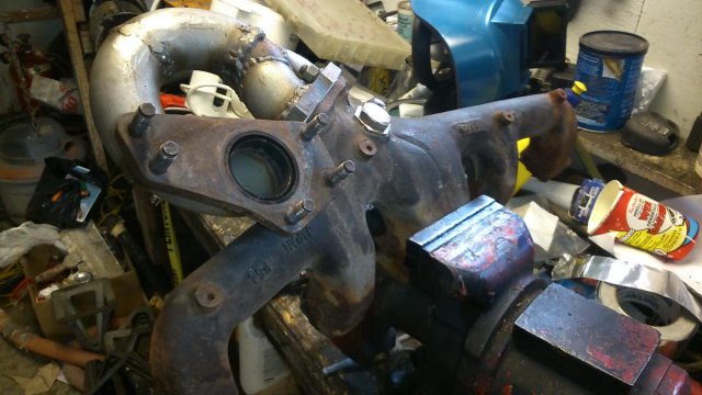

What? Did I do something wrong? I'll admit I was going for a similar trick to the crown kits from way back, but sadly, the way I was making it with the sch-10 bends, it would be less than 1/2" from the steering shaft. The only way I could figure it out was to run the J-pipe back, instead of outwards.
