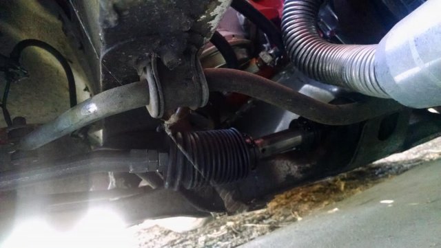

marinez Posted August 12, 2016 Author Share Posted August 12, 2016 Well it's not quite right. With 2.39 on either side it's way off center. I tried adjusting it out but the left hand tie rod is bottomed out. After further research, I've noticed that the crossmember has been modified. Looks extended on the right hand side and the front suspension has two pieces of half inch by two plate between it and the unibody mounting points. Uggg Quote Link to comment Share on other sites More sharing options...

marinez Posted August 12, 2016 Author Share Posted August 12, 2016 Best I can do at present. Quote Link to comment Share on other sites More sharing options...
marinez Posted August 12, 2016 Author Share Posted August 12, 2016 Let me know if it uploads. Quote Link to comment Share on other sites More sharing options...
marinez Posted August 12, 2016 Author Share Posted August 12, 2016 Still trying. Quote Link to comment Share on other sites More sharing options...
marinez Posted August 12, 2016 Author Share Posted August 12, 2016 If you look to the left of the steering rack boot you'll see the modified area. Quote Link to comment Share on other sites More sharing options...
NewZed Posted August 12, 2016 Share Posted August 12, 2016 Do you mean that the crossmember has been lengthened, where I marked it? Those welds? Quote Link to comment Share on other sites More sharing options...
marinez Posted August 12, 2016 Author Share Posted August 12, 2016 Yes. I'm so disheartened. Quote Link to comment Share on other sites More sharing options...
marinez Posted August 12, 2016 Author Share Posted August 12, 2016 The rack has been shifted left. I get full lock left (of course) but partial lock right. Just sucks. Quote Link to comment Share on other sites More sharing options...
NewZed Posted August 12, 2016 Share Posted August 12, 2016 Weird. Did somebody do some funky body work under? Is that even the stock 280Z crossmember? You might open up the Body chapter and take some measurements. Quote Link to comment Share on other sites More sharing options...

NewZed Posted August 12, 2016 Share Posted August 12, 2016 I would take some measurements and see what you're dealing with. Maybe somebody repaired a damaged crossmember. I underlined two simple ones, one between the rails and one to the crossmember mount bolt heads. Quote Link to comment Share on other sites More sharing options...
