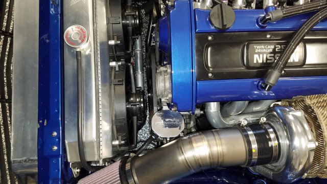

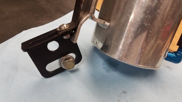

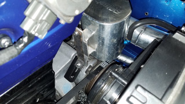

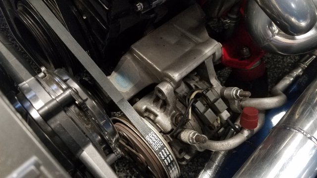

boosted300 Posted March 10, 2018 Author Share Posted March 10, 2018 So you're looking at the bracket for the coolant overflow and thinking, where the heck is that thing going? I used the front mounting bolt for the AC compressor... Quote Link to comment Share on other sites More sharing options...

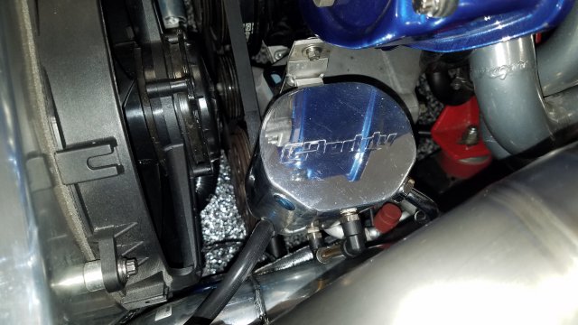

boosted300 Posted March 10, 2018 Author Share Posted March 10, 2018 (edited) ...and created usable space from empty air! I won't lie, I was very pleased with myself as this thing had a little thorn in my side. Edited March 11, 2018 by boosted300 Quote Link to comment Share on other sites More sharing options...

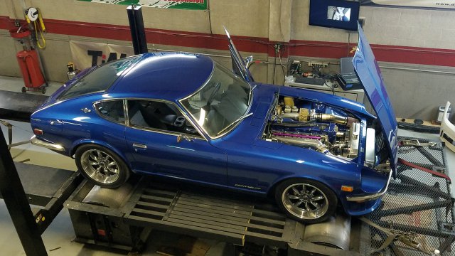

boosted300 Posted March 10, 2018 Author Share Posted March 10, 2018 Finally it was time to go to the dyno for tuning... Quote Link to comment Share on other sites More sharing options...

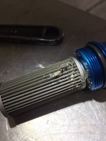

boosted300 Posted March 10, 2018 Author Share Posted March 10, 2018 With the previous setup, I had managed a best of 419hp @ 19psi... That was with an internal wastegate, stock cast iron exhaust manifold, .63 A.R, and a smaller intercooler... Now with external wastegate, tubular exhaust manifold, .82 A/R, and a large intercooler, I was hoping for a fairly decent improvement. After several warmup runs to get the baseline set, we started upping the boost. This time we managed 469rwhp @ 19psi, but we noticed that after that the A/F ratios started creeping up. The tuner tried to compensate by increasing the injector pulse, but no luck. We watched the fuel pressure during one of the runs and noticed it wasn't rising 1:1 after about 55 psi and, in fact, after 19 psi, it was actually dropping. The car has 3 Walbros; one primary to feed the surge tank, and two secondary pumps to feed the engine, so there should have been more than enough fuel especially for the horsepower levels we were making at that point. We checked the fuel pumps and verified they were all running properly…what the…? The only logical conclusion at that point was that the filter must be clogged. Quote Link to comment Share on other sites More sharing options...

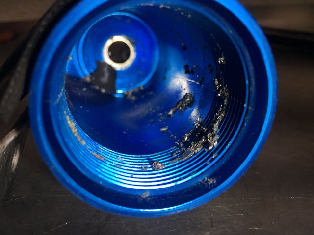

boosted300 Posted March 10, 2018 Author Share Posted March 10, 2018 (edited) I had purchased the car from the previous owner as a “new” build, ie the car was not running when I bought it and I had to wait nearly a year from the time of purchase for the car to be "completed" and “driveable”. We had not touched the fuel system, lines, or tank since I purchased the car. And the car at this point had less than 1K miles since I purchased it, so I would have never thought that the fuel filter could possibly be dirty, let alone dirty enough to be clogged so much that it would restrict fuel pressure…silly me. We took the fuel filter out and this is what we found inside… Edited March 10, 2018 by boosted300 Quote Link to comment Share on other sites More sharing options...

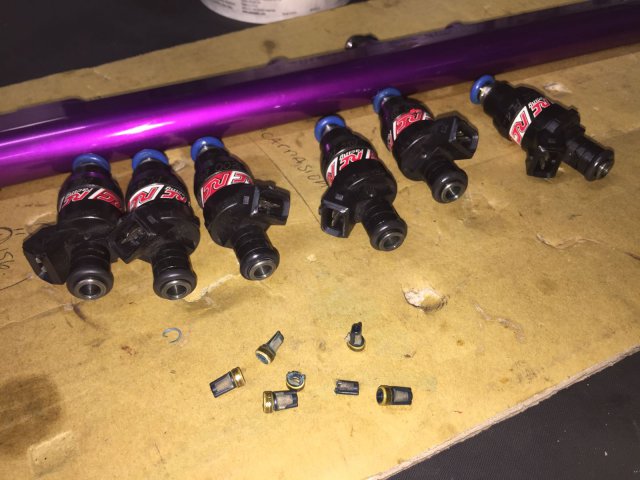

boosted300 Posted March 10, 2018 Author Share Posted March 10, 2018 So I think it's safe to say that we found the source of the restriction... No you're eyes are not deceiving you...that's a piece of rubber hose in there... While the amount of dirt and debris in the filter was astounding on its own for a “new” build…I cannot begin to fathom how actual pieces of rubber hose found their way in there… It was unbelievable on one had…and yet, based on all that I had encountered after the purchase, totally unsurprising on the other hand. Because the amount of dirt and debris was so out of the ordinary, we decided that, to be safe, we needed to take the injectors apart and check the built in screen filters on each one before continuing with tuning. Quote Link to comment Share on other sites More sharing options...
boosted300 Posted March 10, 2018 Author Share Posted March 10, 2018 The good news is the injector filter screens were clean…back to the dyno! Quote Link to comment Share on other sites More sharing options...
boosted300 Posted March 13, 2018 Author Share Posted March 13, 2018 Third go-round on the dyno: Fuel pressure held steady this time. I told the tuner I wasn't trying to break any records and my main concern was not breaking the motor. One thing I did tell him is that I would like a number that started with 5... He delivered me a safe, conservative tune...that netted 510RWHP @ 23psi on 93 octane. I was satisfied with that, especially considering that traction was already near its threshold. Quote Link to comment Share on other sites More sharing options...

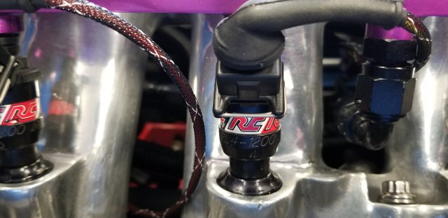

Arif Posted March 17, 2018 Share Posted March 17, 2018 Wow what a great read and the attention to detail! A couple quick questions: 1. What size injectors are you running? 2. What tires are you running to hold all that power? Quote Link to comment Share on other sites More sharing options...

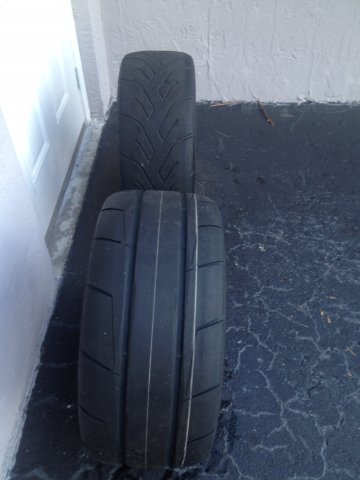

boosted300 Posted March 19, 2018 Author Share Posted March 19, 2018 (edited) On 3/17/2018 at 3:02 AM, Arif said: Wow what a great read and the attention to detail! A couple quick questions: 1. What size injectors are you running? 2. What tires are you running to hold all that power? Expand The injectors are some outdated 1200cc's RC injectors. The tuner told me they are really sloppy and it's noticeable on the low end driveability and startup. He said that I could probably pick up a few HP at the same boost levels just from getting new, more efficient injectors. The tires are Nitto NT05R drag radials 275/40/17 (the front tires, at the top of the picture, are Yokohama A008's) Edited March 19, 2018 by boosted300 Quote Link to comment Share on other sites More sharing options...
Arif Posted March 19, 2018 Share Posted March 19, 2018 On 3/19/2018 at 2:16 AM, boosted300 said: The injectors are some outdated 1200cc's RC injectors. The tuner told me they are really sloppy and it's noticeable on the low end driveability and startup. He said that I could probably pick up a few HP at the same boost levels just from getting new, more efficient injectors. Expand I wonder if the sloppiness is from the size of the injectors or the brand. I'm running a set of RC injectors but they are 750cc. Quote Link to comment Share on other sites More sharing options...
