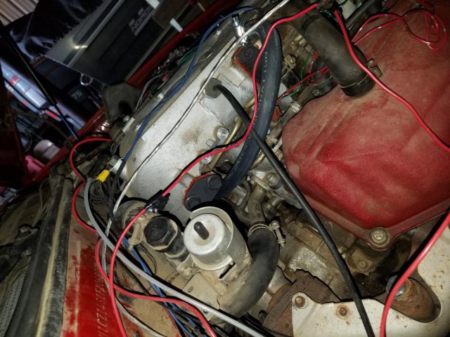

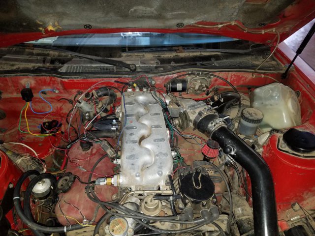

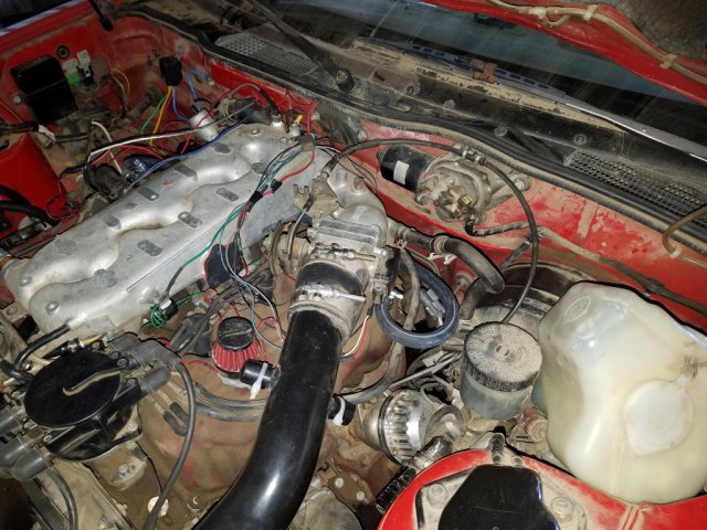

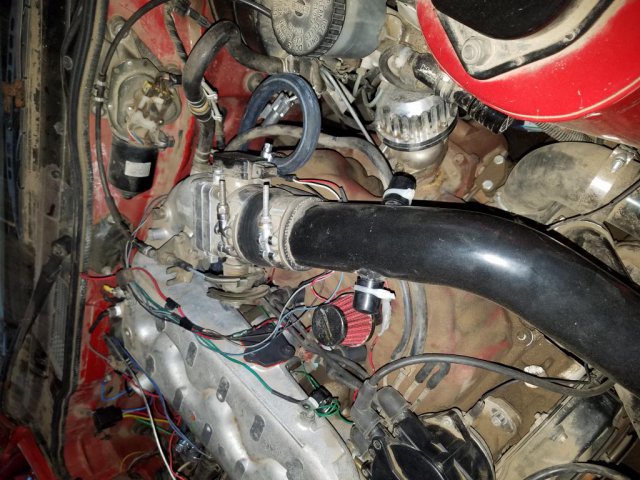

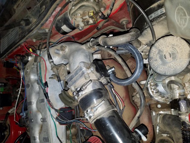

For the idle air, you capped off the hose connection on the Throttle Body?  No vent hoses attached at all?  Can you post up a Picture of the TB. Make it a wide shot so I can see any hose routing.
There is no IAC valve on these cars. Those are PWM solenoid valves. The Z31 ( and 280Z and ZX ) use an Auxiliary Air Regulator. It is a simple heated Bi-Metallic spring that moves a slotted slider. There is no need for any Idle Control programming. It use 12v and the facory Thermistor, which is another Bi-Metallic resistor. All analog control.

Alrighty. I had custom made my intake pipe to have two bungs on it (1 for AAC, the other for the air regulator) I've capped both, the hard line vacuum lines and coolant lines have been removed as well. I'm not at my car right now and have no pictures of the throttle body. The only line to the throttle body and intake pipe is the coolant line for the TB.

When you get home a picture is worth a thousand words.

I hooked up my AAC valve back on to the intake (no wires connected) and ran a line to my intake. Fires right up and idles great. Like I was thinking, the intake wasn't getting enough air to idle properly. I believe I fixed the sporadic pulse widths as well. I adjusted my dead time from 0.7ms to 1.2ms. The PW still tends to jump around by maybe 0.5 How would I be able to stabilize it even further to where it jumps maybe <0.1 at idle. Also my RPMs seem to also jump around by maybe 20-30. Would I stabilize that by increasing/decreasing the latency? Or by adjusting the trim pots on the board?
