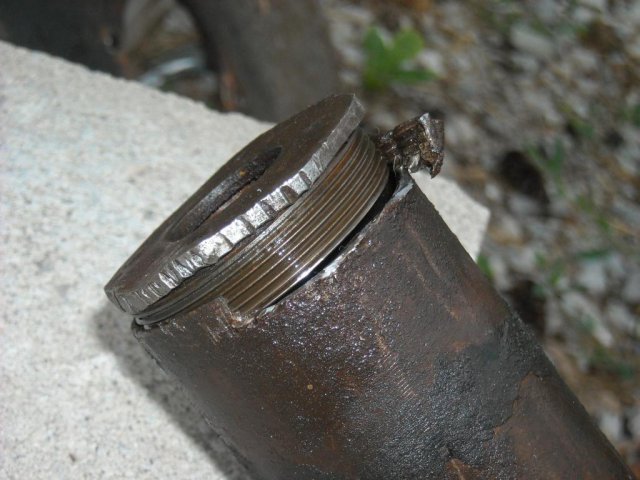

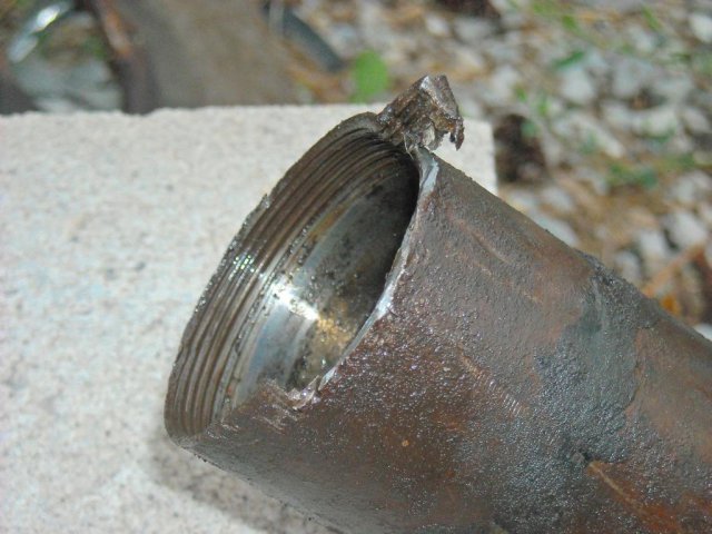

grannyknot Posted May 13, 2017 Share Posted May 13, 2017 Use lots of heat and penetrant and alternate between the two, it is sooo easy to f--k them up. This was using a pipe wrench and not enough patience Quote Link to comment Share on other sites More sharing options...
