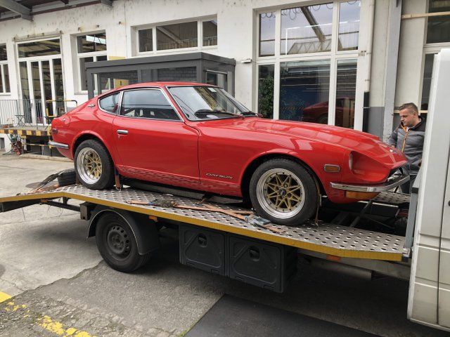

First of all here are some Pics, when I bought the car. I bought the car via Skype and never saw the car in real life.
A really friendly shipping company and some local Z enthusiasts  helped me to get the car from Bend, OR to Switzerland.
IMG_4790.JPG.20eb1cefe84addd3d871585d05e1aae7.JPGIMG_4875.JPG.df32029857c8a69363353165c807112b.JPGIMG_4877.JPG.5379d49e8959d28fe33d9544bc7290b9.JPG

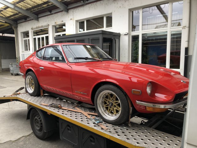

The car was shipped from Houston, TX directly to Bremerhafen, Germany. From there with a truck to Zurich, where I saw it for the first time in real.
Arrived in Bremerhafen like this:
It took 8 months to ship the car, until it finally arrived in Switzerland.
Of course I was disappointed, because everything was "well" used. Unfortunately the headlights, hazard switch, stoplights and turnsignal didn't work when I took it for the first drive.
After some research, I learned that these are the most common problems... so the story began.

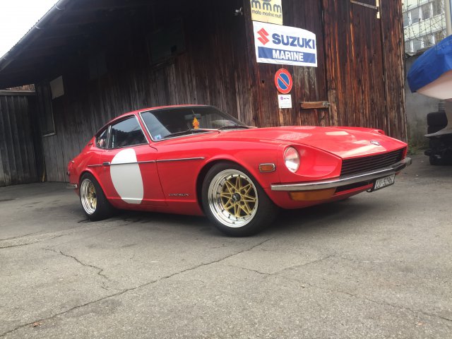

Then I bought the first upgrades:

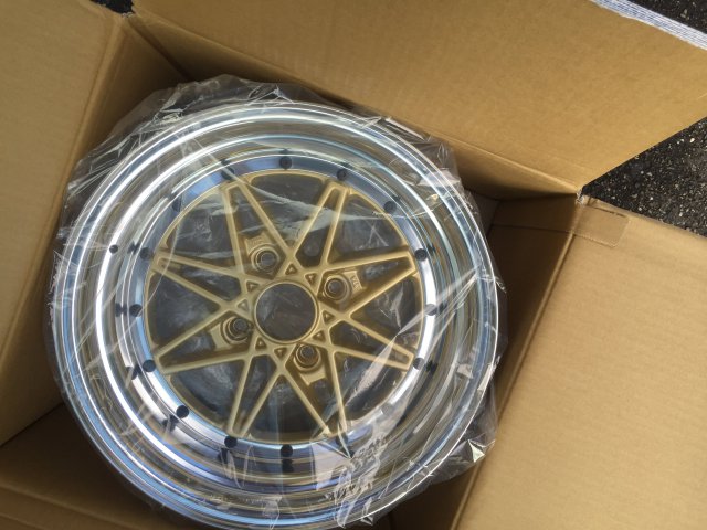

Rota Shakotan 15x9 ET0 with Fulda 205 tyres, bought from driftworks.com
Really nice complete stainless steel exhaust System from Sean Dezart.
New bumpers needed, for a better JDM look:

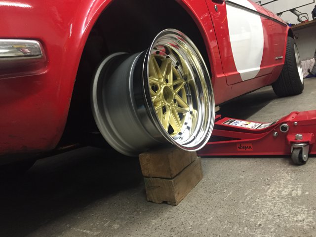

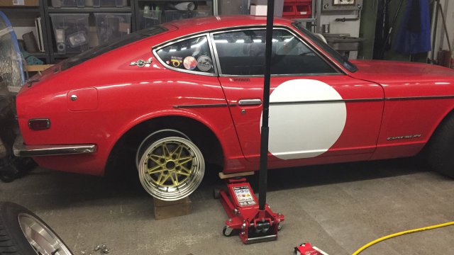

I realised, that the car sits way too high, so I installed new shocks and springs, like all do.
Then it looked like this... getting better and better!

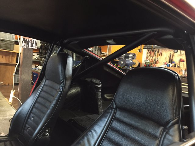

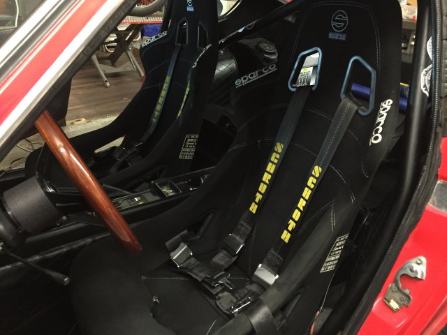

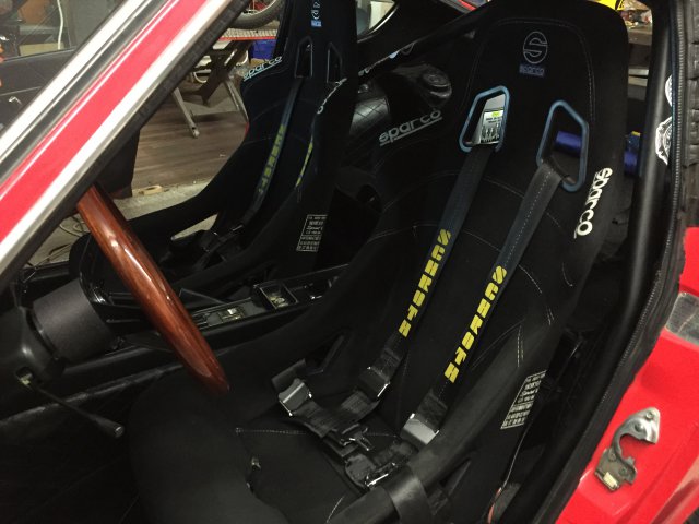

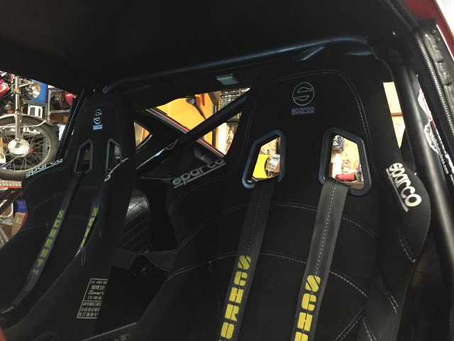

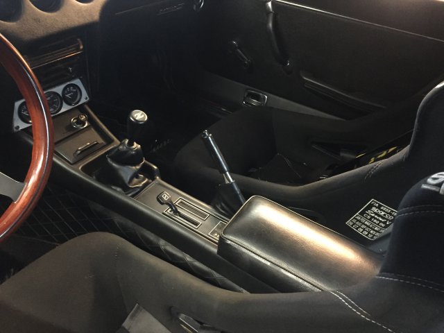

Then I thought, I need new seats:
IMG_4522.thumb.JPG.f9a9cd62d59d06f0fb1cc5588298da0f.JPGIMG_4523.thumb.JPG.3c68f5fb689182d4cf5ed5ebec4f74dd.JPG

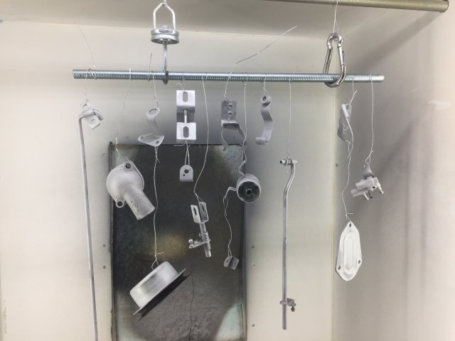

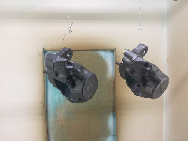

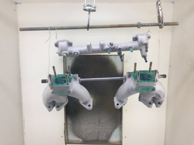

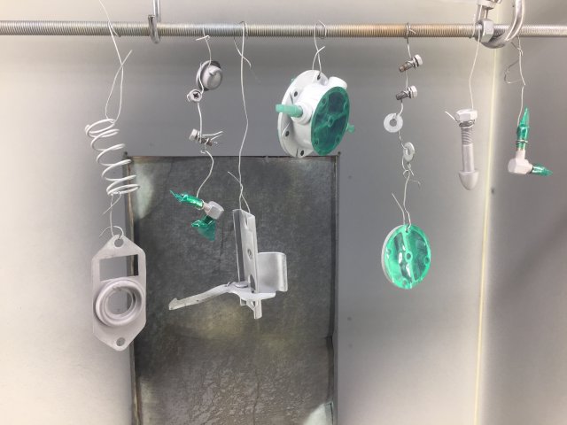

After few weeks I bought a sand/glas blasting cabin incl. a powdergun...
So the first things had be powdered:
IMG_6609.thumb.JPG.9379463b44a8759ad65ef1f2f46c0d3e.JPGIMG_6540.thumb.JPG.6a450a3818fba2cddac827f2332bf9fb.JPG

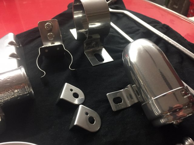

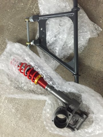

Things getting serious, so I bought something that I always wanted:

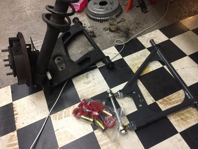

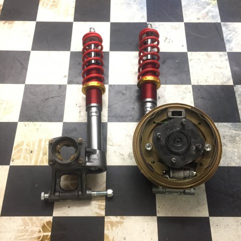

Complete coilovers from T3, rear adjustable arms, positiv camber adjust. adapters and bolt on camber plates.
Adding some personal style:
Edited by mr.mike
Thanks guys! Next update is coming soon!
I spend alot time with my sandblasting cabin and powder gun. I swear, this is the best thing I ever bought for my men cave.
Finally I can dismantle some parts, clean, blast and powder them on the same day, so I can really make some progress in just a few hours.
If you don't have the possibility to clean and powder your parts in-house, you have to bring the parts to a shop and you have to wait a few days until they finished their work. It slows you down...

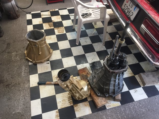

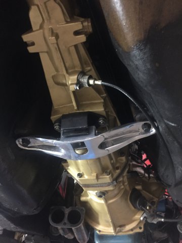

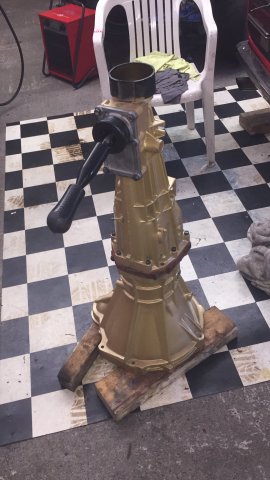

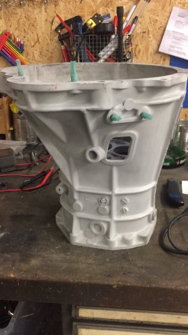

FS5W71C 240SX S14 5 Speed Swap:

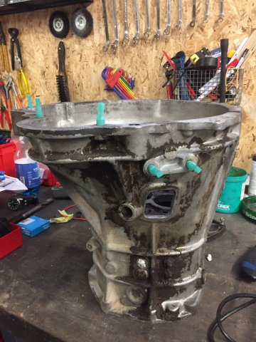

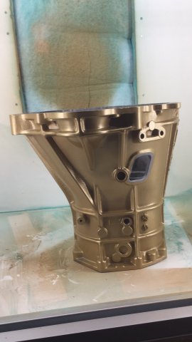

New Bellhousing needed, because I've got a early series 4 speed.
Found here in the forum.

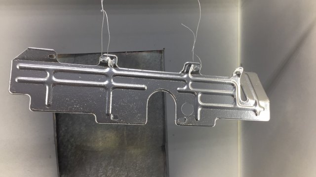

Prepare for blasting:
Fresh powdercoat:

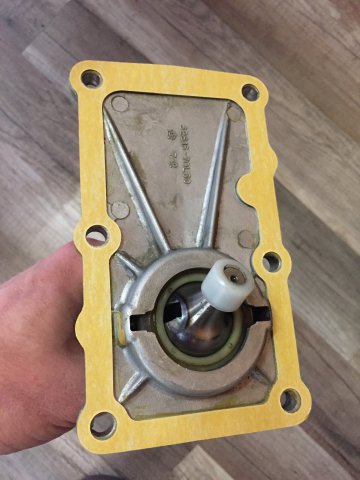

Ready for swap the housing, new seals installed.
Next step, transmission mount:

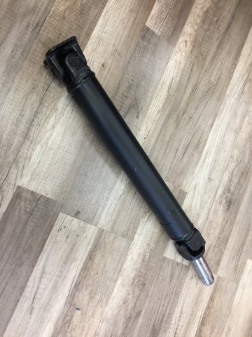

New custom driveshaft needed, made locally, did cost a fortune. lol
Finished product:
It was a nice and easy task. The only issue was to find a driveshaft shop... All the needed modifications did I find here in this forum and here:
http://atlanticz.ca/zclub/techtips/240sxtransmissioninstall/index.html
http://forums.hybridz.org/topic/128100-240z-fs5w71c-swap-using-fs5c71b-bell-housing/
http://zhome.com/ZCMnL/tech/240SX5spd/transmission.htm
Hope you like the finished swap too.

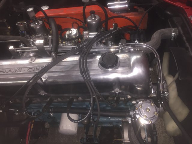

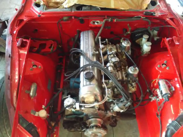

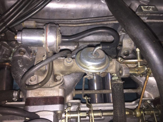

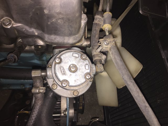

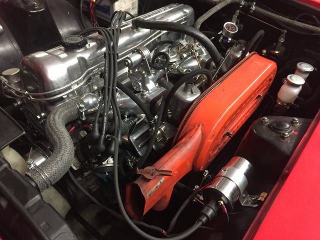

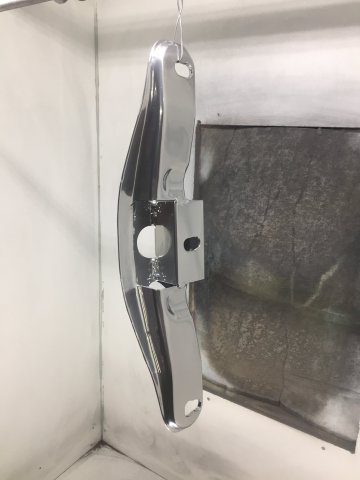

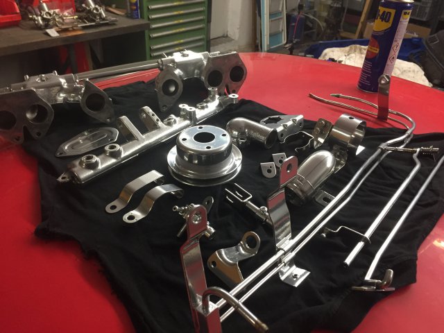

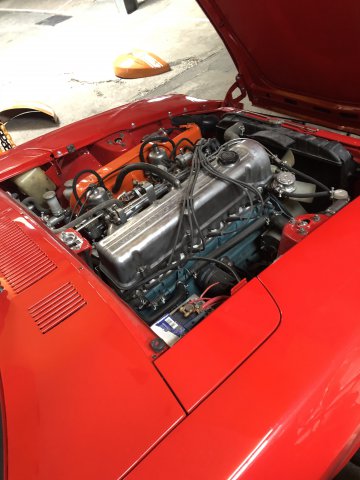

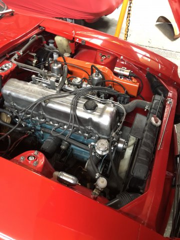

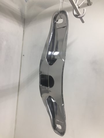

Engine bay clean up
After glass blasting:
Chrome powder coated:
IMG_6949.thumb.JPG.5a86f7c6b4faba16d6f129b8405cc0b9.JPGIMG_7035.thumb.JPG.23e1c621504e152aa06cc79b3c44f793.JPG

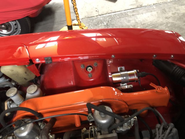

Before:
After, also Pertronix installed:

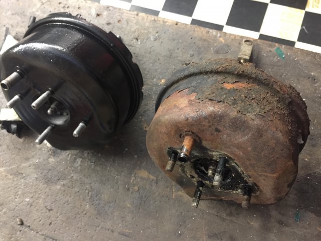

Only litte rost spot on the brake booster:

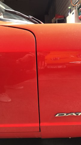

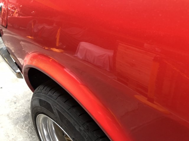

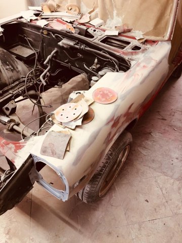

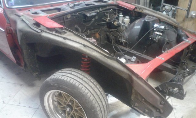

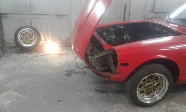

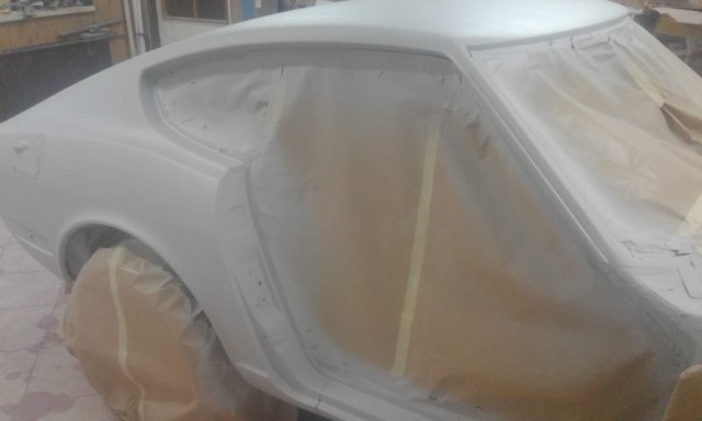

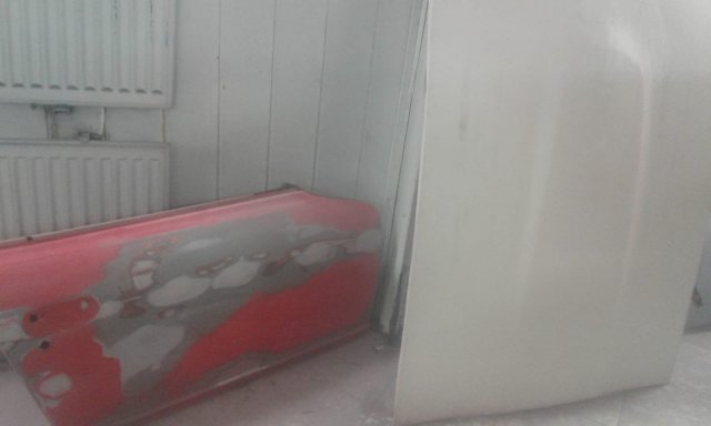

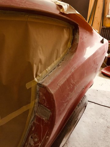

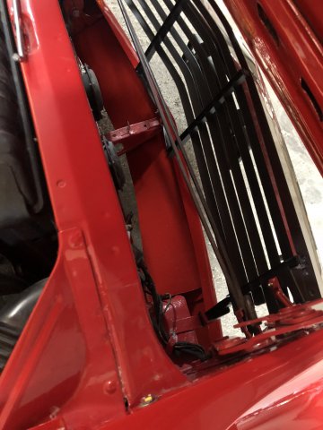

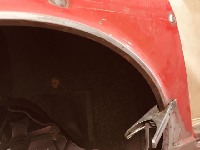

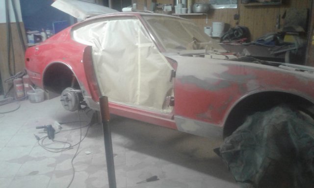

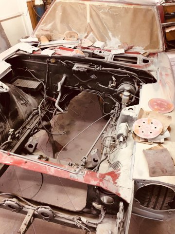

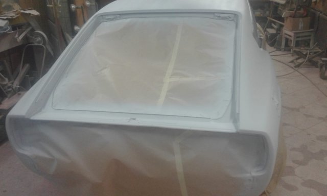

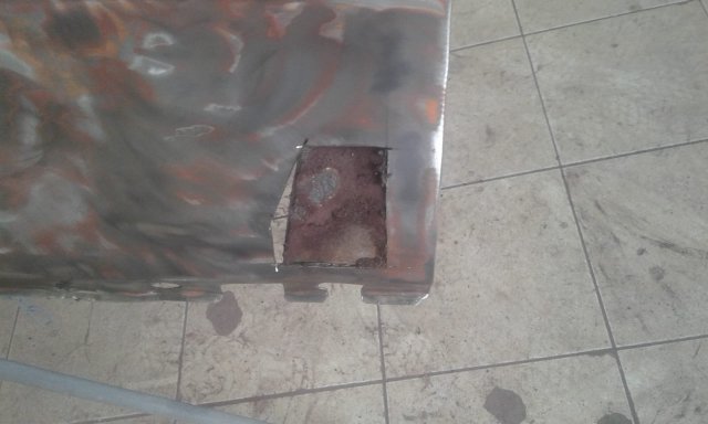

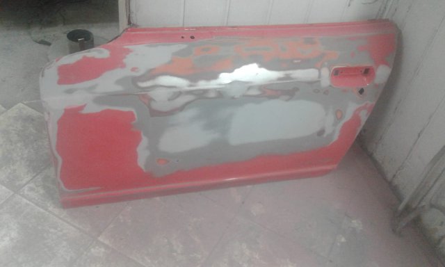

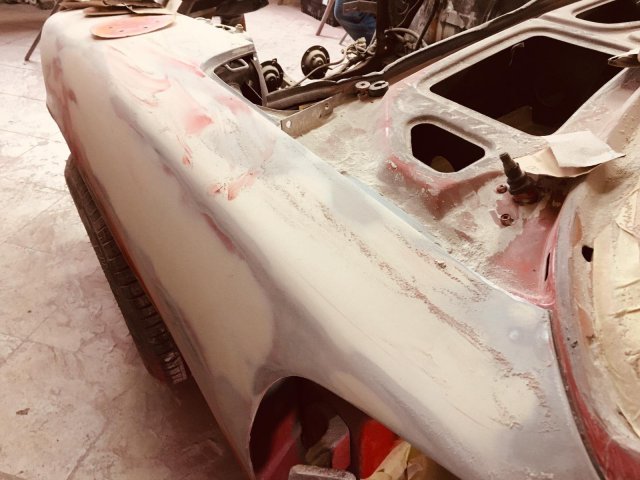

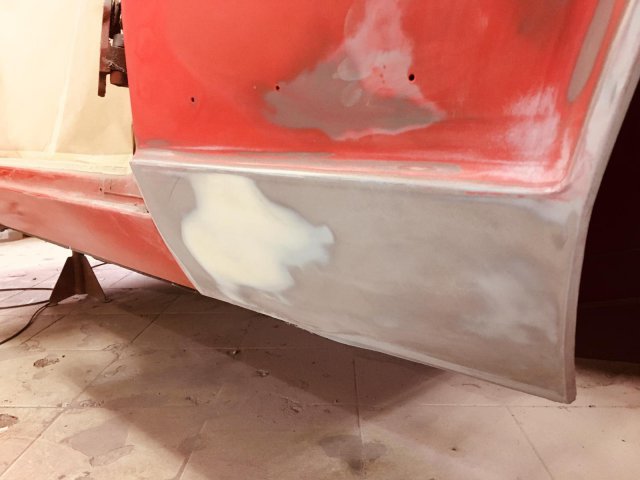

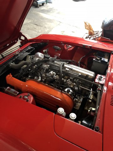

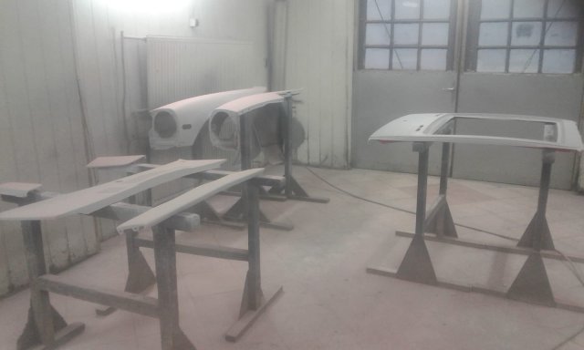

I was able to organize some professional help to get my Z to the next level with a restauration and shaving of the engine bay.

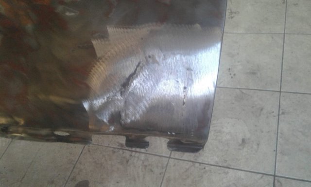

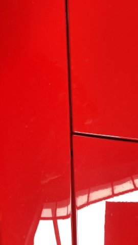

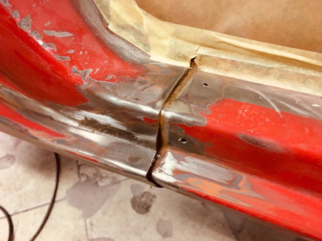

Further I wanted to remove the chrome stripes on each side for a cleaner look. Which was alot work, because filling up all these small holes without stressing the metall too much was not an easy task.

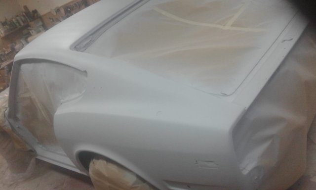

The old paint overall was really bad and some rust underneath the paint was also found.
And first layer of primer.

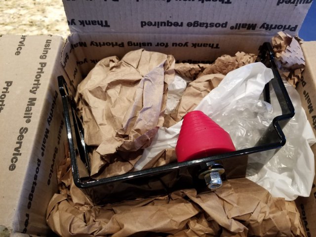

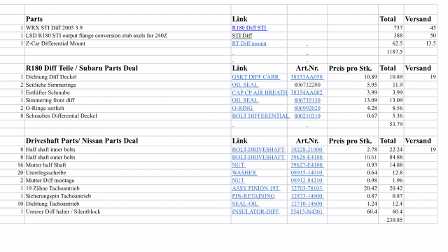

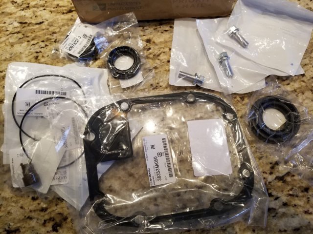

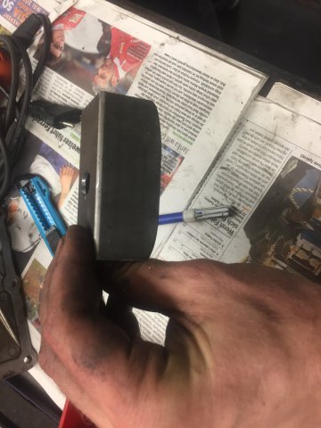

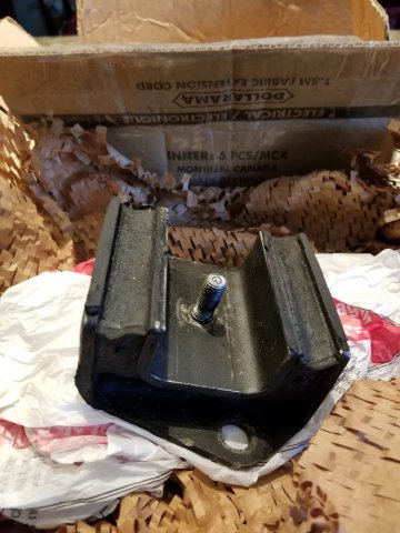

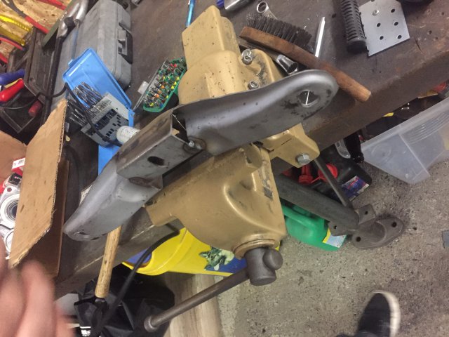

I also sourced all the parts for a diff swap:
2005 WRX STI 3.9 diff
RT Diff Mount for replacing the upper strap
FutoFab conversion axles
U-Joints for rear axles
NOS 1970 diff mount insulator
link for further interesting details: (https://www.classiczcars.com/forums/topic/52894-differential-front-mount-insulator-for-a-1970-s1-240z-nla/)
Stay tuned for the next update, with fresh paint and hopefully a redone engine bay.

Hello!

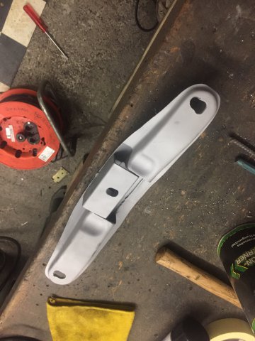

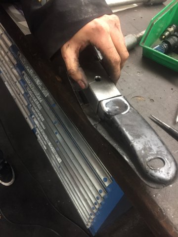

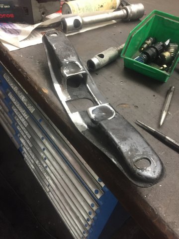

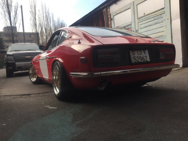

Finally I had some time to finish the diff swap.
As usual, the series one chassis forced me to adjust the RT mount, but at the end it worked out fine. The bumpstop is now located 2cm more to the right side, so the ebrake clears the upper bolt.
The final ratio is now perfect for my taste and I can enjoy the highway and the curvy roads as welll. The old 3.3 ratio was way too long combined with the s14 5-speed.
Maybe its useful for other people who had the same problem with the Rt mount on a series one.
Here are some pics:

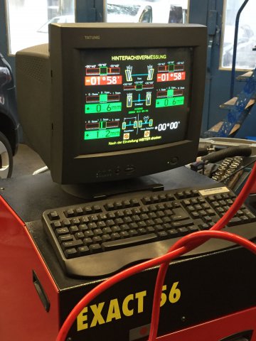

I had to swap all the T3 parts back to original, otherwise not legal. Next weekend I will install all T3 parts again.
The thing is, because of its good condition, I got the "Veteran" registration, which means the next vehicle test will be in 6 years.
Unfortunately I have a kilometer limit of 3000 km per year with the classic car registration, but a second speedometer solves the problem.
