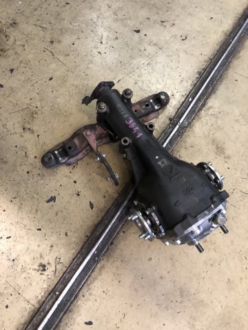

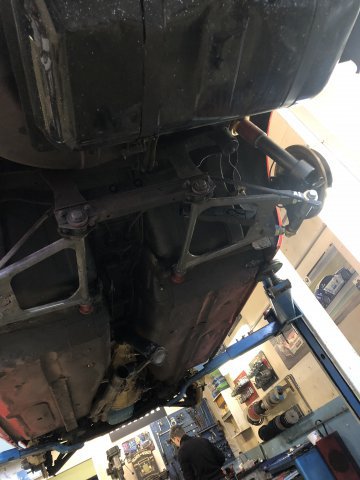

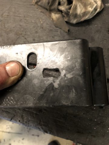

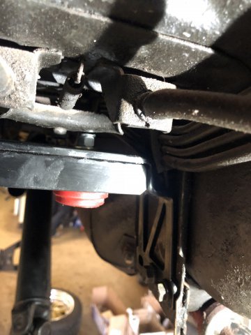

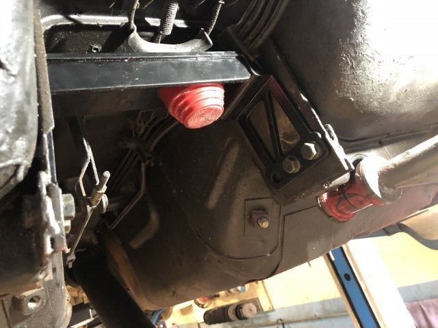

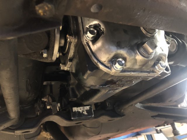

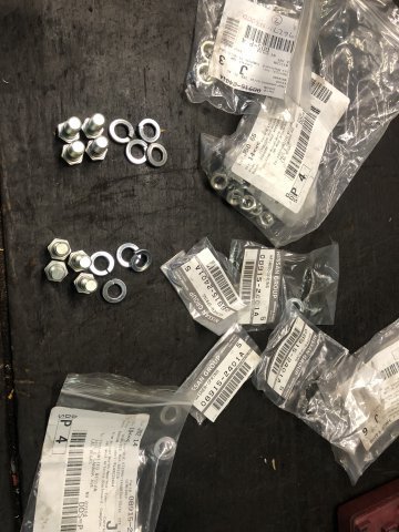

  4. Hello! Finally I had some time to finish the diff swap. As usual, the series one chassis forced me to adjust the RT mount, but at the end it worked out fine. The bumpstop is now located 2cm more to the right side, so the ebrake clears the upper bolt. The final ratio is now perfect for my taste and I can enjoy the highway and the curvy roads as welll. The old 3.3 ratio was way too long combined with the s14 5-speed. Maybe its useful for other people who had the same problem with the Rt mount on a series one. Here are some pics:
  5. Hello people Update time! I was able to organize some professional help to get my Z to the next level with a restauration and shaving of the engine bay. Further I wanted to remove the chrome stripes on each side for a cleaner look. Which was alot work, because filling up all these small holes without stressing the metall too much was not an easy task. The old paint overall was really bad and some rust underneath the paint was also found. And first layer of primer. I also sourced all the parts for a diff swap: 2005 WRX STI 3.9 diff RT Diff Mount for replacing the upper strap FutoFab conversion axles U-Joints for rear axles NOS 1970 diff mount insulator link for further interesting details: (https://www.classiczcars.com/forums/topic/52894-differential-front-mount-insulator-for-a-1970-s1-240z-nla/) Stay tuned for the next update, with fresh paint and hopefully a redone engine bay.
