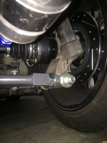

Well it finally all fits!  Car is back together and waiting for a performance alignment with new TTT LCA's.  It took DSS 4 attempts to get the stub axles machined to OEM spec but they finally got it done. Personally, I would use checkered flag racing if I did it again, but I will give Lee at DSS a lot of credit for contuniually working to find a fix.   Hopefully DSS will now have the proper specs for future buyers to avoid all the hassles I went through.  I owe the HBZ community an apology for using the forum to vent my frustrations..... I was never looking for technical "help", because the only fix had to come from DSS.  Just more of a buyer beware that was a little more colorful than intended.  Anyway, I appreciate all the input, and I hope others can avoid this expensive frustration in the future.   Jim
Ditto.  Sure this has been an unbelievably frustrating experience for you; but super glad to hear it finally worked out!!  I know I've learned a lot just from this thread.
