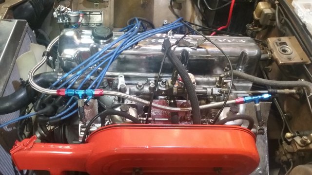

Dadddio Posted January 15, 2018 Share Posted January 15, 2018 I have committed myself to converting my SUs to the Patton Machine EFI. http://www.pattonmachine.com/TBI-Main.htm I am wondering if anyone that has done this could post some pictures of your install? Curious about where to mount everything. Thanks in advance. Quote Link to comment Share on other sites More sharing options...

Dadddio Posted February 8, 2018 Author Share Posted February 8, 2018 Larry. Installing a larger fuel line was the hardest part for me to this point. Swapped my 240 fuel tank for a '75 280. Getting ready install the kit next. Where did you mount the pressure regulator? How did you route your fuel lines? Thanks for the response Larry. - Chris M. Quote Link to comment Share on other sites More sharing options...
Larryz 260 Posted February 9, 2018 Share Posted February 9, 2018 I mounted the regulator on the fire wall near the heater hoses. I the fuel lines in the same place the factory did, I made new rubber insulators so the fuel lines would fit. I did my fuel lines out of -8 steel braided so I had to make an extra rubber block to hold the return line, I put it in between the factory ones and used a steel tie strap to hold it in place. Quote Link to comment Share on other sites More sharing options...
Dadddio Posted February 9, 2018 Author Share Posted February 9, 2018 I've got a '72 240z by the way. Hadn't thought of putting it there. I was going to put it on the PS fender. I'm planning on making some brackets for the 2 fuel lines and mount them in the stock location over to the carbs. May do braided, not sure yet. Think you could post a couple pictures? Thanks again. Quote Link to comment Share on other sites More sharing options...

Dadddio Posted September 10, 2018 Author Share Posted September 10, 2018 Sorry for the delay. Tony, it was your endorsement that convinced me to go this route....Thanks. It was not as easy as it seems, but if I could do it most people could. Turned out to be a very clean install in my opinion. Starts right up everytime. Idles high and drops just like it's supposed to. Only issue is after running a data log it seems I'm running lean. Checked everything, can't seem to locate any issues. Any ideas? Quote Link to comment Share on other sites More sharing options...
